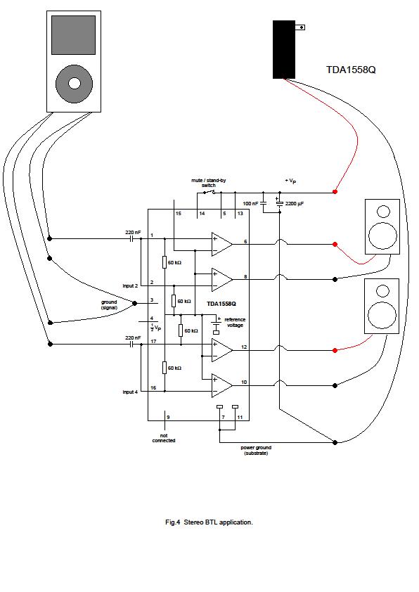

TDA1558 signal ground is simply connected to the others grounds,
only be cautious that the input cable shiled must be connected near the
signal ground pin, not near the point where all grounds are connected
together...

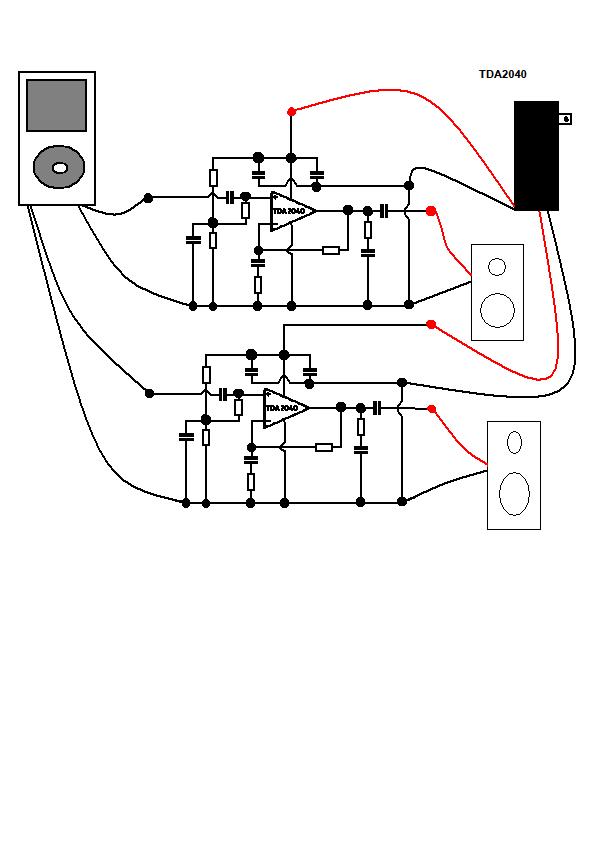

TDA2040 has the NEGATIVE supply to the case, so in the single supply
variant, it will be the ground...
anyway, keep the cases isolated if the heatspreaders are to be
in contact with a metallic casing....

in tda1558Q, the case is connected to the ground, anyway, so there s
no use to connect it to the star point, moreover, it s better to isolate it..
as already said, the case of the tda2004 isINTERNALLY connected to the
negative supply, not the ground..it happens that if the ic is used
with a single supply, the case will be ground connected, so
it s useless to connect this case to ground...
as i said, keep them isolated to prevent ground loops..

In TDA1558Q, I am confused. What am I doing with the ground coming from pins 14, 5,13? Also what am I connecting pins 7, 11 to? Are pins 7, 11 connecting to the neutral going back to the transformer?
In TDA2040, I think I am just as confused. Are all of the grounds going back to the negative of the transformer? Including the signal shielding? How do you isolate?
Thanks again, I am an idiot. Part of my problem is the fact I may use a non-metal case.
Not sure how I would do that, as wall wart transformers do not even have an earth connection. At which point, I would probably have to run another wire from an outlet to the case.
So without plastic type enclosure this isn't a concern?
using an outboard Wall wart type supply that complies with the double insulation standard and has the two concentric squares effectively means you do not have a mains risk in your amplifier. You do not need to and cannot use a Safety Earth.
However, connecting another piece of mains connected equipment with a mains to earth fault will/could transmit the fault down the connecting cable to this piece of equipment and maybe on to the speaker leads. Make sure that all your other equipment fully complies with the Safety Earth requirement.
Alright, I have done a horrible job of explaining myself. Perhaps if I draw what I am thinking somebody can correct my errors.
I think it's safe to say I am 100% lost on the TDA2040.
