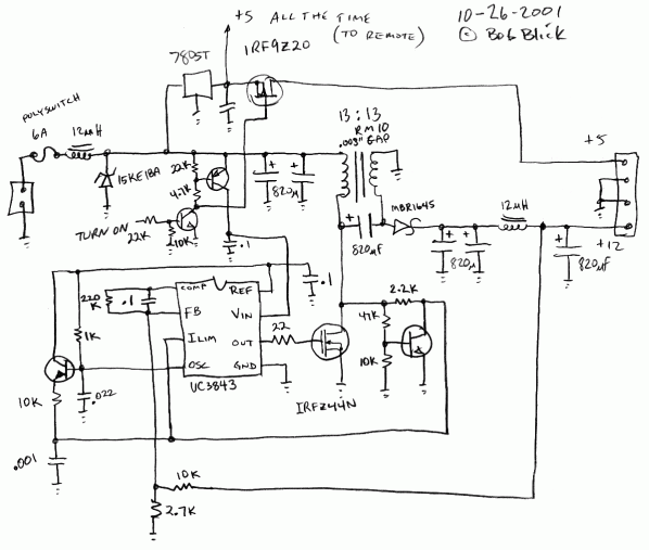

Pierre,
I ran across a neat schematic where the designer did indeed use the Rds(on) to measure the current drawn . This was for a DC-DC Converter for a Book PC in the car. I can't find it now, but I'm sure I posted here a while back. Do a "search" for BKi810 Book PC and see what you get.
Hope this helps,
Steve

Re: Re: 12V DC/DC for amplifier. Current limiting?
Here's the schemo I mentioned............
Hello, N-Channel.
It is original: when the mosfet is OFF, you use the drain voltage to activate the transistor, that blanks out the measurement signal, and when it is ON, the drain voltage is Vds(on), that is equal to Rds(on)*Id, so you have a measurement of Id.
This principle is commonly called "Rds(on)-based sensing of drain current".
The problem is that Rds(on) is STRONGLY dependent on temperature (it can double from 25ºC to 80ºC in the junction).
It is good for some uses but not when you need a somewhat precise current limit threshold.
BTW: I have seen and used other variations of the same principle using only diodes: you can also blank the signal with a diode (cathode) connected to the mosfet gate, so when you have the mosfet OFF, your Vgs is nearly 0V, thus making a diode conduct and throw the measurement signal to 0.6V+GND. Its response is likely to be faster than using a transistor as it acts even before the mosfet has been turn fully off.
Sergio

Yeah, the temp-dependent Rds(on) thing can be a pain. I guess that some sort of temp compensation network would be nice, but then we start getting more complex just to save a few watts. Perhaps a way to stabilize the MOSFET's temp would be nice.......

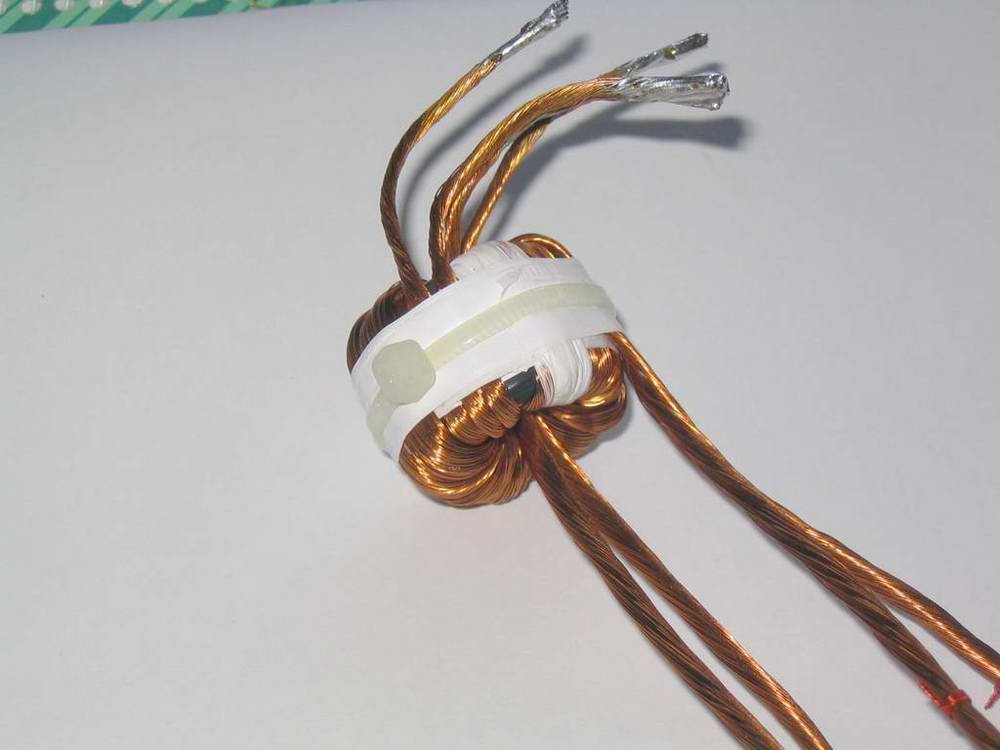

Nowadays i'm on the same mission 🙂 but mine will make 12V to +-40V.
Last weekend i only managed to finish with the winding of the toroidal core for this project...
Here is an attached pic of it, i dunno why but i'm calling it the little piggy 😀
