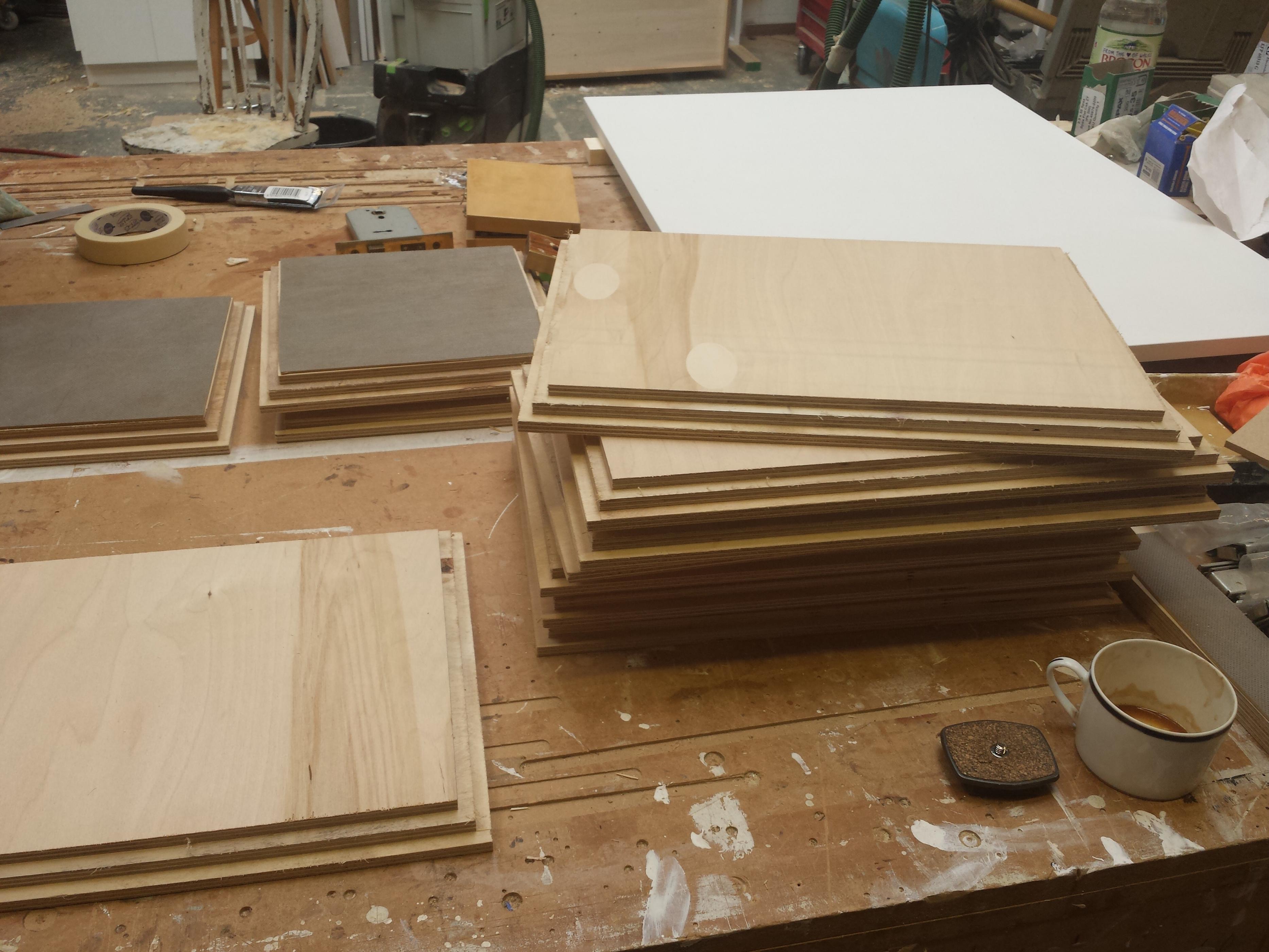

Double Rebated panels
I used two 8mm rebates on the panels to increase the effective glueing area, that is given the rounding required for the design I would have lost too much of the join if I had used butt joints or mitres. It was a bit tricky because it meant spending a lot of time setting up two old spindle moulders to a level of accuracy never attempted before. Not good in a shared workshop where there are only two spindle moulders.
The boxes then fit together like a kind of a puzzle but they did end up with the correct internal area and the rebates fitted together without any gaps.
Now that's my kind of workbench, including the Dlugos sized espresso(?) mug

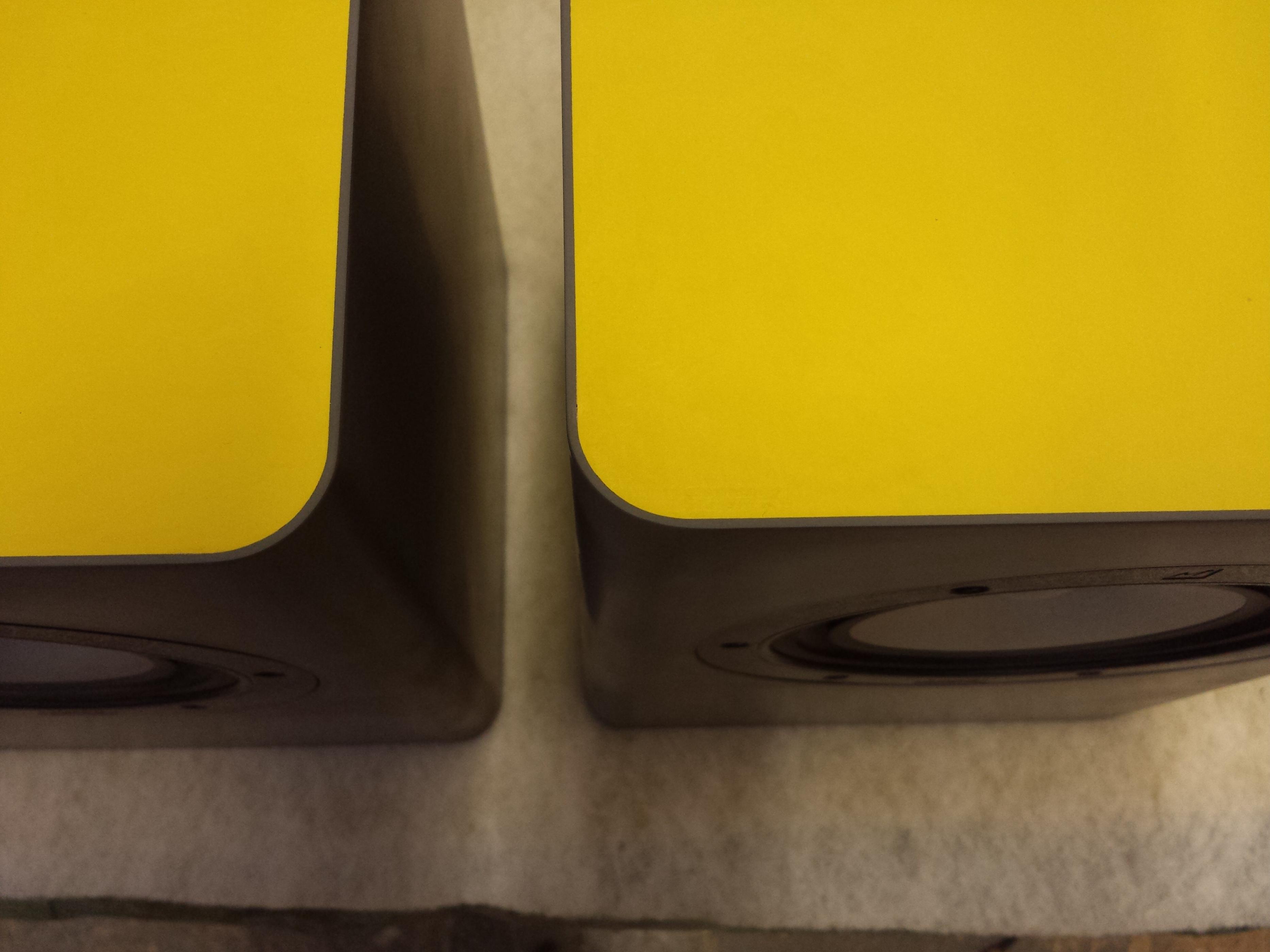

What I mean by the above vague statement is that we have spent a long time trying to get these right and there have been quite a few hiccups on the way. The plan was always to make the best physical box we could (within reason). We have made enclosures in the past that despite having a good design (on paper), ended up sounded disappointing, and the reason was that that we simply didn't spend the time to get the basics right when making them. Much of the (long..) time spent on these boxes was on how to get the making right.

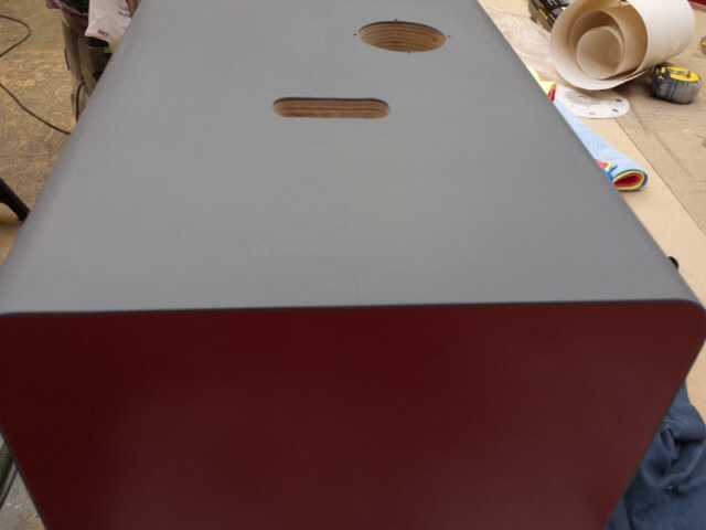

For example there is a seamless join on each box where each rubber meets itself after it has been wrapped around the enclosure, but getting this one detail right was almost enough to make us give up on the entire project. The join is placed between the ports at the back and is now only visible after some close inspection (as it should be), but getting it like this was a trial and error and back to the drawing board nightmare...

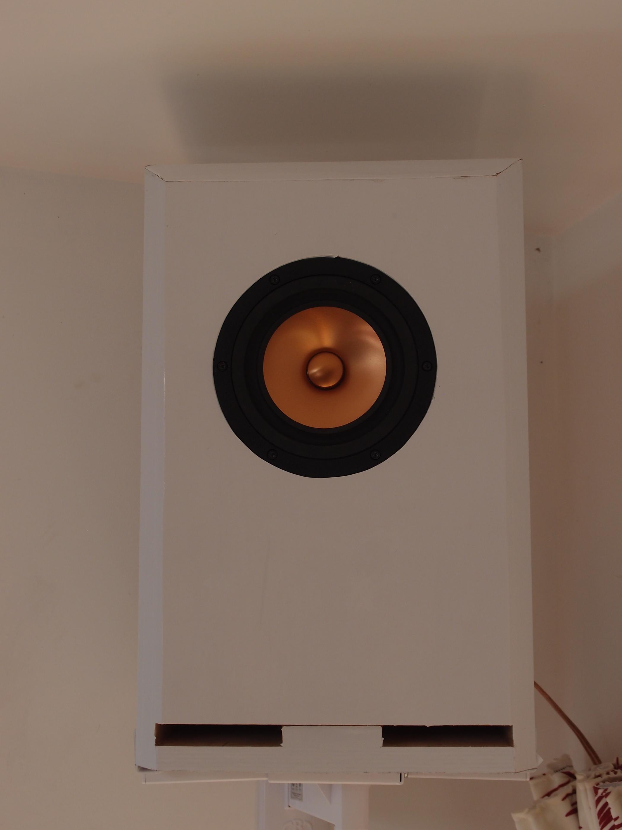

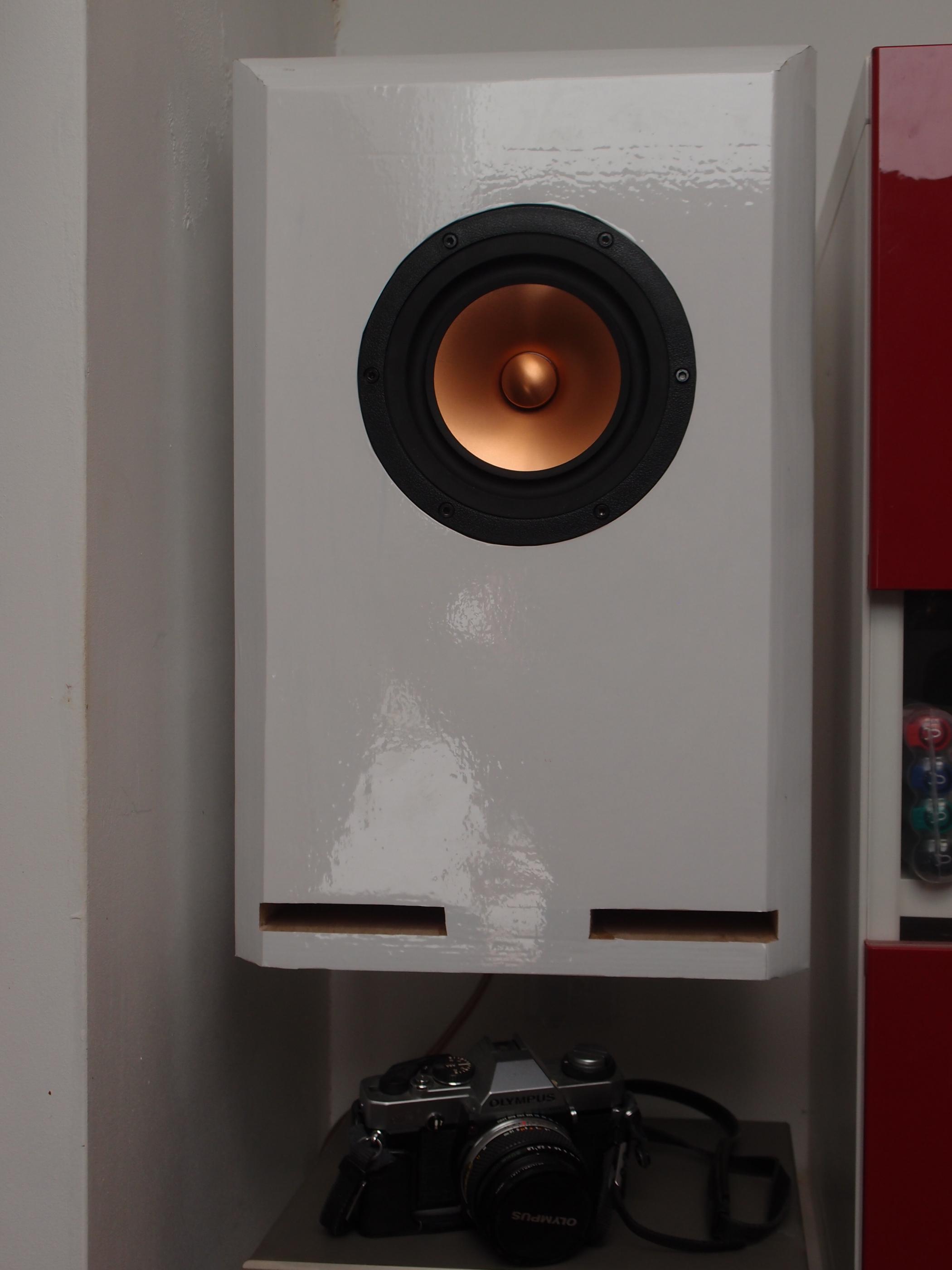

I love the look of these speakers - that rubber material especially. I've just finished a pair of Alpair 10.3's in one of the CGR ported boxes. I wanted a non-wood appearance and eventually decided on using a gloss white car vinyl 'wrap'. However, the covering is actually very thin (I'm surprised its durable enough for a car wrap), the wood grain shows through and my finishing is very average. End result - they look pretty bad.
Therefore I'm looking at other options and that rubber looks great (particularly the matt look) - can you reveal a little more about it, where you got it etc?
