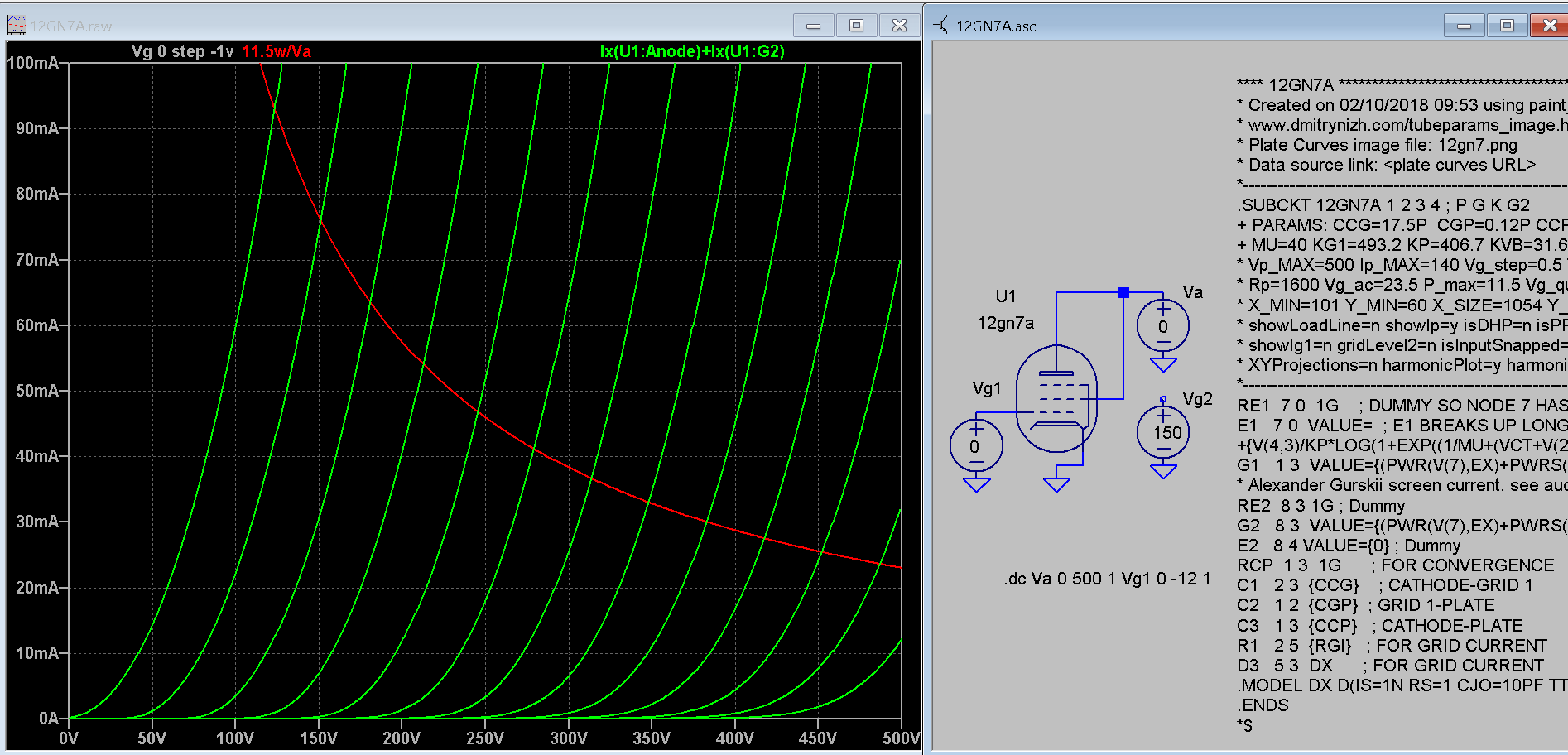

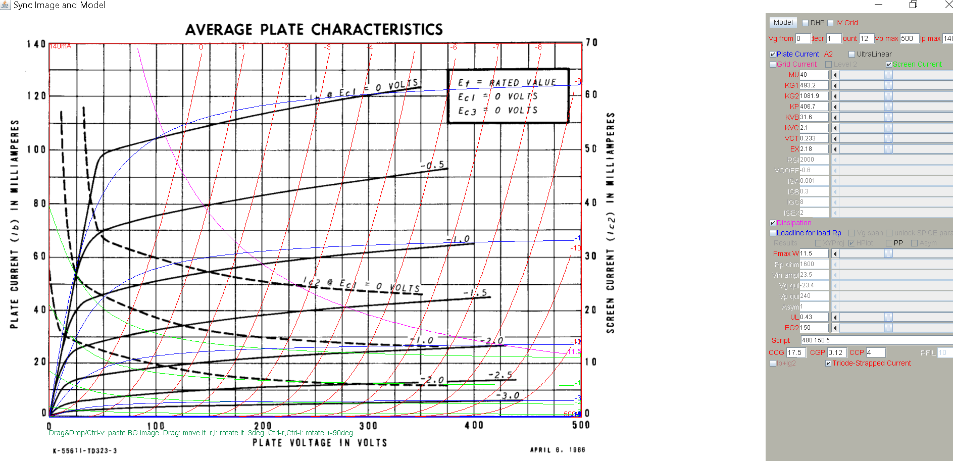

I just created this model using Paint tool. Please advise if any good so I can post to Spice model thread.
**** 12GN7A ******************************************
* Created on 02/10/2018 09:53 using paint_kip.jar
* Model Paint Tools: Trace Tube Parameters over Plate Curves, Interactively
* Plate Curves image file: 12gn7.png
* Data source link: <plate curves URL>
.SUBCKT 12GN7A 1 2 3 4 ; P G K G2
+ PARAMS: CCG=17.5P CGP=0.12P CCP=4P RGI=2000
+ MU=40 KG1=493.2 KP=406.7 KVB=31.6 KVC=2.1 VCT=0.233 EX=2.18 KG2=1081.9
* Vp_MAX=500 Ip_MAX=140 Vg_step=0.5 Vg_start=0 Vg_count=7
* Rp=1600 Vg_ac=23.5 P_max=11.5 Vg_qui=-23.4 Vp_qui=240 UL=0.43 EG2=150
* X_MIN=101 Y_MIN=60 X_SIZE=1054 Y_SIZE=740 FSZ_X=1942 FSZ_Y=1102 XYGrid=false
* showLoadLine=n showIp=y isDHP=n isPP=n isAsymPP=n isUL=n showDissipLimit=y
* showIg1=n gridLevel2=n isInputSnapped=n
* XYProjections=n harmonicPlot=y harmonics=y
RE1 7 0 1G ; DUMMY SO NODE 7 HAS 2 CONNECTIONS
E1 7 0 VALUE= ; E1 BREAKS UP LONG EQUATION FOR G1.
+{V(4,3)/KP*LOG(1+EXP((1/MU+(VCT+V(2,3))/V(4,3))*KP))}
G1 1 3 VALUE={(PWR(V(7),EX)+PWRS(V(7),EX))/KG1*ATAN(V(1,3)/KVB)}
* Alexander Gurskii screen current, see audioXpress 2/2011
RE2 8 3 1G ; Dummy
G2 8 3 VALUE={(PWR(V(7),EX)+PWRS(V(7),EX))/KG2*(KVC-ATAN(V(1,3)/KVB))}
E2 8 4 VALUE={0} ; Dummy
RCP 1 3 1G ; FOR CONVERGENCE
C1 2 3 {CCG} ; CATHODE-GRID 1
C2 1 2 {CGP} ; GRID 1-PLATE
C3 1 3 {CCP} ; CATHODE-PLATE
R1 2 5 {RGI} ; FOR GRID CURRENT
D3 5 3 DX ; FOR GRID CURRENT
.MODEL DX D(IS=1N RS=1 CJO=10PF TT=1N)
.ENDS
