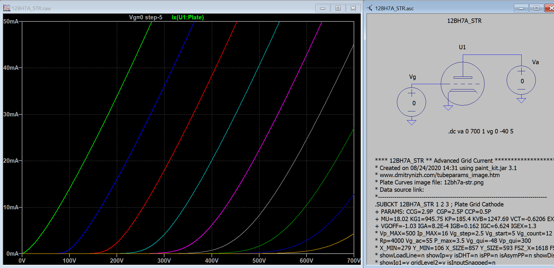

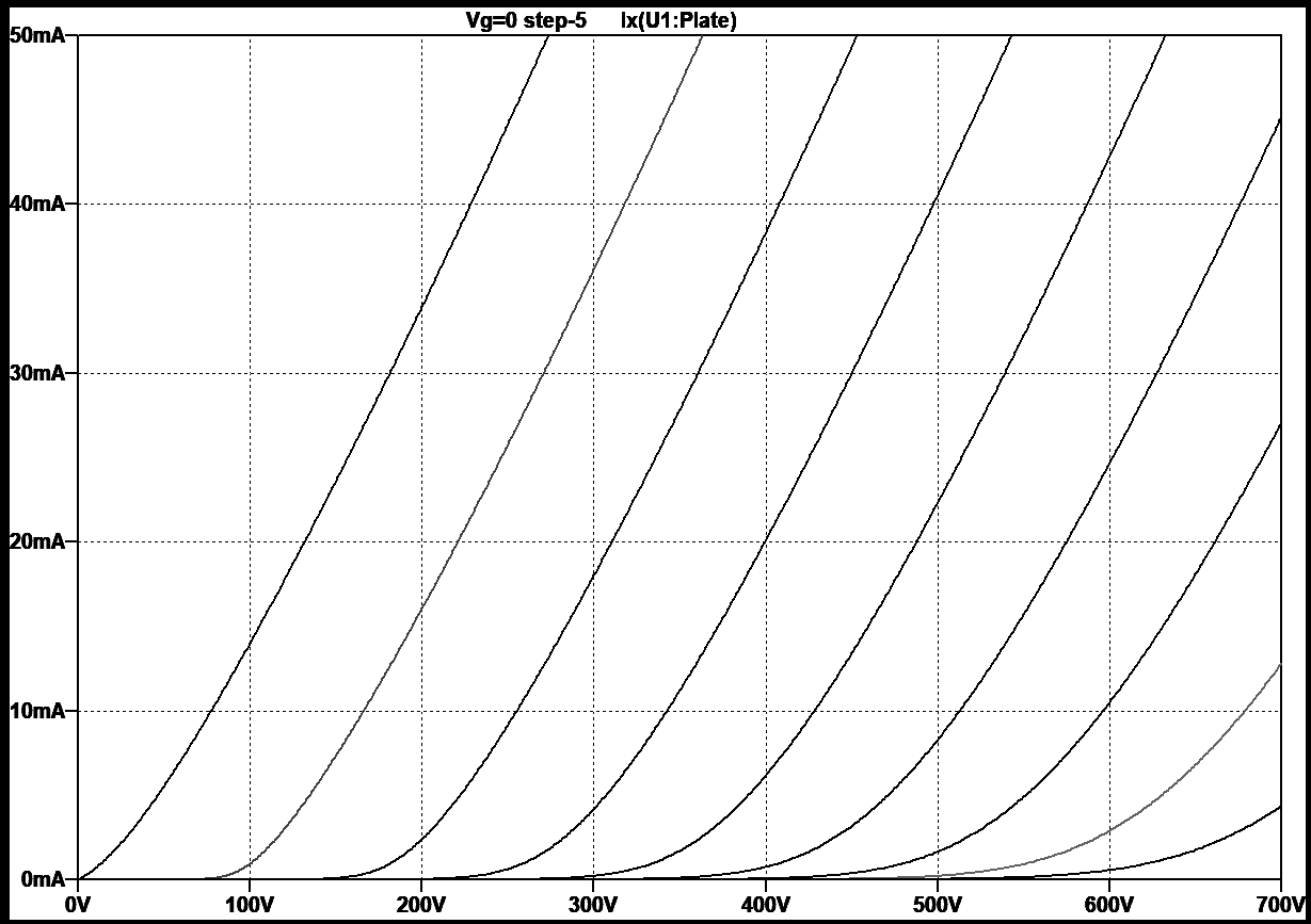

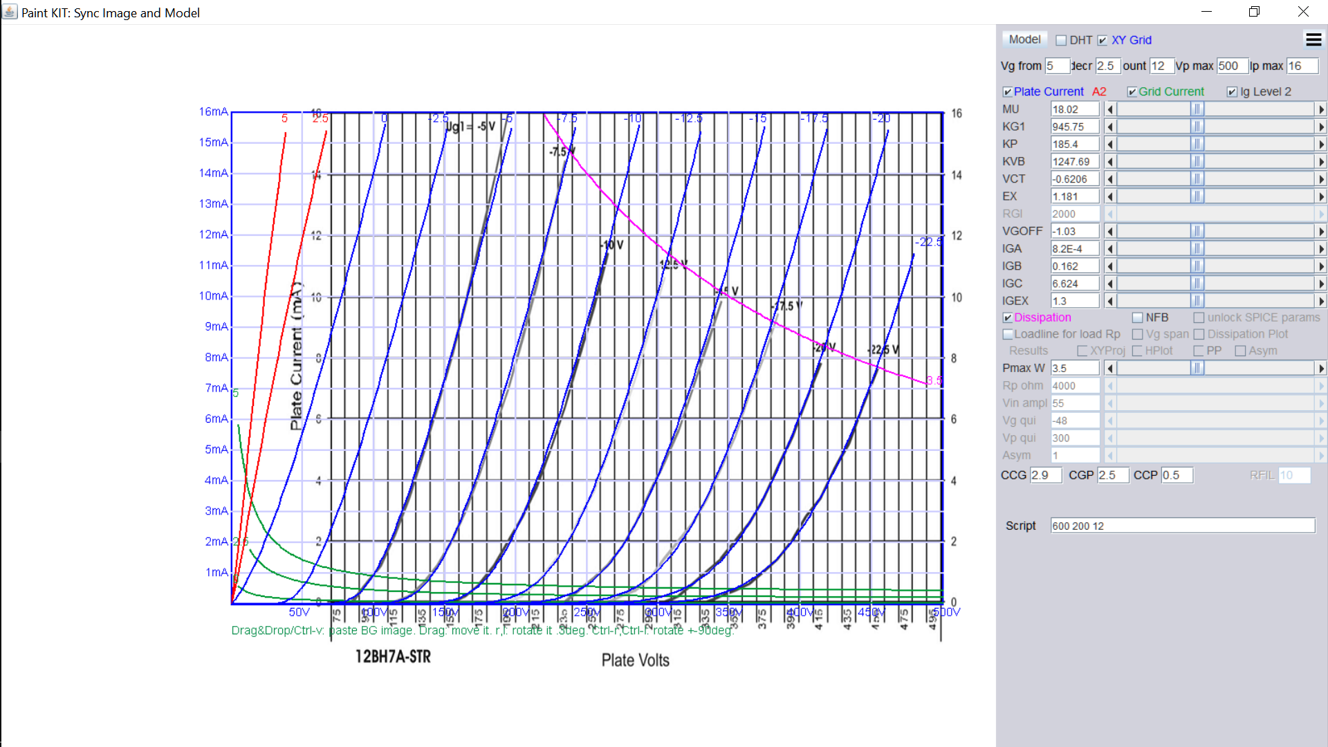

Here is model for TAD 12bh7a-str, and comparison with GE.
Code:

* Created on 08/24/2020 14:31 using paint_kit.jar 3.1
* [URL="http://www.dmitrynizh.com/tubeparams_image.htm"]www.dmitrynizh.com/tubeparams_image.htm[/URL]
* Plate Curves image file: 12bh7a-str.png
* Data source link:

E1 7 0 VALUE={V(1,3)/KP*LOG(1+EXP(KP*(1/MU+(VCT+V(2,3))/SQRT(KVB+V(1,3)*V(1,3)))))}
RE1 7 0 1G  ; TO AVOID FLOATING NODES
G1 1 3 VALUE={(PWR(V(7),EX)+PWRS(V(7),EX))/KG1}
RCP 1 3 1G   ; TO AVOID FLOATING NODES
C1 2 3 {CCG} ; CATHODE-GRID
C2 2 1 {CGP} ; GRID=PLATE
C3 1 3 {CCP} ; CATHODE-PLATE
RE2 2 0 1G
EGC 8 0 VALUE={V(2,3)-VGOFF} ; POSITIVE GRID THRESHOLD
GG 2 3 VALUE={(IGA+IGB/(IGC+V(1,3)))*(MU/KG1)*(PWR(V(8),IGEX)+PWRS(V(8),IGEX))}
.ENDS

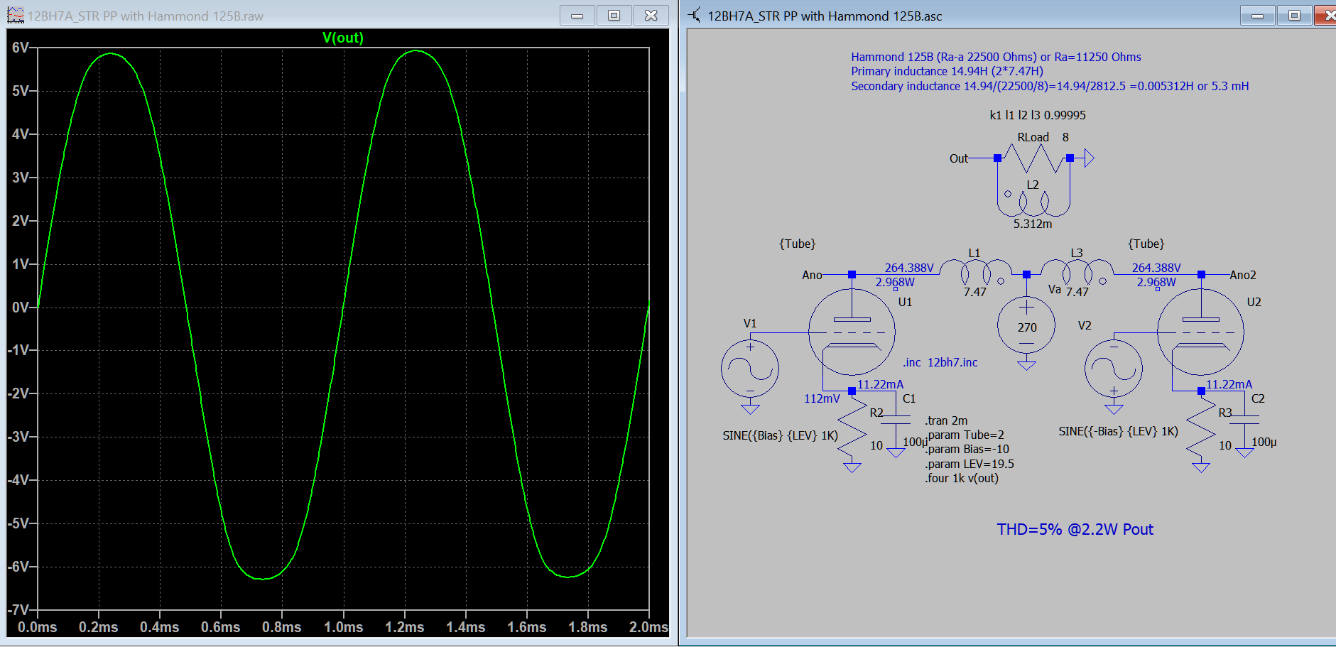

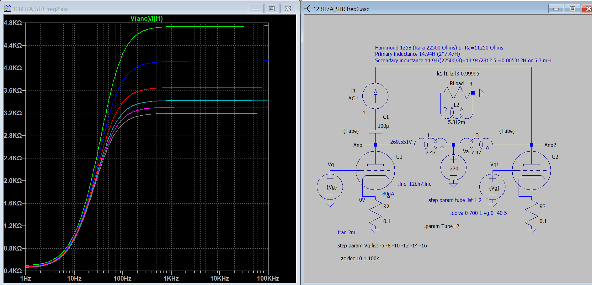

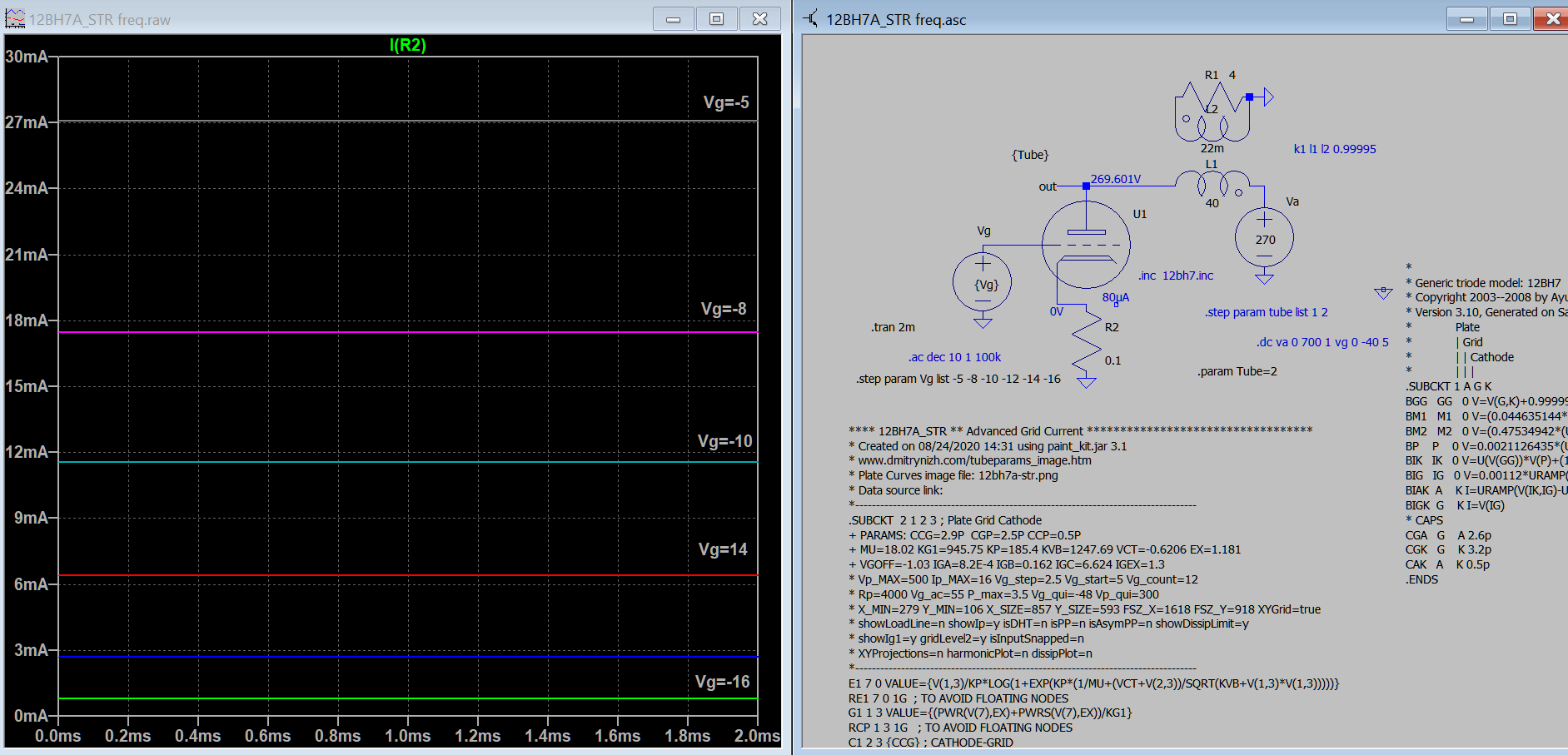

Attached is the output impedance for 12bh7a-str and various quiescent point with HT 270V. I noticed that Z is higher when compared to another model. But you can use these operating points as guide and go follow the steps in トランス結合 12BH7A パラ PP アンプ (3) : まほろば 写真俳句 as it has PP model to design your own loadline to suit your OT.
I wish I could read chinese.. I have no idea what the site is about I just see a couple interesting looking graphs.
You can Google to translate foreign language. Anyhow hope you can read other article to boost your knowledge which is advantage to yourself. You can just wire up a PP amp even you don't fully understand how it works. I have put together a circuit using Hammond 125B OT, it has 22500 Ohms anode to anode resistance (Ra-a=22500) when the secondary load is 8 Ohms. The 2 tubes in PP bias at -10V (which is lower Z than 22500), the output is shown as attached. For maximum power output the combined tube output Z should be at least equal to Ra-a/4 for Class B amp or Ra for Class A of the OT (loadline), Read: Plate load for push-pull
