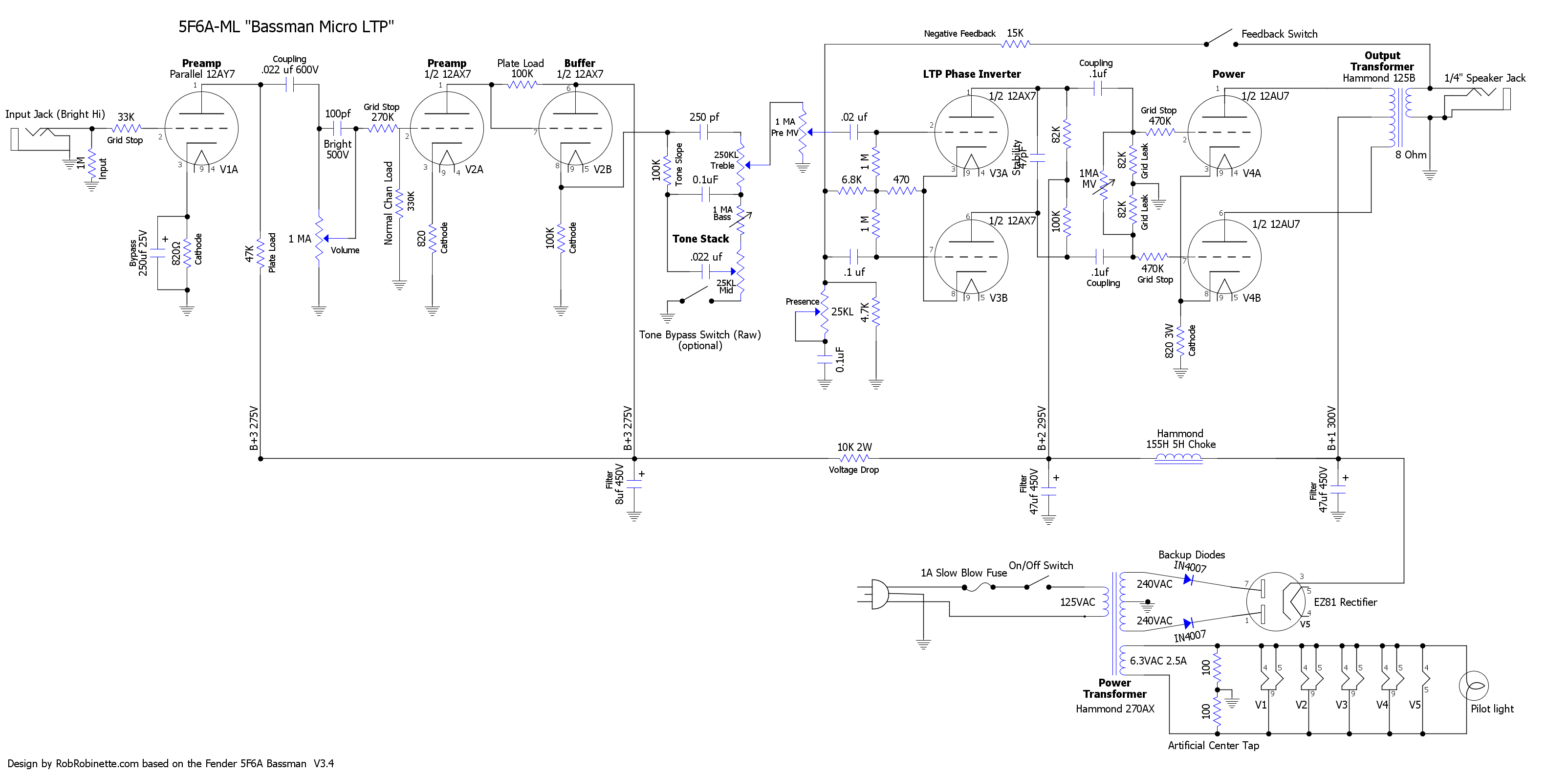

So I am trying to buil a obviously low power power amplifier with the 12BH7 as the output tube.
I cant seem to find much info on the internet on what the operating parameters should be for a single tube class AB or A1 power output configuration.
I dont see much info about what kind of plate load would be ideal and what kind of plate voltage would be idea to get the most of it while not too terribly damagin the tube. (And I have acess to custom wind stuff at home so a really speacial load impedance is not gonna cause any trouble).
I would like to use this in all kinds of things. Headphone amplifiers, laughable HIFI amps (you know in size and power), and a small guitar amp for my classmate and maybe a headphone ampliffier experiment aswell (maybe do a class A1 headphone amp, would be awesome). Designing a output stage isnt really a problem but I just cannot find the ideal plate load number or maybe I just wasnt looking hard enough. regardless if someone could help me out with this I would be thankfull 🙂
EDIT: Apparently I found my answer: 15-12.8Kohm impedance for that anode load (thats CT for AB) with a plate voltage of 250-260V (thats for the ECC99 so close enough id say).
EDIT2: And I also found a quite fragile output transformer from a battery radio that measures 10-11k impedance. I think I found the perfect match for a guitar amp..it even has the original enclosure and the original paper speaker in tack...great way to ressurect a otheriwse completely useless piece of trash into something nice

Why those extremely high grid stop resistors? Is that a typing error? Normally they are around 1k, here they are 1000 times higher. It should be very bad for treble reproduction due to miller cap getting into play.

"The grid resistor on the preamp stages typically ranges from 0 to 68K, although very large values, such as 470K, are sometimes used in high-gain preamps to shape the frequency response and prevent "blocking" distortion in the preamp section under heavy overdrive conditions. The Miller capacitance of a typical 12AX7 is around 151pF, so the upper frequency response -3dB cutoff point of a stage using a 68K grid resistor is around 15.5kHz. The frequency response drops to around 2.2kHz if a 470k grid resistor is used. This "free" response rolloff can be used to tame the "buzziness" of high-gain preamp stages without having to add additional rolloff capacitors. Perhaps the most important grid resistor is the one that goes to the grid of the very first stage, right after the input jack. This resistor is the one that prevents oscillations and pickup of radio stations and other noise due to long or poorly-shielded cables. It is not usually a good idea to eliminate this resistor. Ideally, it should be soldered directly to the grid pins of the socket, with very short leads."

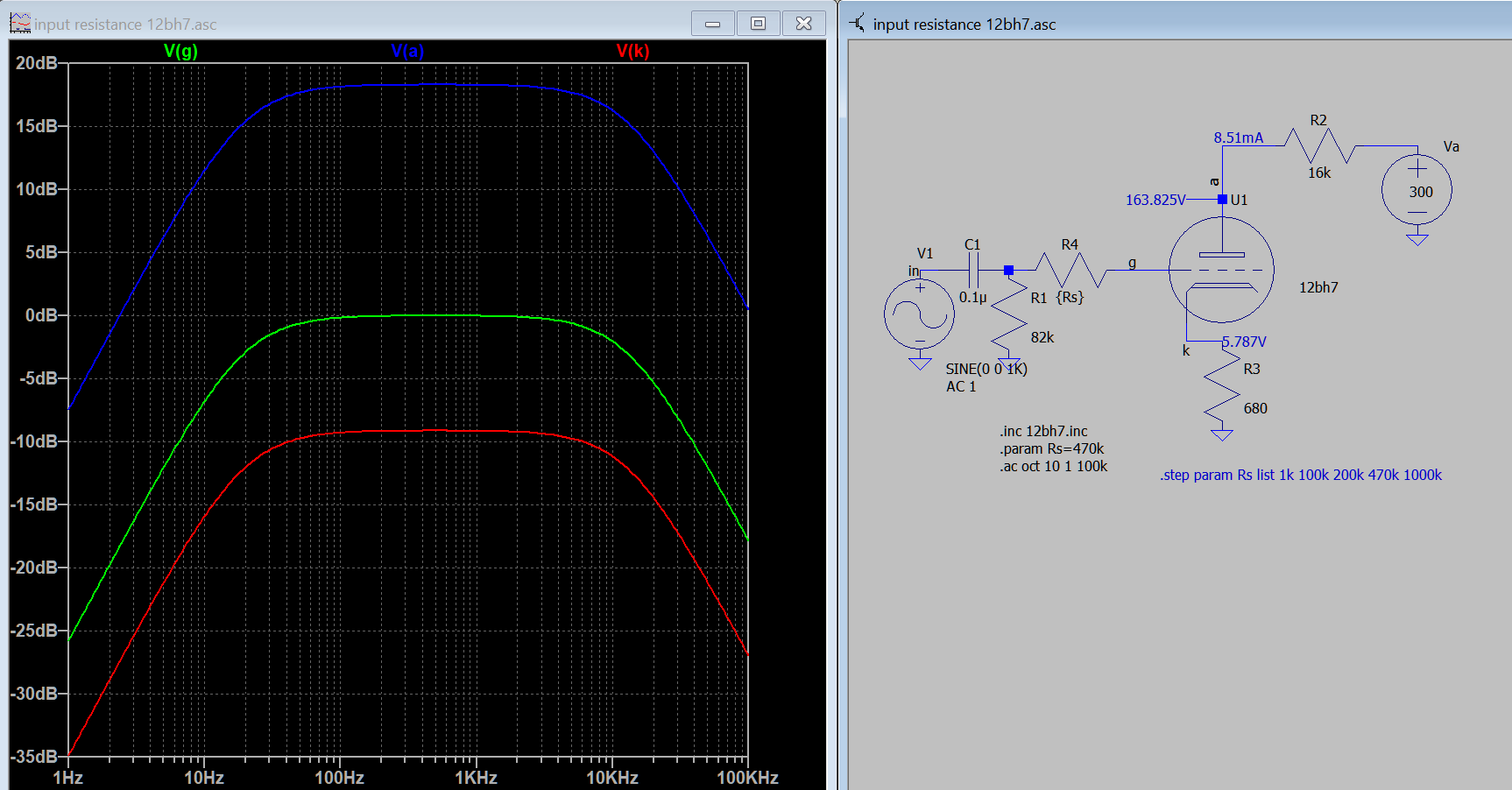

Of course $60 for a pair of 3.5 watt power dual triodes is not cheap, but you are free to spend your money anyway you like. The problem is that without markings on them it is not clear what the tubes actually are that you believe are “Shuguang 12BH7”. If they are true 12BH7 I would expect Shuguang to print that on the tubes. Perhaps you could post some photos of the tubes and links to places where these “Shuguang 12BH7” tubes could be bought.
So, without confirmation of what tubes you actually have, it will probably not be helpful to receive information from the forum that presumes a true 12BH7. I would suggest that you measure and draw your own performance curves to be sure.
