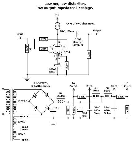

Do you have a schematic I have a bunch of 12B4A tubes looking for a project.
A slew of 12B4 designs can be found in the archives. I'm providing something I worked up to use what was on somebody's "pile". You definitely don't have to use the pseudo choke I/P filter PSU setup shown. Well filtered or, perhaps, regulated "juice" at roughly 150 V. for the B+ will certainly do. Also, something less pricey as the O/P coupling cap. is OK. The fellow I worked that design up for has a "thing" for "boutique" parts.

Hi, can you tell the details of the current source?
That depends on how difficult the downstream load is. If it's a tubed power amp whose I/P impedance is >= 100 Kohms, a simple 10M45S is plenty good. OTOH, if driving the IHF "standard" of 10 Kohms is contemplated, some setup with cascoded FETs or BJTs is in order. Also, it may be necessary to capacitor bypass all or at least part of the cathode bias resistance.
