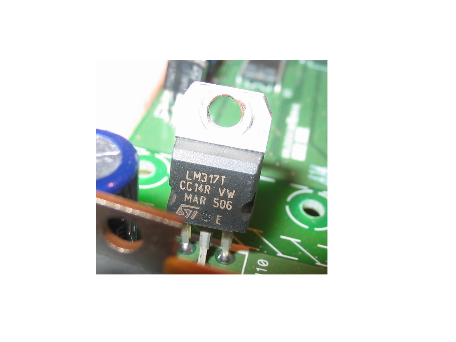

I have...A dedicated 220 primary 12vAC RMS? dual bobbin TX for the 12AU7 running thu a 317 @6.3VDC...a healthy heatsink.

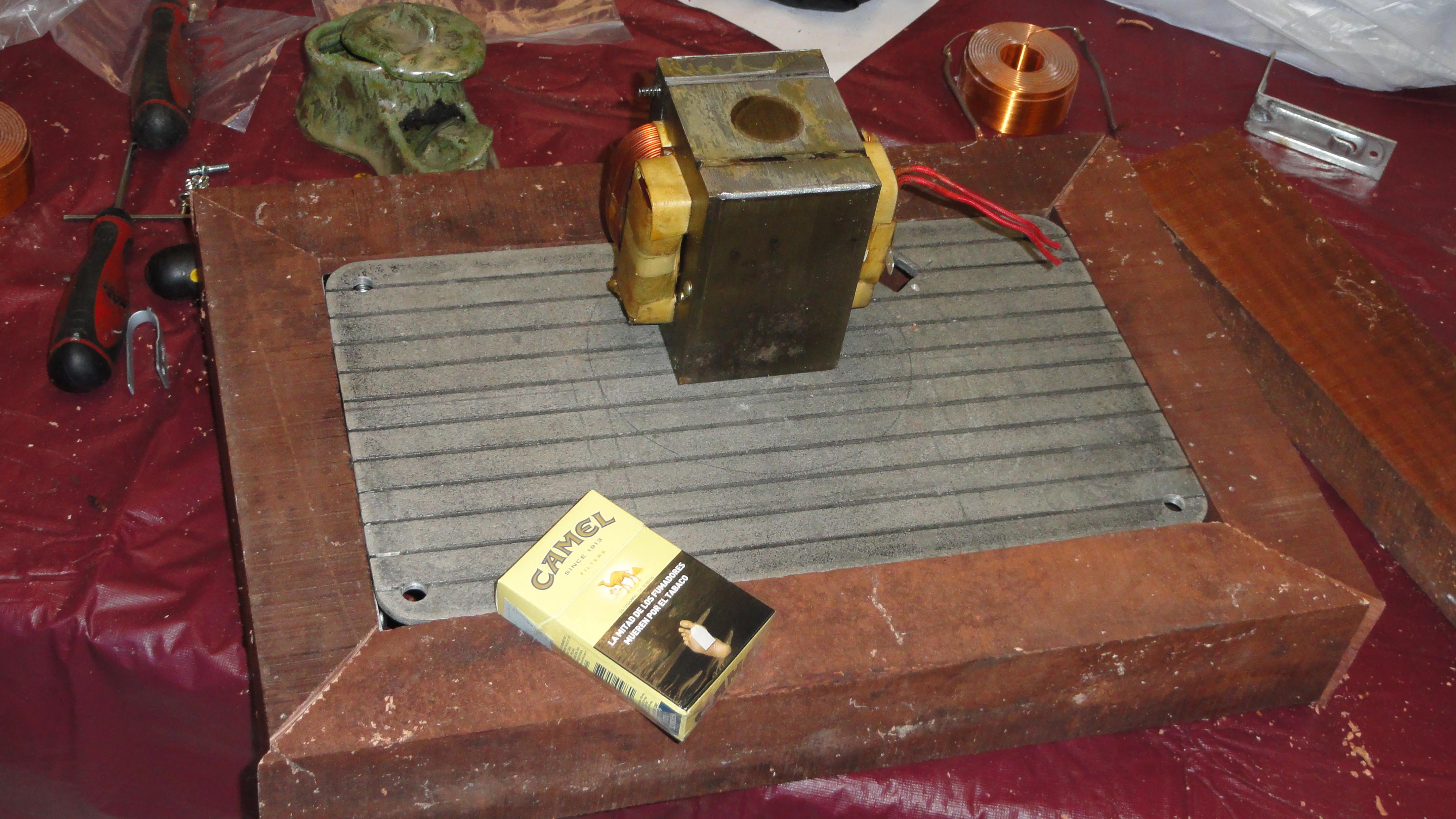

Progress report
Her it is so far, in the picture we see an MOT I'm working with, The wood is cut chassis is coming together. The mains transformer is positioned where it is to be, flanked by a pair of 5U4GBs for full-wave rectification. The quad of 12B4s in a straight line with the 12Au7 in the middle....all five, straight line up front, gotta use your imagination here.
_____________________________________________________Rick.........
