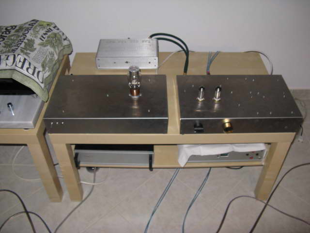

Just finished my 12b4 pre and like the sound a lot. Quite pleased for a first tube project!
Built in two chassis, one with all power supplies and the other with Sala' s simper simplistic reg, heaters regulators and the tube circuit.
Very silent only slightly microphonic. Maybe try more with tube decoupling from chassis would help.
I used a 6.8K resistor for begining. Cathode 1.2k bypassed with a 1000 uF.
325V to simplistic shunt 280V B+, around 165V on the anode and I have 19V on the cathode resistor.
I am going to experiment with your final shematic of the gyrator, as soon as I get some more 9610. I burned one during the testing phase and I don' t have any more right now.
Maybe you will like the resistor more after all, has its merit too. When you check with the gyrator, make sure to keep levels the same for comparing, its gonna up the gain. In what system did you listen to it by now? Any comparison preamps around?
My system now is horn loaded - based on Lynn Olson ideas - around 105db sensitivity with my F5 clone, that I just set up and try to configure crossovers etc, so I can not be sure. Your phono also. What I know is that music is much more alive and real maybe than with a passive pot previously used. Even if gain was enough before, F5 needs an active pre for sure.
This 12B4 with the simplistic Reg will be hard to beat in the future. One of the best things you could add to drive the F5. See for best mechanical decoupling of your 12B4s since you got ''real'' speakers, and you are mainly set.
I am thinking for a suspened suchassis for the tubes. Also add some dumping to the case. It' s a Hammond aluminium one. As this was was the first thing I build with tubes I wanted to have some sound first and then deal with details as my confidence builds up.
