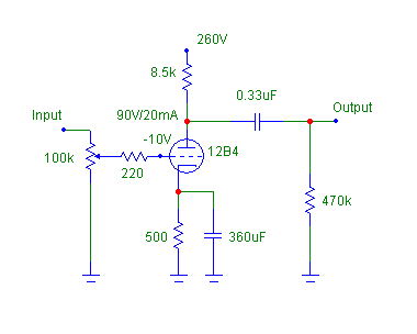

12B4A diy preamp
I built this one for a couple years ago. Very dynamic and varm sound, some microphonic, sometimes. Loves the simplicity.
This is what I use. 4 channels of 12b4 as shown and 2 channels with a quality opamp driver to subwoofer. First two channels are amorphous, 3 and 4 are non-amorphous. That way I can play around with which one sounds best on the woofer vs tweeter.
No microphonics or noise of any kind, super quiet.
The 50k terminals are where a stepped attenuator goes for volume control.

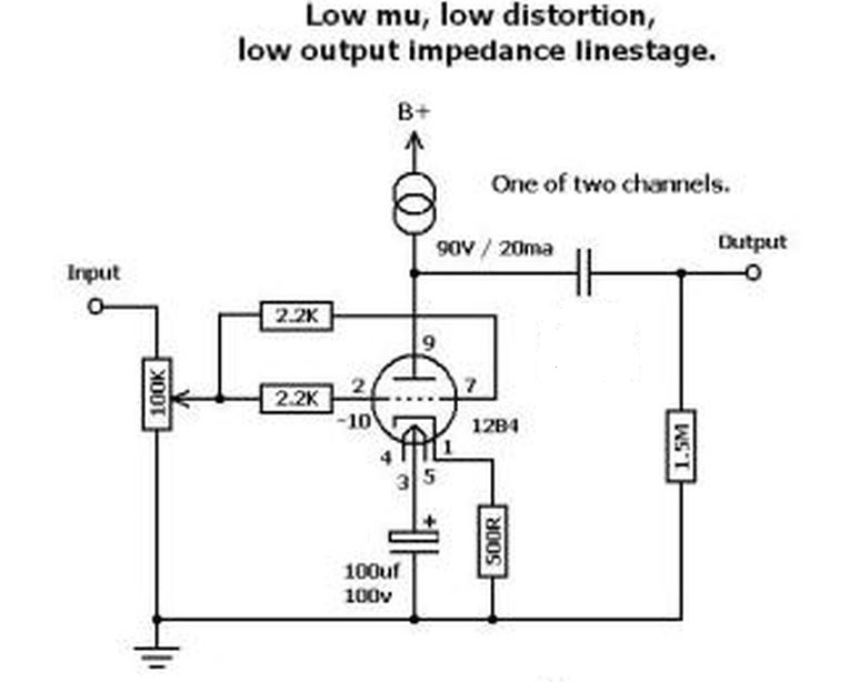

My version (FWIW) of a 12B4 line stage is very similar to stenak's. I use CCS, not resistive, loading to accommodate the awkward 10 Kohm IHF "standard" load. The heater CT gets biased off B+ for noise control and that voltage divider is not shown.
CCS loading is good for PSRR. So, simply bridge rectifying the O/P of a Triad N-68X isolation transformer and CLC (Π section) filtering rates to be quite adequate.
