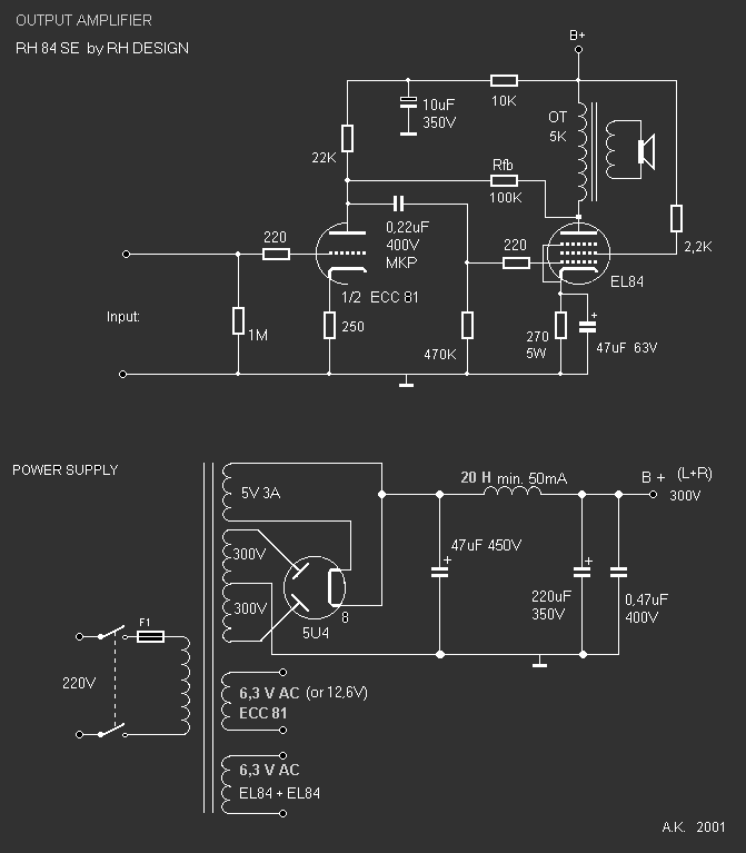

I'm getting closer to getting my amps working. (12B4 pre and an RH84 built into Akai M8 chassis). I've got them quiet enough that I can now hear low level motorboating (sounds like a heartbeat) from the 12B4 stage with the output cap I originally intended to use (5uf) when driving just the RH84 (30K load). When I use a 1.5uf cap it seems fine. When I step up to 2uf, I can hear some pulsating. I want the pre to be stable driving either just the RH84 or driving it and another 20K or so in parallel. When I try a 12K load, it is fine with the 2uf. I haven't tried 5uf into 12K.
So, is the worst case corner frequency of 9hz (1.5uf into 12K) low enough? I ultimately plan to insert a sub that will have significant output down to 19hz or so. Do I make the output cap switchable (once value for driving just the 30K load, another value for when I'm also driving something with the pre out). Or, do I have another problem to address? (Each 12B4 has it's own 33uf cap isolated from the rest of the rail by a diode and a 2K resistor).

so 2uf in 30k motors....and 2uf in 12k does not....so this tells something.
time constant for non resonant behavior??? If you ask me 9hz is fine (1.5uf into 12k, and fine at 30k...) .....So how does it sound...does it have enough grunt in the low end?
OK motorboating can also be an output to input thing...so look also at grid resistance i.e. maybe 250k, instead of 100k...
and possibly the 33uf is too big....sorry of course or too small....try a 20uf, and a 50 uf. electrolytics which are cheap just to find out....

you need better isolation for 12B4 stage
assuming that Iq is in range of 15mA , that's certainly critical ; besides that - 2K33uF combo have corner frequency somewhat too high for my liking
solution - more uFs for decoupling ........ or reg .

PJ,
You have a "check valve" decoupling network in place, now. IIRC, you are resistively loading the 12B4. Switch to 10M45S CCS loading to improve PSRR and linearity. Eliminate a 12B4 cathode resistor bypass cap, should 1 be present. ZM is correct about reducing section to section interaction. Along with regulation and increased decoupling capacitance, CCS loading provides the necessary isolation.
The high pass pole between preamp and power amp sections should exhibit a F3 <= 5 Hz.

Boy, I thought 33uf (per side, mind you) would be overkill. How big should I go? My B+ ended up higher than PSUD guessed (which is good for the RH84). I wasn't initially anticipating needing a 2k resistor (assumed more like 1K). I'm not using a cathode bypass now. I figure I'll have more gain than I need no matter what. I wanted to give resistor loading a shot, but it sounds as if I'll be ordering caps anyway, so I may as well get the chip.

Pad the preamp I/P down, to dispose of excess gain.
If you CCS load the 12B4, roughly 30 V. are needed by the 10M45S. You can increase the decoupling filter resistor and eschew increasing the decoupling cap. value. 33 μF. should hold enough energy.

In the past, you haven't been a fan of the 10M45S with the 12B4. It'd cost a couple of bucks more, but is something like the EC CCS a better option? I think I could get cascaded fets in there.

In my 12B4 line stage, which can drive the fugly 10 KOhm IHF "standard" load, I want a high quality CCS as the load to approach infinity as its dynamic impedance. IIRC, you are asking the 12B4 to drive something much less challenging. A mediocre CCS should be good enough here.
The load will be in the neighborhood of 12 KOhm: the 30K RH84 (pot on hand) in parallel with the 20K digital signal processor driving the woofers and subs. That tough load is why I'm building the pre and not just the RH84 circuit. I built a chip buffer for the DSP (and left it at 20K), otherwise the combined load would be around 5 KOhm (due to the 6.2K load of the DSP on its own)!

Paul, i'm not going to be able to help with the 12B4 side, but why is the in to the RH84 only 30k? I have a feeling the ECC81 wants to see a bigger grid leak. Eli?

30k should be fine as a grid leak. Tubes have a problem when those are too big- small is OK. It might be kinder to the preamp to raise the power amp input resistor to 100k, but that's relevant to distortion, not LF stability.
If you have motorboating, it's a power supply coupling issue. More microfarads might help, but what you really need is more isolation- do I take it that the pre and power amps share a supply? If so, you need to either add an RC section to the preamp feed to decouple it better or (better yet) regulate the preamp supply. A few k and a few tens of uF should be sufficient.
If you have an unbypassed cathode resistor in the preamp, the source impedance will get much higher than planned. Bypass it or (better yet) use LED bias.

Well, the CCS seems to be working. The heartbeat sound was still there, so I added another RC section to the power supply. And, the heartbeat sound is still there. So, to recap, I attached the RH84 schematic. My PS is SS rectified, 22uf, 6H, 330uf to the B+. From the B+, I have attached for the 12B4 PS: 1K, 22uf, a UF4007, 5k, 33uf, then the CCS to the plate of the 12B4. The only thing that has worked thus far is using a smaller output cap, 1.5uf instead of 5uf. If I use 2uf, I get a little heartbeat sound (though I haven't repeated this since adding the RC section and the CCS). Do I still need bigger caps and resistors in the PS for the 12B4? LCLC with a check valve and a CCS seems like a great deal of isolation to me.

Had the same problem with the 12B4 pre connected to my KT88 PP amp,tried anything with passive PS with no success, so I ended up with the Salas HV shunt regulator.

I had to take a break from this guy. Tonight I went back to it. (A success story follows). I think the oscillation was causing it to draw enough current that the core of the power transformer was buzzing in sync with the thump (core was saturating, I assume).
The other day I was reading about 12B4's. In addition to some comments about higher than desired output impedance with an un-bypassed cathode resistor (which Sy mentioned above), Dave Slagle (on a different forum) mentioned that it would roll off below 25hz. Others on that forum were recommending battery bias. I wondered if that roll off could somehow relate to my problem. I tried bypassing the resistor with 220uf, and it didn't change much (not big enough?). I was about to tear into a 12V cordless drill NIMH I bought for $9 (closeout at Home Depot). But, I stopped by the local radio shop, and they had a bag of LED's for $1.12. So, I strung four of them together and replaced the cathode resistor.
Bingo! No low frequency problem. Now, I didn't need the increased gain, and it is bringing with it some high frequency noise. But, this is progress.
I originally wanted to do something very simple, thus the plate and cathode resistors. But, the CCS, even a fancy one with cascaded mosfets, isn't much more expensive than big wire wounds. And cheaper than anything non-inductive. The bag of LED's was cheaper than either pair of cathode resistors I tried, let alone a fancy bypass cap. Why isn't everybody using a CCS and LED's for their pre's?
Now, I need to replicate the mods on the other monoblock and see what I can do about this newfound noise. I'll also probably use a longer string of LED's. I thought I'd be done after the first weekend.
