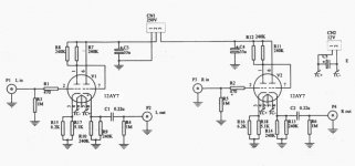

i have about 20 12ay7 tubes from the police I bought them from scrap all of them sealed brand new together with some other exotic tubes and i was thinking that i could make a line tone control preamplifier with them to use with my cd and power amp ....
i found fender schematic i can read that but dont know if line levels are switable to this circuit and also of course i can construct proper power sup for all these but i dont even know the numbering on the pins of the tube !!!
as i said i dont have a ny knowledge about tubes how can i tell on the schematic which pin is which and also nowere is any note about filaments ....is this taken for granded ???
please help me out
find att. of the fender schematic and if you have something that meets my specs please give me
thank you

12ay7 is not suitable for this application. Too much gain and very little drive ability.
For your application a 12B4 is probably the best choice.
A CD player has output< 2v rms and your amplifier has sensitivity of 1v.

Fast food, here you are. Audionote, no tone controls. Too much gain. You have been warned. And please don't give grief to SY. It takes some participation and eagerness to learn and SY helps even down to novice wiring level questions.

cause it has no tone control and also it seems that filament are powered with 12 v and i thing that this lamp works with 6.3 ?????
i ve been warned about too much gain ???? sorry didnt get this ??? be more specific ........
still fender uses this as a tone control preamp if iam thinking transistorwise the only thing might be needed to change is gain and/or input sensitivity
please excuse if i say something wrong and correct me if i am wrong thank you again
You can tie together pins 4&5 and apply 6.3V between them and pin 9. That will consume 300mA heating current per valve. The gain is going to be 24-25 times in practice(28dB). That schematic is a 2 stage stereo full line famous Audionote preamp, having a common cathode input stage and a cathode follower. It needs a 100k log pot on its input for volume control. Tone controls you can add from another suitable schematic for guitars or something. No hi-fi schematics with that tube sport tone controls as far as I have seen.
