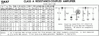

12AX7 Question
One thing to remember if you want to prevent clipping, is to keep the peak signal voltage to the control grid to no more than the Cathode Self Bias Voltage if the self bias resistor has a bypass capacitor.
Example, a 12AX7 that has 1.5V self bias and a bypass cap, the grid can take no more than +1.5V peak.
In fact, the grid will start to conduct before +1.5V because of the space charge.
1.5V peak is 1.06V rms.
Now, pick how big the maximum signal at the grid can be, accordingly versus the self bias voltage you have (and remember to leave a little leeway to account for the space charge).
For example, a 12AX7 with 1.5V self bias, I recommend no more than 1.0V peak (0.707Vrms).
That really restricts the 2nd stage of 12AX7 cascade amp, to a very small input at the 1st stage grid.
6A3sUMMER, That is a very good guide to the peak signal to be applied to the grid. No wonder I was having trouble getting a clean signal as I would of been way over the Cathode Self Bias Voltage.
