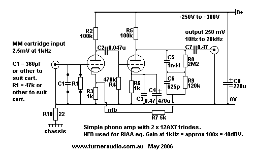

I recently got a very nice pair of 6N2P (almost 12ax7) tubes. Which ended up in building a phono pre-amplifier using the schematic of turners website as shown below.
As the description on his page already mentions, the bass response is bad when driving loads below 200k ohms.
I think a good phono stage using only to 12ax7 or equivalent tubes should exist for MM cartridges. (I've seen a lot of boards and even ready to use preamps using only two double triode tubes)
The big question is, what are your experiences in using preamps with pairs of 12ax7. What kind of schematic/circuit would you recommend for a 100k load output?
Any thoughts are welcome!

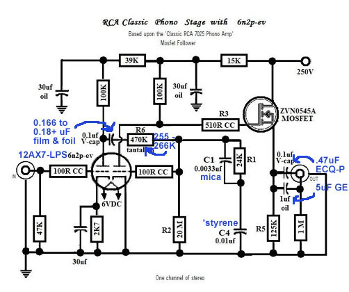

DC coupled voltage follower yes, "hollow state" no. A ZVN0545A enhancement mode MOSFET is better at this particular job. Even the wimpy 'X7 triode drives that FET's tiny capacitances with aplomb.
The tweaked passive EQ schematic I've uploaded shows how to set a ZVN0545A source follower up.

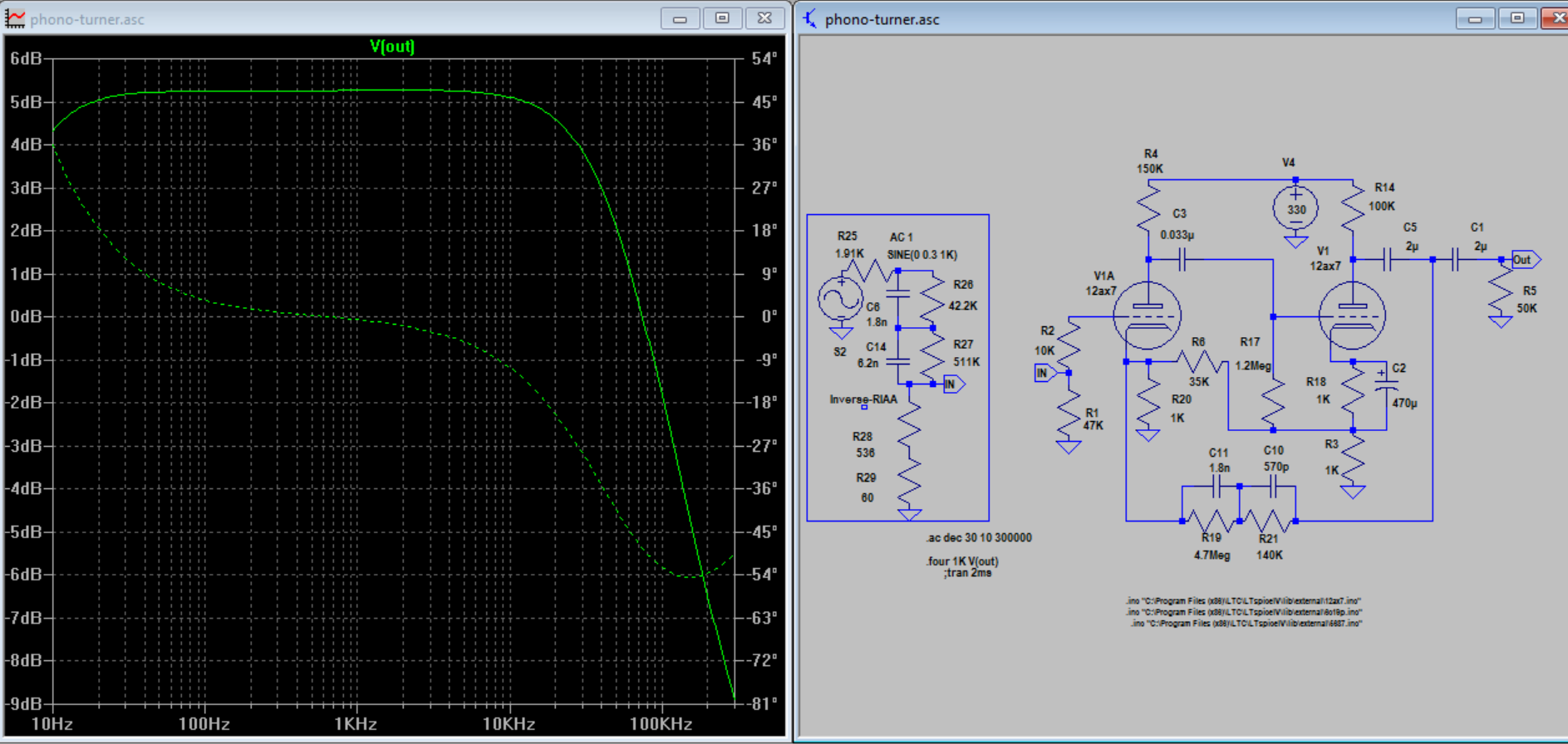

This Turner' phono is quite similar to Dynaco's. To drive 100K is not a big problem for 12AX7, but rather this RIAA eq uses NFB to operate, at low load the gain esp, at bottom end is insufficient hence the bass level. However Dynaco is better because it uses positive feedback to boost the gain as load is increased, hence the bottom end is better than Turner's which is a fixed gain good for fixed load. I have mod Dynaco, the sim shows has no problem to drive 50K load. If you use original RCA passive RIAA EQ, there is'nt a problem down to 50K or so.

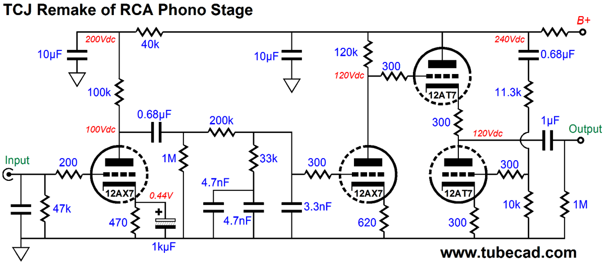

Haven't tried it, but just a thought from this blog post, all the way at the bottom.
PS-10 & More SRPP Designs
Essentially similar to what Eli posted but with a hollow state follower vs. sand.

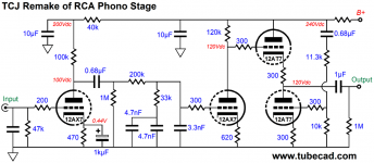

Interesting, but the first 12AX7 stage is run with a 0.44V cathode bias. With the grid-cathode voltage so low, won't the tube be likely to draw grid current? That would put a tough, changeable load on the cartridge, would it not?
More than 10 years ago, I did a remake of an RCA style phono stage, using the original circuit DC-coupled into a 12AV7 (plain old) cathode follower. I have to say, it worked out very well. I recently had it home for a checkup. I was comparing it to a Schiit Mani phono preamp I have, and I liked the RCA-with-CF much better (both driven by a Denon DL110 in a Technics SL1200mk2).
Eli's version with the source follower would be technically better, and easier to implement since there would be no need for a lifted heater supply.
Thank you for your great responses and the suggested circuits. I ordered a new chassis. I'll let you know when I get started!

The Tubecad circuit is quite nice but one wonders why you'd want a White CF dc coupled to the preceding stage just to drive some cable to a line stage.
If you don't need extra gain you could cap couple the WF and put a volume control behind the cap and the WCF for instance.
Further thoughts, that 1.000 microF cathode decoupling cap is going to have an impact on the sound. Biasing the first stage more negative would allow for a smaller cap but some of the RIAA components may have to be changed as well.
Personally I quite like to drive a passive RIAA with a CF and do away with that bypass cap altogether. Again, that would require altering the RIAA stage somewhat.
Then there are mu-followers as an idea as well, etc., etc.

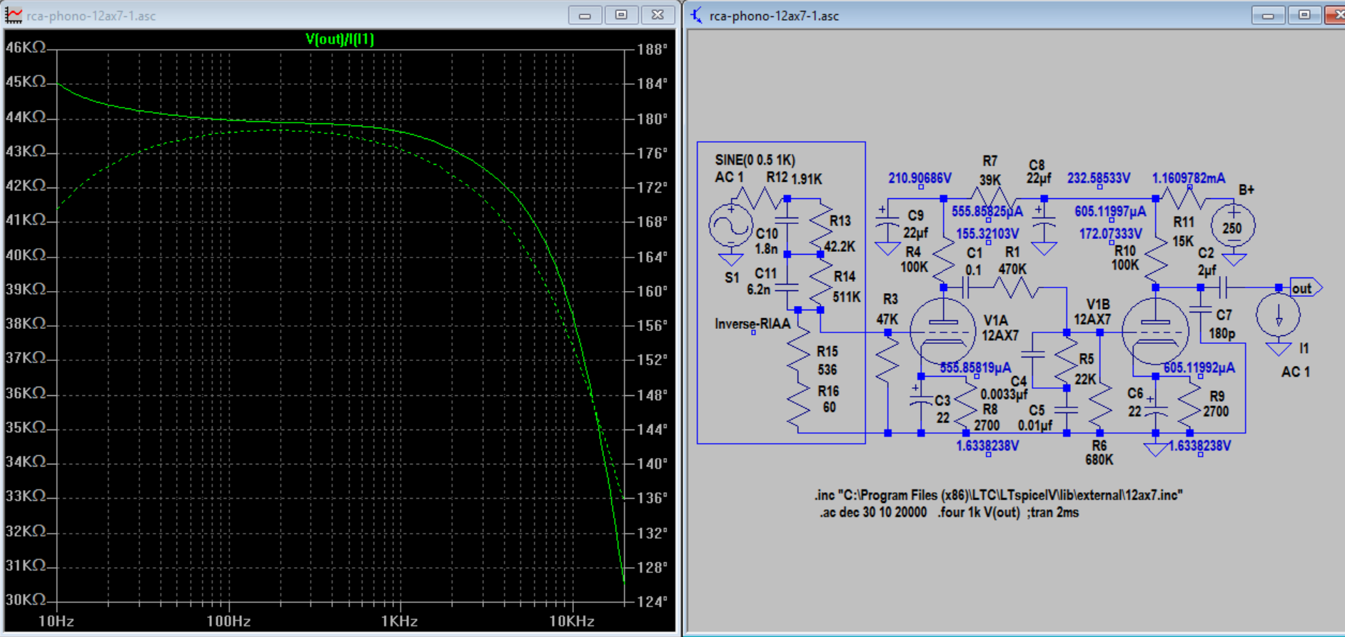

One thing that I was curious about is the higher output resistance of 250k driving a lower impedance of about 100k. This is something that could be tested and measured. Alas I do not own such equiptment to perform such tests. ...
That is why Simulator comes in handy. In fact the best load for this RCA phono amp with 12AX7 output is about 47K, just make sure the coupling cap is large enough for bottom end response at this load. 220K being the minimal load specific for this phono amp due the output stage is also accounted for freq. response (e.g 180p capacitor). As output buffer is added, this small cap can be eliminated and loading effect is minimized and linearity readjusted.
