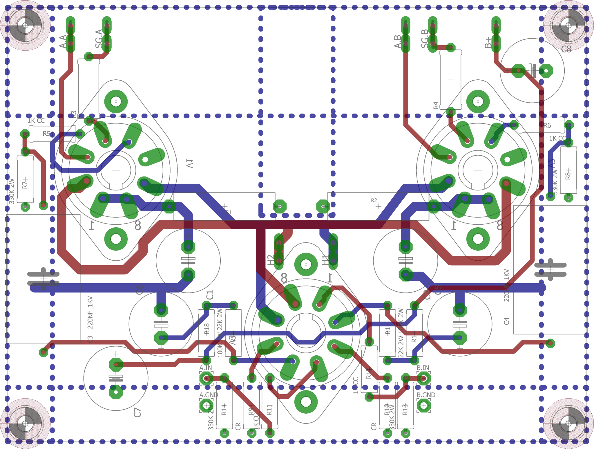

I will have boards available again in a few days. Asking the price of a pack of cigarettes for a board if you need one.

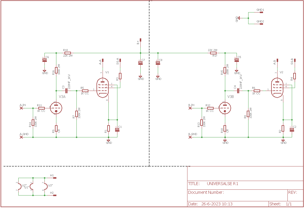

This is the classic schematic for octal output tubes and 6SL7 or 6SN7 driver. Cathode resistor output tubes depends on wether you go with 6V6GT EL34 or 6L6.

This is my latest plausible schematic. A bit uncertain if the gain will be enough to run it without a preamp. Might have to change it to an 6SL7 and add some NFB.
