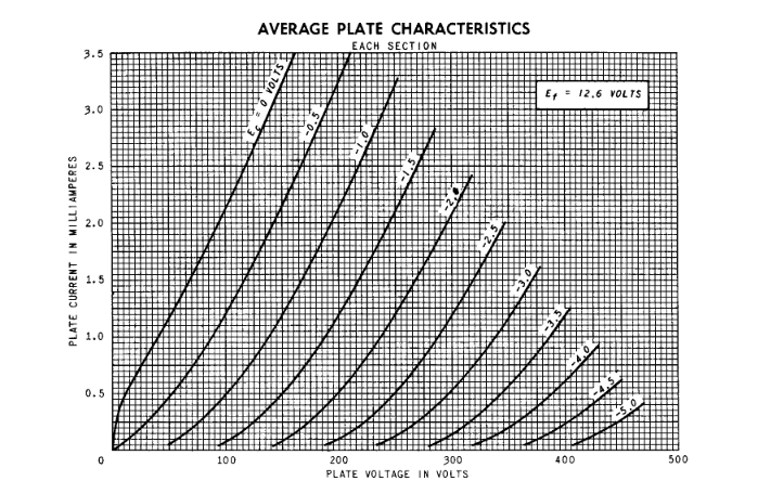

Consider a single 12AX7 with twice the plate resistor and twice the cathode resistor as your circuit.
By the bisection theorem, the voltages are the same as in your circuit, so you can then use the
standard curves for one section to plot the load line. Of course, the power supply still has to give
the full current, and the stage's output impedance will be half.
On the plate curves, just double the values of the plate current (Ip) scale and you are !

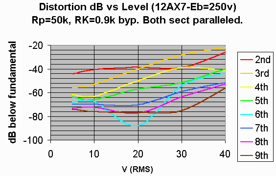

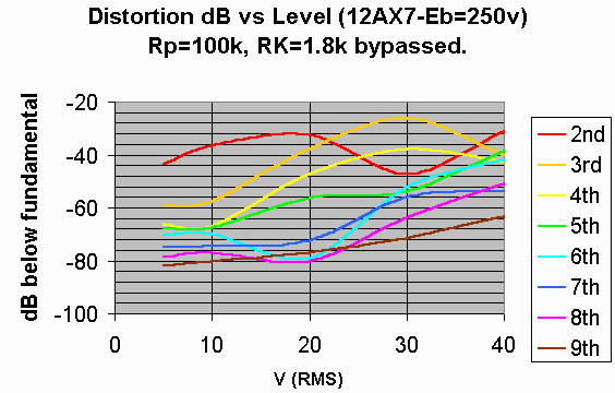

I have only ever found one set of actual objective measurements comparing single and parallel triodes. They were the work of one Steve Bench, a gifted electronic designer who had an Internet presence in the late 1990s and early 2000s. Bench's measurements did show some measured differences between single triodes and nominally identical, paralleled, ones.
Here is Bench's measurement of a single triode:
http://www.jacmusic.com/techcorner/SBENCH-PAGES/sbench102/d_ax7_1.gif
And here, his data for paralleled triodes: http://www.jacmusic.com/techcorner/SBENCH-PAGES/sbench102/d_ax7_3.gif
(I've attached those two images to this post, as well.)
You can see that the two sets of distortion spectra Bench measured, are, in fact, not the same shape at all. The 2nd harmonic curves, for example, have a significant dip at 30 V rms in the case of the single triode; that dip is virtually non-existent for the parallel triodes.
I think what we're seeing is the reality that the two triodes in one 12AX7 bottle are never, in fact, exactly identical. This means they will have slightly different transfer curves, and therefore, produce slightly different harmonic spectra at any given level of signal drive.
Those two slightly different spectra will be summed together at the paralleled anode, and the the resulting sum will not be exactly the same as either individual spectrum by itself.
And it's the summed spectrum that we hear (or see, in Bench's measurements.)
This means any supposed benefit (improved distortion quality) occurring from paralleled triodes is a complete and utter roll of the dice, depending as it does, on the statistically random slight differences between the two triodes in one 12AX7 envelope. There is little chance that any two 12AX7s will produce the same results when paralleled.
I would say therefore, that paralleling triodes in the hope of getting improved sound, falls into the category of gambling, rather than good engineering practice.

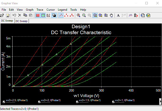

Parallelled triodes in simulation will look the same as one triode with twice the gm and half the ra. In reality, as Gnobuddy says, they will not be identical so distortion will be different and unpredictable. However, one might expect this to be a small effect unless a poor bias point is deliberately chosen.
Easily, for ideal case, like most people here pointed.Easily simulated.
For simulating real case, one needs to manipulate rp, µ and gm for each device, for finding transfer curves more like reality. Eg.: one element with µ=105 and other with µ=95, and corresponding gm and rp variants (creating new Spice models, for example). Like late DF96 and Gnobuddy said, this is unpredictable in real life but yes we can simulate a hypotetical case and see the resulting mathematical transfer.
