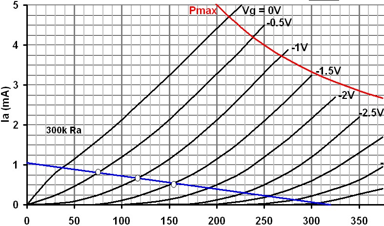

I'm using The Valve Wizard's load line calculator to try to determine how to configure a particular 12ax7 stage for max output and no clipping.
http://www.freewebs.com/valvewizard2/LoadLinePlotter.xls
I will bypass the cathode's resistor with a "large" cap or use LED bias. I have red LEDs that provide 1.6 and 1.7 volts but I'm not afraid to use a resistor and cap since I think "hotter" bias may be better for me (and it's a guitar amp.)
I have a 320V PS node available and I think the grid will see about 1Vp-p. I know that I should keep the bias point yielding at or under 1ma, and I guess I should probably keep the grid from reaching zero volts when driven. The total load I have on the output signal is probably around 200k.
It looks to me that a 200k Ra with a bias at about -1V would provide a plate swing from 95V to 170V for an output of 75Vpp. And a 300k Ra would swing the plate from 75V to 155V for a swing of 80Vpp. Higher value Ra doesn't appear to yield more swing potential. And a 100K Ra looks to yield about 60V swing when biasing below 1ma at around -2V.
This is the 1st time I’m really trying to use load lines. It appears to me I should use a Ra of 300k? Are there other considerations that would affect the ideal plate resistor considering my goal of maximizing the output signal? Is 300k just crazy?

Your loadlines look good. 200-300K seem to be good values.
You could get a little more by using a CCS load for a flat loadline, and a gain of ~100.
When estimating the gain, you will however also need to consider the AC load represented by the next stage.
If you have a 500K gridleak on the next stage, you should draw a new AC loadline with the combined load (300K in parallel with 500K), centered on the operating point.
Svein.

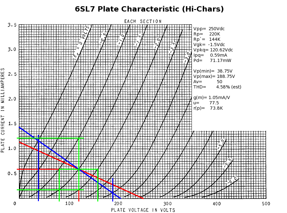

You do it like this (attached). The normal DC Loadline comes in at:
Vpk= 120.62Vdc
Ipq= 0.59mA
The AC Loadline is based on the expected impedance, in this case: 144K. So figure the deltaI:
deltaI= 120.62 / 144E3= 0.84mA
Add that to the DC bias current: deltaI + Ipq
0.59 + 0.84= 1.43mA
Find that point along the vertical (plate current) axis, and draw the AC Loadline between that point and the Q-Point on the DC Loadline. Done.
Will this change the ideal Ra value for me or does it just accuratize the projected output strength?
It does change the Ra value completely so far as AC operation is concerned. Sometimes, it makes a difference, and sometimes it doesn't. (Inthis case, it made a big difference.) If the AC load is within +/- 5% of the DC plate load, I just ignore the difference. That's probably well within component tolerance, and hollow state is a good deal more "forgiving" than solid state design anyway.

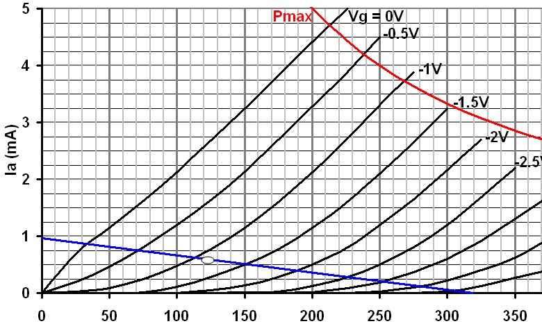

Finally got to it. Closest value I had is 330k for the plate. A 2.2k cathode yields 1.28v for 0.6ma. PS node is 319 and the plate is 122. Definitely an improvement in output from that triode. Not huge but it's what I needed for the application.
I checked the max swing on the grid and it's around 0.5p-p. I could probably go a little hotter on the bias for a little more gain w/o reaching saturation but I'm happy for now.
DC load line:
