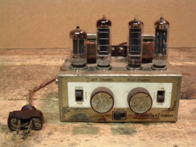

...the stereo SE amp my father bought used 35C5s, not the 50C5s. .... at Lafayette vs Radio Shack.
Has to be 35's. You have 117V supply, a small 12V tube, three large tubes (no sand rectifier yet). 12+35+35+35=117V.
The 50V tubes worked when we had non-heated rectifiers: 12+50+50=112V (near enough).
The 60V (60FX5) tubes arrived when hi-output needles meshed with hi-gain power tubes and the preamp was dropped.
In this period, both Radio Shack and Lafayette bought products from Asian factories, contracting for their logo on box and panel. Radio Shack eventually (CB boom days) dictated what these factories would make; Lafayette faded.
12ax7 was not intended for series heater wiring so it's cold resistance is relatively high. In a series circuit that means to gets a lot more than 12VAC until the resistance of the other tube heaters comes up to operating temperature. 12+35+35+35 = 117VAC.
When I was a kid, my dad bought an AC/DC stereo amp with a 35W4, two 50C5s and a 12AX7. When you first turned it on, the 12AX7 heater filaments would light up like a light bulb and then calm down as the other tubes heaters came up. It never failed to amuse me - and also never failed operationally.

No, cold resistance is low. The flash comes from parts of the heater not cooled by the cathode.
Ya, 35C5; 35W4 cold resistance is low, RELATIVE to the 12AX7. 12AX7 are intended for transformer heater power where they do not flare as much because the heater voltage is never more than 2x 6.3VAC, but they may still flare depending on the tube maker. In a series heater circuit, the current depends largely on the other tubes. Of course the only part of the heater you can see is the part not covered by the cathode.
