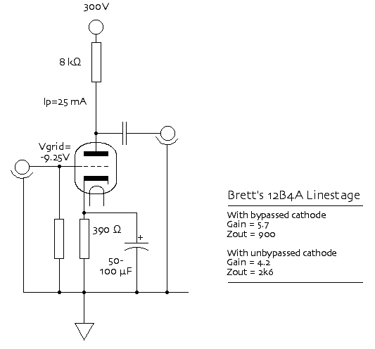

Here are my questions:
1. The above will have an output voltage before the CCS around 350V. Is 350V appropriate? I think I can easily adjust C1 to get a higher or lower voltage.
2. From PSUII I gathered the initial surge currents far exceeds the ratings for the transformer T1 (2A vs 150mA rating) and the choke L1 (1A vs 250mA rating). Would this be a problem? It is just for a short period of time of less than 0.2 seconds. Could I use 15H@100mA for the choke? It is much cheaper.
3. PSUII suggests the I(T1) RMS being 231mA. Why is it so high? Have I done anything wrong here? The 2 x 12B4A needs around 60mA so I thought 150mA rating for the transformer would be OK. Do I need to use 250mA rating for the transformer to be on the safe side?
4. For the shunt regulator, I can't find BSS135 and 2sk43-4 from anybody who don't impose "minimal order USD$300". Do you know of any substitutes?
