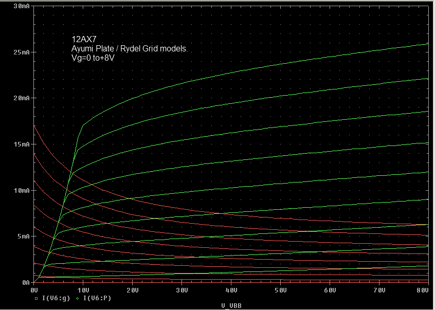

Didn't see data anywhere on the net, so measured it myself.
12AX7 Class 2 (Positive Grid Voltage) Operation
I only took 5 points of anode voltage, so it's rather blocky. *The actual curves in the <10V range are quite steep: both in how rapidly plate current rises from zero, and for grid current falling from its peak.
Probably a watt or two of output power would not be unreasonable, and despite being high mu (= lots of grid cross section..?), it looks like the grid is quite 'soft', drawing even less current than a 12AU7 at similar grid and plate voltages. *Looks like "beta" of 3 or so isn't unreasonable.
I'd SWAG a grid power rating of 0.1W should be pretty good for longevity. *12AU7 has the same size cathode, and is rated for 20mA DC, so... there really shouldn't be anything wrong with operating in this region. *And pulses could go much higher (though 'beta' is probably worse at, say, >100mA cathode current).

FWIW, I've got 0.65W from a single 12AX7, common cathode, near-zero bias (a little grid or cathode bias controls zero-crossing linearity, which needs to be balanced otherwise the gain around zero will be too high or too low). Input resistance about 1k ohm, load 4k ohm, supply 150V. (Resistances are per-side, not end-to-end. Which is the load seen / presented by each tube half, since they're pretty well class B with minimal overlap.) Linearity looks good.

12AX7 model is combination of Ayumi and Rydel/Excem (for Ig). I tried to match your grid current. Ayumi Ip is high, but much better fit in +Vg region than the Rydel 5 parameter model.

Code:
.SUBCKT 12AX7AY A G K
EGG GG 0 VALUE={V(G,K)+0.59836683}
EM1 M1 0 VALUE={(0.0017172334*(MAX(0,(V(A,K))+1e-10)))^-0.2685074}
EM2 M2 0 VALUE={(0.84817287*(MAX(0,(V(GG))+MAX(0,(V(A,K)))/88.413802)+1e-10))^1.7685074}
EP P 0 VALUE={0.001130216*(MAX(0,(V(GG))+MAX(0,(V(A,K)))/104.24031)+1e-10)^1.5}
EIK IK 0 VALUE={STP(V(GG))*V(P)+(1-STP(V(GG)))*0.00071211506*V(M1)*V(M2)}
*EIG IG 0 VALUE={0.001165108*MAX(0,(V(G,K)))^1.5*(MAX(0,(V(G,K)))/(MAX(0,(V(A,K)))+MAX(0,(V(G,K))))*0.8+0.4)}
EIG IG 0 VALUE={0.000565108*MAX(0,(V(G,K)))^1.5*(MAX(0,(V(G,K)))/(MAX(0,(V(A,K)))+MAX(0,(V(G,K))))*1.2+0.4)}
GIAK A K VALUE={MAX(0,(V(IK,IG))-MAX(0,(V(IK,IG))-(0.00058141055*MAX(0,(V(A,K)))^1.5))+1e-10*V(A,K))}
*GIGK G K VALUE={V(IG)}
Gg G K VALUE={IF(V(G,K)>0, 220u * ((( 20 +V(A,K))/( 17.3 +V(A,K)))**8.5)*V(G,K)**1.5,0)}
