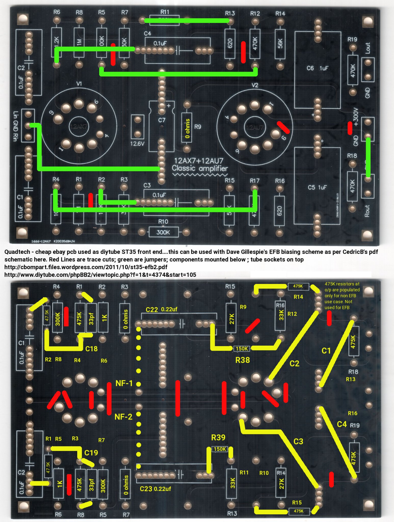

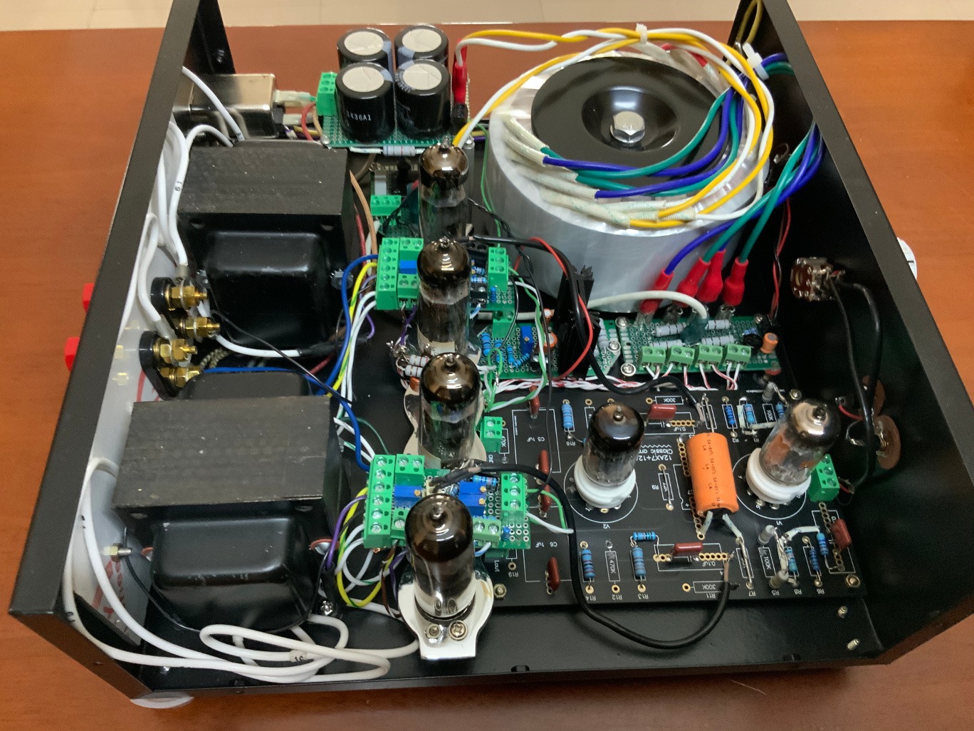

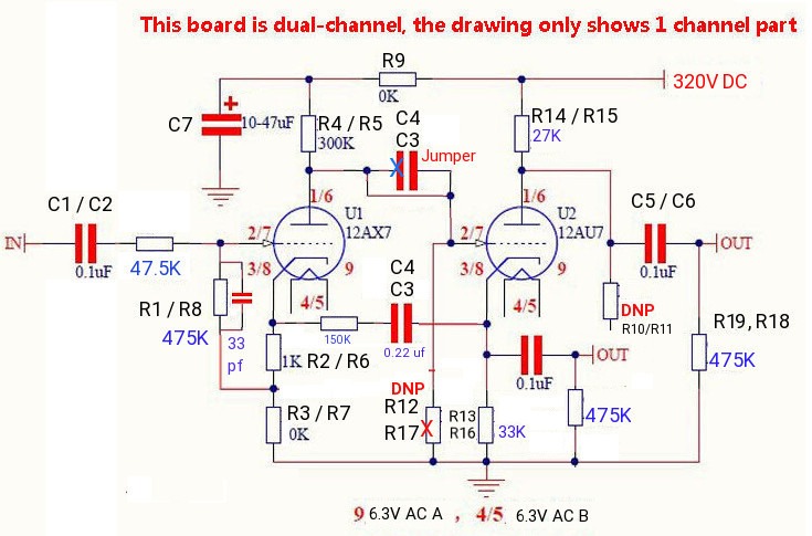

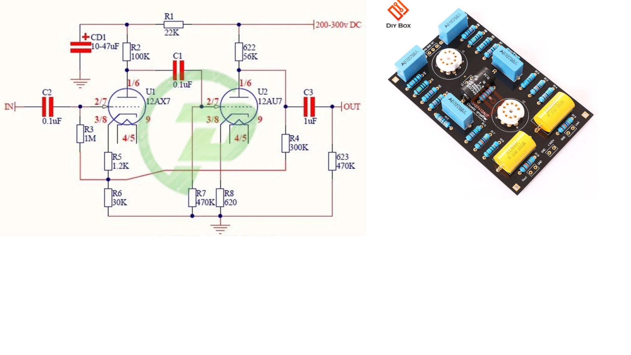

Recently a friend donated me some NOS 6189W tubes they are basically 12AU7 mil-type. I wanted a simple easy circuit to plug them into. I decided to buy one of these kit preamps from Aliexpress. This one is from DIYBox store but there are a few others that sell this kit and some say "Marantz 7" style.
Just wondering if anyone has experience with them and can suggest tuning and mods for it. It probably needs some tuning or adjustments to optimize the circuit for the 6189W so i'm all ears. The PCB quality is very good.

cool - should "sound good". A second board could be added and use ax7 in the second position as a Hegeman tribute phono preamp with the 12ax7 cascade feedback pair with gain set to ~100 driving passive lumped RIAA eq (per Citation I and Citation IV) An anode follower au7 can be good for a low gain line stage as alternative to CF.

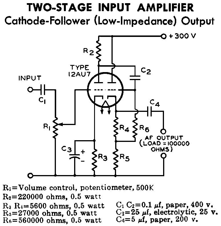

I want a really simple preamp to put in front of my Aleph J. I've decided not to build this circuit.1) i'm told it is unity gain 2) I don't really want to do all the hacking with the trace cuts and jumps. I am probably just going to use the RCA Radiotron circuit with my own PCB layout. If anyone is interested in the PCB for the RCA line amp using 12AU7. I will offer a few for sale when they come in:

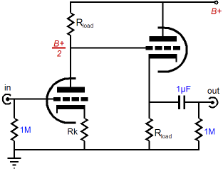

A better choice may be something like the CCDA from TubeCAD, it'll be a similar circuit and PCBs are available from TubeCAD, and I even have my own version I recently developed as well-
https://www.tubecad.com/2009/03/blog0161.htm
Here's a simple schematic with basic info, for a 12AU7 something like 22k Rload, 560R Rk would be a decent starting point-

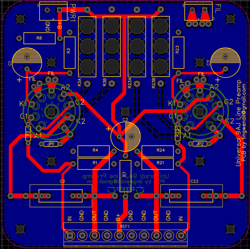

Here's a multi-layer view of my variant of the PCB- I'll be releasing the design files once I have them in hand to test functionality.
One bottle per channel and simple easy parts values.
