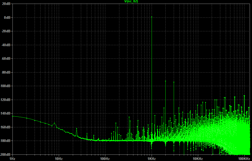

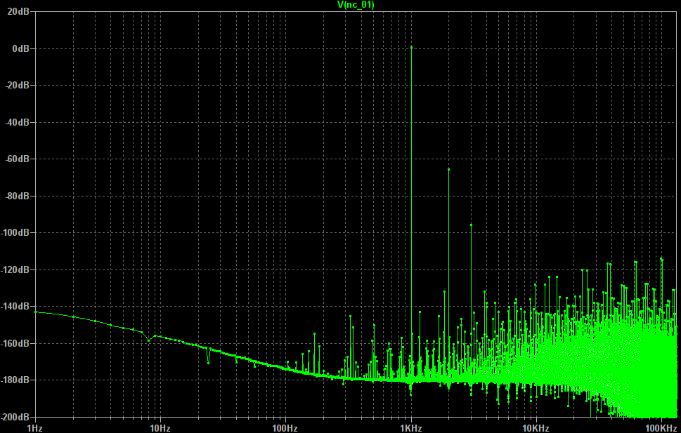

Hmmm... Why would the simulation show such drastic differences in distortion from the inverting and non-inverting outputs?
Never mind longer tail and higher B+ gives much closer results (however HD2 not as low as the non-inverting was with the shorter tail). More investigation called for.
Put a constant current sink in place of R5 and see what happens to your harmonic distortion results. 🙂
Looking at the circuit, the operating conditions for U1 and U2 are completely different; plate voltage, plate current, plate resistor, grid to cathode voltage. U2 grid in terms of AC is bypassed by C3 making U2 cathode input. U1 uses the grid for input. The only thing that UI and U2 have in common is cathode voltage.
The difference in distortion performance is not too surprising.
DT
DT
To get identical performance at the two outputs you need perfectly matched triodes (you get these for free in simulation), identical circuits on both sides (e.g. bias arrangements, anode load), and perfect balance.
Two ways to get perfect balance:
1. feed antiphase input signals to both grids (then the tail does not matter)
2. use an infinite tail impedance and AC ground one grid.
Not necessarily. If the tail's impedance is indeed infinite and the anode resistors identical, you can use a 12ax7 for one half and a 12au7 for the other. The (AC) symmetry will still be perfect, at least at low frequencies.To get identical performance at the two outputs you need perfectly matched triodes
All that is of course theoretical and assuming no additional load at the anodes.
Already covered byKay Pirinha said:...3. and equal plate resistors!!!
DF96 said:identical circuits on both sides (e.g. bias arrangements, anode load)
OK. The more similar the triodes and the higher their mu, the less sensisitive is the circuit to tail impedance - so 12AU7 is a bad choice for a resistor tail. The better tha tail, the less do the triodes have to match - but two different triodes will tend to give results dominated by the 'weaker' one in gain terms.Groucho2004 said:Not necessarily.
A good way to consider the LTP phase splitter is to think about common mode gain and differential mode gain. Differential mode gain is essentially the same as for a grounded cathode circuit, so is a bit less than mu. Common mode gain is like a cathodyne, set by the ratio of the cathode and anode resistors. Hence the ratio of the two gains (which sets output balance when used with a single-ended input) is maximised by high mu and high tail resistance. Fortunately common-mode input produces common-mode output, which a PP output stage will largely ignore. Hence people have been able to get away with using low mu valves like 12AU7 and 6CG7 as LTP phase splitters with a resistor tail even though the performance will actually be poor.

Of course the different size plate resistors are because of the finite tail. But increasing the tail to 27k and the B+ to 300v gave much better results. Looking at this as an opportunity to put the bunch of 12AU7s I have to good use and make a decent low gain preamp without dumping a lot of cash into it.
Somewhere else in this board it has been shown that even a LTP with such very different triodes as half a 12AX7 and half a 6922 provides perfect AC balance, if the tail is a CCS with virtually infinite impedance, and the plate loads are equal, of course.
Best regards!
The math is very simple. If the ccs in the tail is ideal, the absolute value of a current change in each valve is identical (assuming no current flow in the grid circuit).Somewhere else in this board it has been shown that even a LTP with such very different triodes as half a 12AX7 and half a 6922 provides perfect AC balance, if the tail is a CCS with virtually infinite impedance, and the plate loads are equal, of course.
In practice, grid current or - more prominent at higher frequencies - grid currents caused by Cag/Cgk will upset that balance.
