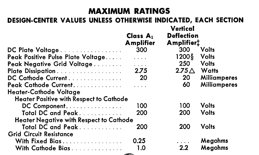

220 v AC secondaries which I find very high for the 12AU7. Max rating for this tube is with most manufacturers about 330v DC.
Two questions: will the lifespan of the tube suffer with this high voltage?

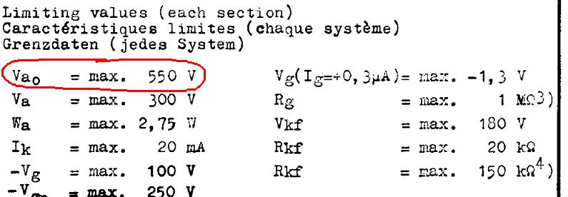

It applies when the valve is cutoff, yes.
If the load is a resistor (not inductor) then when the valve is cutoff, the voltage across it will be equal to the B+. So Vao is basically the B+ limit.
If the Vao limit applies in cutoff (i.e. zero plate current) only, it can't be used as B+ with a gainstage using a resistive load without exceeding the Va limit (i.e. with plate current) for a significant part of a large signal.
This raises the question: How exactly is the Va limit defined?
The idle anode voltage must be less than the Va limit, the B+ must be less than the Va0 limit.

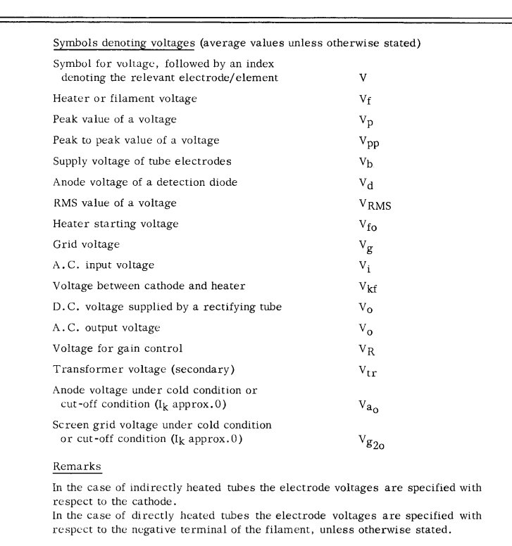

Thank you , Merlin.
Meanwhile I also found the Va definition in your hifi book as well as in one of my old Valvo tube data books.
Keyword is "average DC" as opposed to instantaneous or peak voltage.
I had wrongly assumed that Va was a hard limit whenever there is a plate current.

Philips and Siemens both define Vao as permitted with a cold tube.
Now you can still argue what "cold" means or "approximately zero" ...
