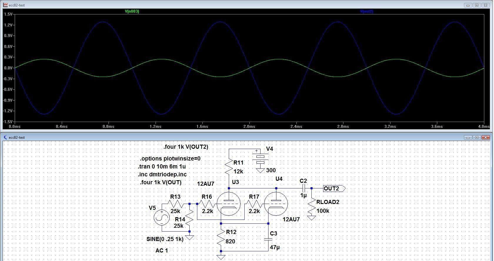

So I took a screenshot of the graph that was generated by the schematic, and I can see that the voltage of the output has increased 5.2x. I'm not quite sure how good that is or isn't. How can I calculate output power from data provided by LTspice?

Hi Matt,
Your results has nothing with good or bad to do. What you see is gain ie. how many times the signal has been amplified. What you see is taht with the volumepot at 50% you get 1.2Vout when feeding 250mV in. 250mV is the same as 125mV in with the volumepot at 100%. So your gain is 1.2V/0.125V= ca 10 times/20dB.
You do not count preamp output in terms of power.
So if you are in the middle of a college course in electronics I think you can get some good basic info from your teacher.

I've learned how to use LTSpice well enough to figure out two power supplies (not like they're that complex) but the simulations output nothing like what the actual circuit or even common sense point to.
A 300V wave from the transformer going through a bridge rectifier, resistors and caps shouldn't end up being 297V DC, right? RMS power and all that.

Hey Matt,
You have to use peakvoltage when simming. So multiply AC by 1,414!
About "big highpower resistors" it will be enough with std 5W wirewound found in your local shop. To build a good PSU for your pre you can easily do it by using a few cascaded RC links.
As we now can communicate by using *.asc-files things will be a lot easier. To publish them just change the name to *.txt .
In your circuit:
Change Sine to your unloaded AC-voltage *1,414, should be ca 420V AC.
Also add Rser to be ca 250ohms.
Add a CRCRCRC-link of 33u-1k-33u-1k-33u-1k-33u
Now you should end up with a ripplefree DC of 280-290V.
Add a load of 10k as this corresponds to just below 30mA load.
This should be in the ballpark of the correct IRL conditions.

Thanks, I've laid out a new circuit using that cascade that you suggested. My unloaded voltage of 294V x 1.414 = 415V peak, so with that going into the power supply a load resistance of 10k ohms like you said gets 316V DC output. A resistance of 8500 ohms gets 301V DC.
Which resistor were you referring to when you said Rser?
