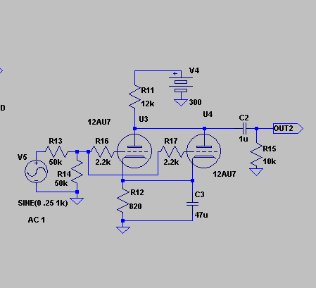

12AU7 Preamp build
My second tube project, and first to not be from a kit. The schematic is based on the 12AU7 Tube Preamplifier Project from DIYaudioprojects.com, which I have done extremely minor changes to. The chassis is made from extruded aluminum with custom endplates and a custom mounting system for it. The bottom piece of the chassis slides off, so work will be easy. The transformer is a Hammond 269AX with a 120V primary, and a 250V CT secondary and a 6.3V filament secondary.
The chassis is nearly complete, so here are some pictures.
I'm sure I'll use this thread when I run into electrical problems as I work on this over the summer. I want to do a majorly professional job on this one, no more rats-nest wiring jobs like everything I've ever built in the past.
Comments and thoughts are appreciated, anything I can do better I will. Thanks for reading.

Hi Matt,
Is this a guitarpreamp? Because that is probably the only thing you could use it for. It has a -3dB point of 20Hz and high gain of 45dB which means you have a sensitivity of 6mV for 1V out when loaded by 100k. If you want to use it for hifi you will need to make MAJOR changes to it😉. Or preferably use another design alltogether.
The buildup and box looks good so far 😎 !

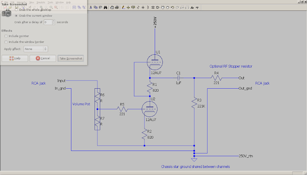

I would just use a SRPP stage. Fewer components, that's good for starters. Just Google "ecc82 srpp" or "12au7 srpp" will bring you many schematics.
I built such a pre-amplifier in the late 1990s commercially, and it sounded surprisingly good.
Very simple, just 8 -10 resistors, two coupling caps, and the tubes - excluding the supply which was ~ 250V..
Have attached screenshot (from Linux) showing the basic circuit. Need good clean plate supply and recommend dc filaments particularly in cramped space.

I was hoping I could use it for my turntable as well as my guitar. Right now I can't use either on my K16LS kit tube amp. I was also hoping to use it as a preamp to solid state stereos on occasion.
Is the issue that the schematic I was basing off of doesn't have much gain? How did you determine the -3dB point and high gain point?
Since I bought all the parts already for that other amp, I need to find a schematic that can use the Hammond 269AX and the 12AU7 tubes, the rest of the parts were relatively cheap and not a big issue if they go unused.

Thanks for the schematic. What is the resistance value of the volume pot? Or would a 100k pot work?

I suggest going for kevinkr schematic, maybe with a 50k potentiometer or, better, a stepped attenuator (you can have them cheap on ebay).

Yes a 100K pot, 50K or even 20K pot (solid stage sources only) will work just fine. Try to find an inexpensive stepped logarithmic attenuator on eBay - there is a seller who from time to time who sells nice ones quite inexpensively. Quality here pays off handsomely in the long term.

In that case, this project will be a line stage preamp. Which schematic would you recommend? Would the one I was originally making be sufficient? If you think the one used in the article and the one that it was derived from are decent I'd like to build one of those since I have all the parts for both.
Hi Matt,
As I said in my first post it is totally unsuitable! In other words a total disaster whatever you want to use it for. WORTHLESS!

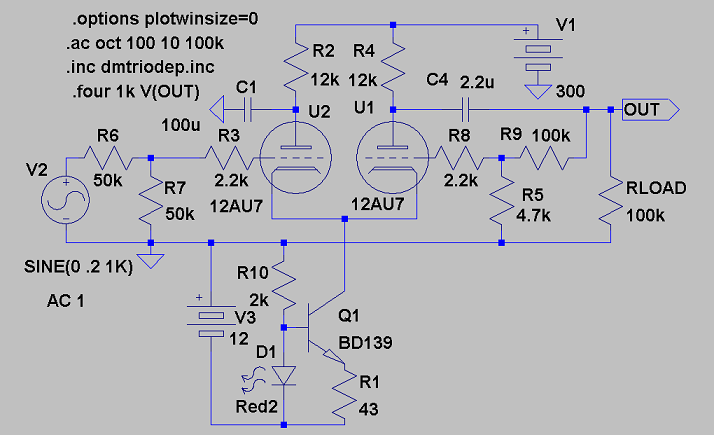

If you go SRPP you should use max 20k-50k as volume pot, as with higher values frequency response is worse at 50%(middle of the pot). The one I suggested is independant so you can use 100k if you want and it also has adjustable gain by adjusting R5 in the NFB.
The SRPP suggested by Kevinkr and the one above are about the same with respect to Zout and should not be loaded by less than ca 100k.
But go for the SRPP as this will be easier to build (even if SRPPs IMHO does not sound good enough for hi-end use). The SRPP will also have a little higher THD but this does not matter either, as it is only second order harmonics.
Your PT has OK voltage when used with a bridge rectifier w/o the CT connected. You should stay well above 250V B+.
EDIT: SEcond thougths, the one below will sim just a tad worse THD than the SRPP. But it might sound even better......
Why not try them all😉 !

Thank you, that second schematic you supplied looks quite do-able for me. It looks as if the triodes are in parallel though, how does that work? I just don't think I've ever seen tubes connected like that instead of being lined up basically in series.
Also, could I put a pot at the front of it, maybe putting my 100k pot in parallel with one of those 50k resistors on the input? I'm just trying to figure out the function of those resistors.
The two 50k IS a 100k volume used, when I simmed the circuit😉 . But you should not go above 50k. So just substitute the two 50ks with a 50k pot.
This is a simple solution that you can begin with and rebuild later.
Zout is halved and Gm is doubled when parallelling.
