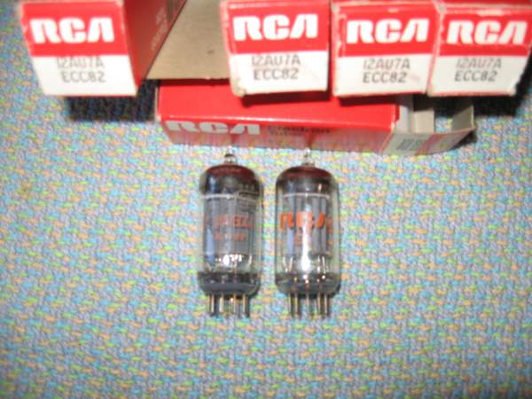

Odd that the GE tube in your pic has a painted on code and not an etched one...
Either way, if the tubes measure well and sound fine that's all that really matters.

From the plate structure, I'm 99.998% sure it's a Sylvania/ECG Philips. I've held, touched, fondled untold quantities in my days as a TV tech.
I'll second that, and I worked for GTE in the days when they still made tubes and before / during the sale of ECG to Philips in the early 1980s.

There appears to be some green marking showing in 2 of your photos. Any on the others tubes you have?
@Tom Bavis
"I have Mullard, RCA, Sylvania tubes relabeled GE - they all have the 188-5 code (GE, Kentucky)."
Did GE acid etch when relabeling, with the dots and all?

One other tube has a small green spot on it.
I wiped the tube in the photo with an acetone swab, and the white ink came off immediately but the line of green ink is still there.
I guess the original marking on the tube was in green ink ?

Hi yajnaS,
I looked on ebay and there are several philips 5814a's (with a green ink) that look like they have a similar plate structure, so maybe as mentioned in previous posts they are late production Philips.
Rather than being remarked, possibly the green ink on your examples could be slopped ink from the previous production printing run just slightly transfering to the next batch being printed. Maybe the printing unit was not completely cleaned.

The first pics posted and a few others here, do not look like GE's.....those plates look/are like Sylvania's/Phillip's.....

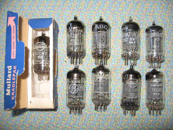

I got to digging in my stash to see what I had in terms of 12au7's. I don't have any equipment at this time that uses them so I had to dig deep. I got these in my many years of scrounging around.
The first picture is mostly Mullard made types from Blackburn. The Brimar is also made in England. The Siemens is a D getter type. There is also a "foreign made" mullard with the delta Holland etch.
Down further in the stash I found a sleeve of RCA 16-17mm large plates. I guess I might even have more of them somewhere.
