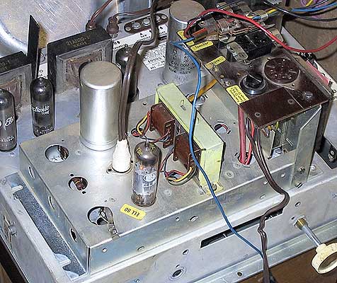

Just got ths running -- 1 tube, stereo single ended pentode amp.... (ignore the PP 6BM8 it is sitting on top of)
dave

6360?
12AT7 has Rp around 10k at the lowest, so you'll need like two triodes in parallel for your 22k OPT. (Where'd you get something like that anyway? Universal OPT? Freq. response can't be terribly great at that impedance...) I'd recommend a low-Z input source so you can overdrive some grid current, but that's probably not going to be possible. AT just doesn't really have as much current as I recall, so good luck on getting 1W or so. Have fun!
Tim

where was it made? Those OP tranformers look familar. I have a small Phillips stereo that runs SE EL95, nice tube for low power.
It is out of a Normende hifi made in West Germany -- the OPTs are often called Telefunken, but i suspect they just come from the same OEM... most of the German OPTs are, at least externally, much better looking than the typical north american fare.
dave
dave
Do not know who made the OPTs for my Philips but they are real nice. Not enough power for bass without K horns, just a little floppy with them😉

Philips is big enuff (and wide enuff in scope) that they likely built them themselves. The Philips OPTs i have seen are distincly different from the sameness of the ones found in Normended, Lowe-Opta, Imperial, Grundig, Telefunken, and more obscure German makes.
The most impressive German OPTs i've got are out of an East German console -- EL84 SE the size of the OPTs in a Dynaco Mk III -- they totally dwarf anything else i have. Another of my favorites are some diminuative EL95 OPTs that were used in a "2x Sat/Sub" combo for mid-tweeter use only... almost jewel-like ... they should make a nice little tweeter amp.
dave
