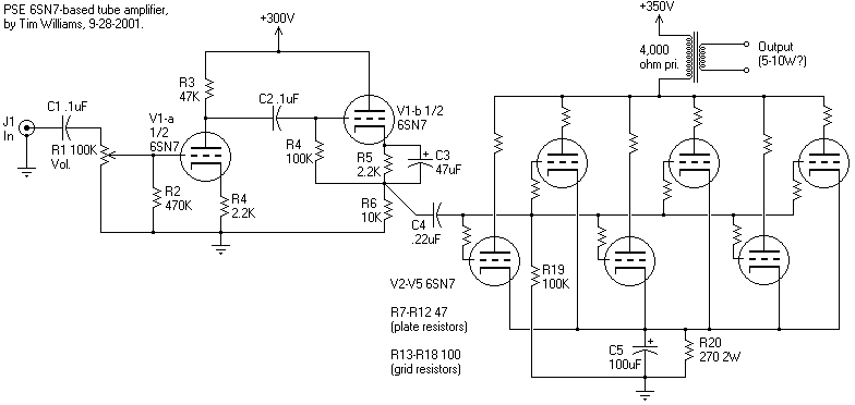

Sch3mat1c said:S'pose I should post Hept'AU7 now 😉
Tim
Nice circuit but I need something small. A couple of ?s for you about it if you don't mind. I have only seen the series plate Resistor in PPP amps. Do the 470 ohm Rs somehow make up for the 12AU7s match for OP tube use? To me, and I only have practical exp., they would help balance a PPP amp but just eat power in a PP amp? Why go for the 12AU in the preamp? I am not sayin it aint so just asking please🙂
But really I am leaning towards just SE so I can have 3 gain stages before the OP.
I would avoid the interstage transformer* cause it is not something I have in the bin, so to speak😉
*VOX style pigtail has become my standard for guitar. FWIW I have always used a Williamson driver PI among other things in my HiFi stuff.

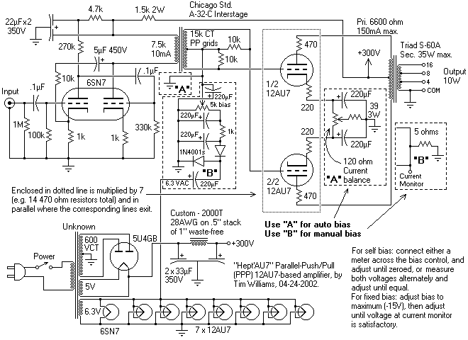

adamamp said:Do the 470 ohm Rs somehow make up for the 12AU7s match for OP tube use? To me, and I only have practical exp., they would help balance a PPP amp but just eat power in a PP amp?
They are to balance current in the superparallel arrangement, but actually are superfulous. I didn't know it at the time. The cathode resistors in fact provide 10 times more current-spreading action despite being half the value.

Personally I'd avoid the IST for technical reasons. The PP balance in the above circuit happens to go circular...erm... 90 degrees apart when you have one set of grids on horizontal and the other on vertical, on the scope. Anyway, around 18kHz I think, I observed such phasing.

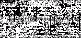

For SE, come to think of it, a circuit like this may be more suitable. (Doh, on editing it got saved in transparent format.) In fact 6SN7 is close enough to 'AU that you shouldn't have to change any values. 🙂

1. I like the AU 🙂 2. I have a lot of them 3. The OPT shown just happened to be the right impedance for around 7 of the things 4. It was new and weird!
The problem with a 1-tube amp is to get that output, you'll need a really high Z primary. Alternately you can try class AB2, but the AU's grids are very high perveance (as grids go). Good for power rectification, bad news for signal driving.
