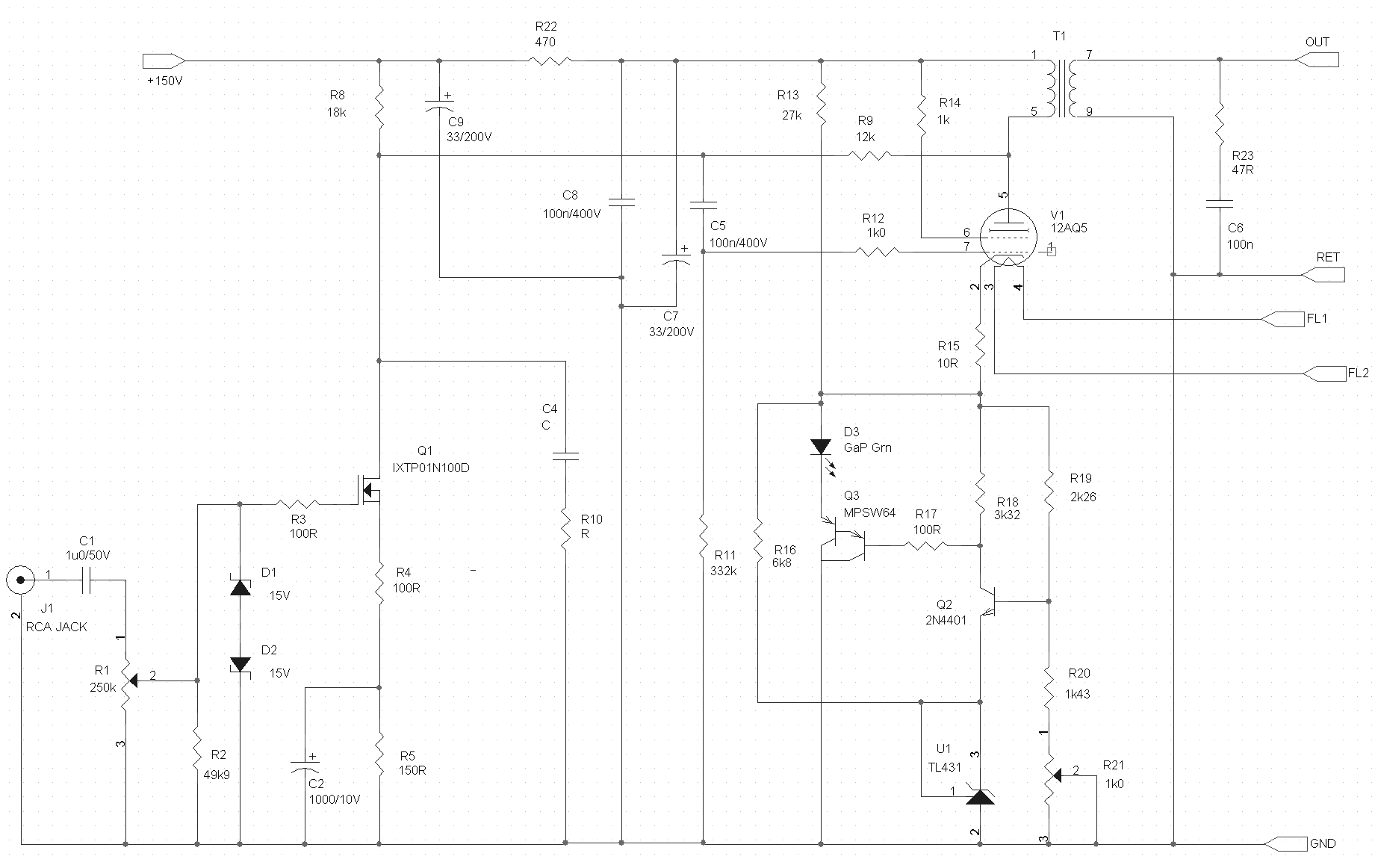

I currently appear to be getting away with using two 12AQ5 filaments in series, but I can't necessarily count on that.
If they are the same brand and construction they will be fine. Different tubes of the same type number are probably OK too. The real problem arises when several different non controlled tubes are wired in series across the line voltage. The fastest heating tube gets blown up.

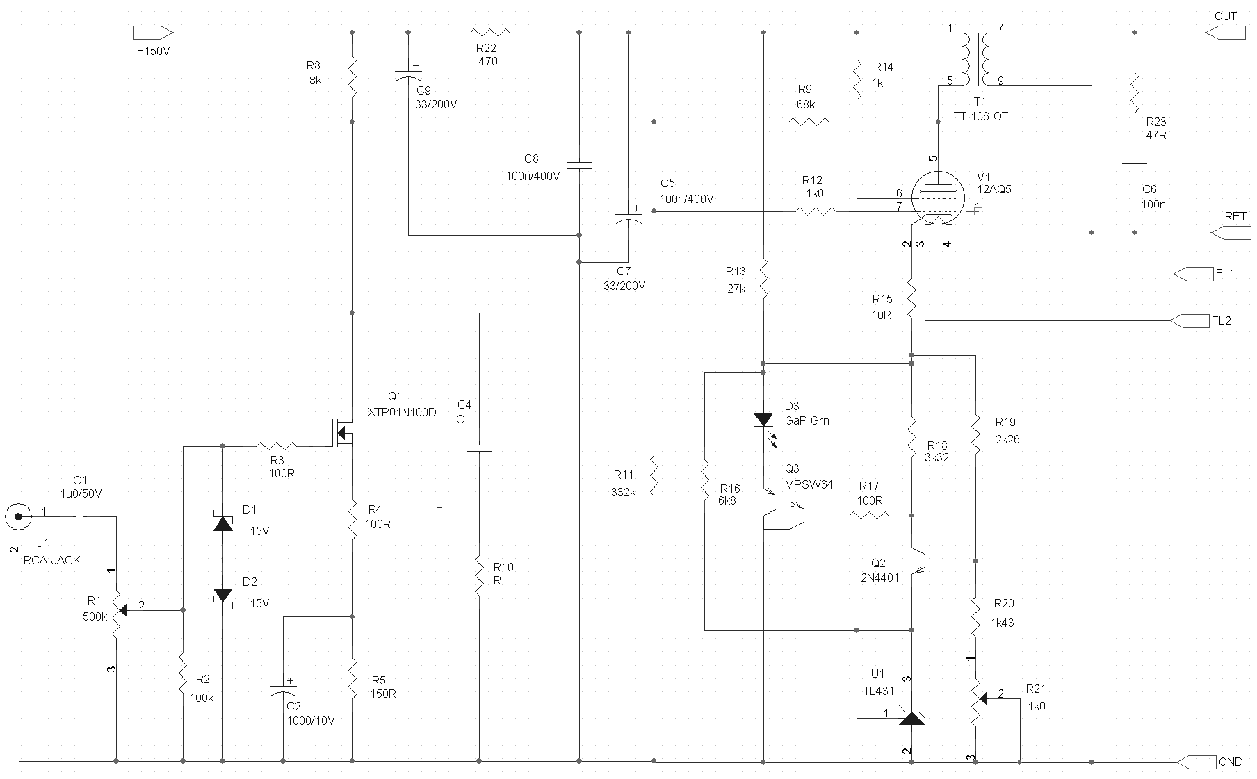

Here's the circuit I'll be dealing with for subsequent measurements. The 12AQ5 output tube is biased with a discrete shunt regulator with low impedance for maximum gain. It also gives me a lot of freedom in setting the output stage bias current without a lot of messing around..

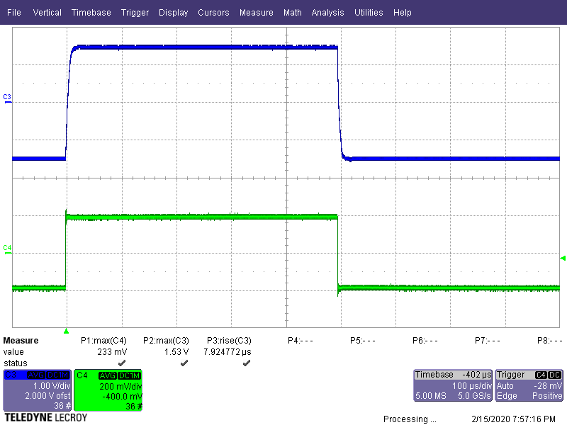

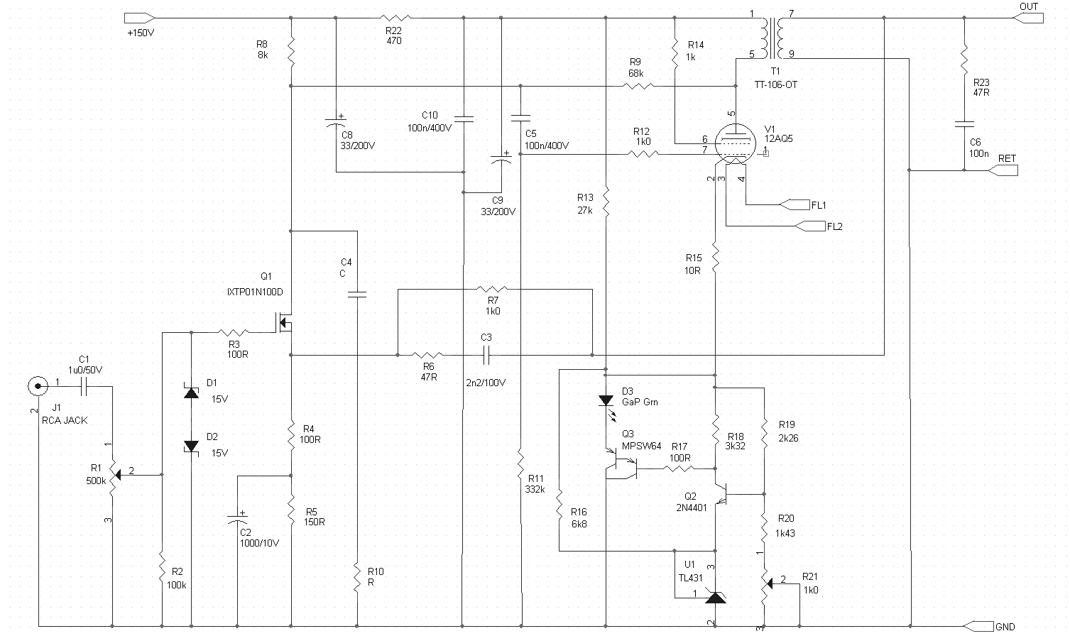

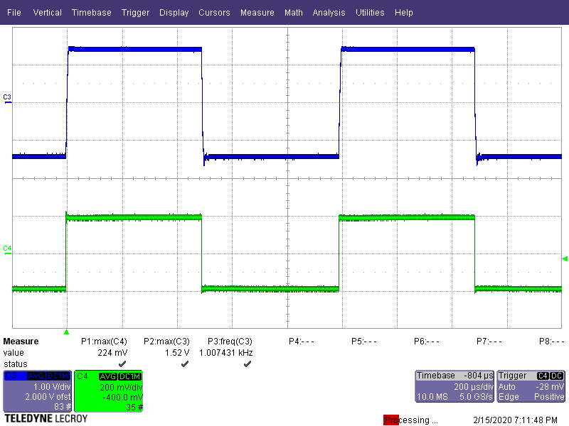

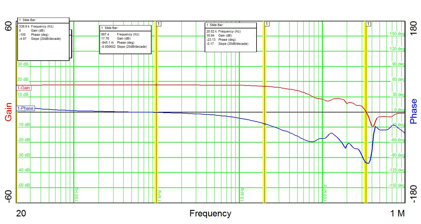

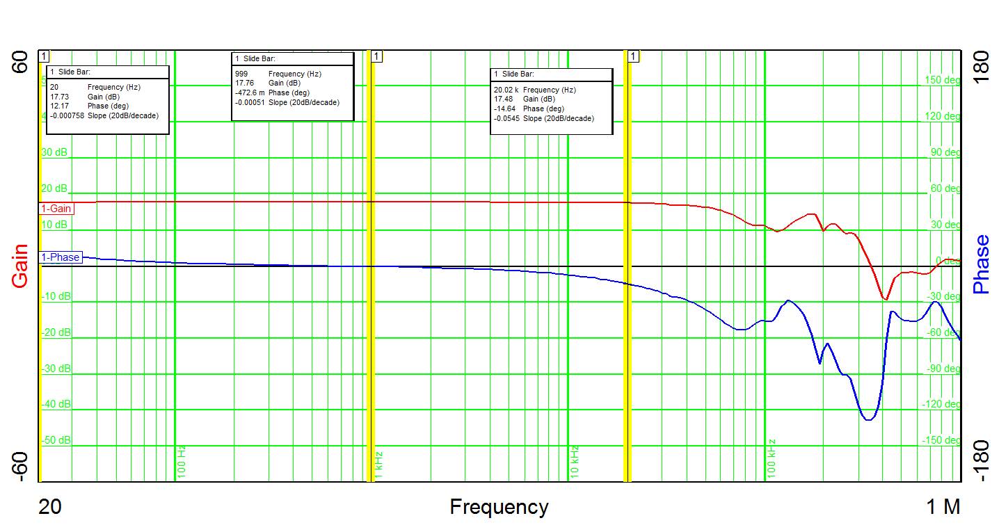

I've been doing some messing around with the basic design with the intent of changing with the inner feedback loop to provide some excess gain, allowing some global feedback to stiffen the transformer at low frequency.Here is the resulting circuit...

The one concern I have left is the tendency for the gain to try and re-cross 0dB at high frequency. For a closed loop system this can be problematic. I have the option of adding a cap from drain to ground on the input mosfet this might make the gain stay below zero at high frequency. However, last time I tried this, I damaged the input mosfets. Maybe a series combo of something like 47-100 p + 1k ohms will do the trick.
