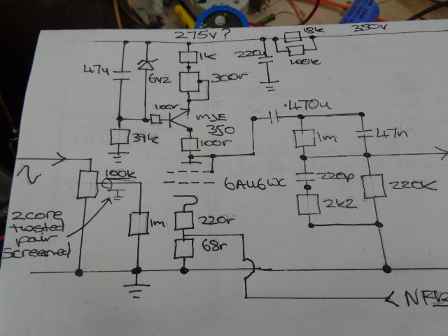

How can you get suck low THD when the 6AU6 alone gives more?
I am working ATM on a PPP 6L6 with a 6AU6 triode strapped biased @ 2 mA and I am getting 0.116% THD at the first stage alone.

I'd bet the bass shake your bones ? 🙂" Thanks, yes, it does have excellent bass but also V good F response. "Cancellation and feedback." Correct. "Also 0.116% THD from a 6AU6 driver stage could be excellent" It is, that sort of THD for an IP stage is fine, I have the 6AU6 triode strapped as you do but am using CCS as anode load. no grid stopper, no cathode bypass cap from memory.
I'll draw the schematic if you interested, I aslo have some NOS 6AU6's if you want a couple to experiment, yours FOC just pay the postage.

Hello Andy.
Yes I would be very interested in your input stage with CSS, as I think I can improve my amplifier response even further.

Thanks for all your kind words, much appreciated. I'll draw that up for you today.

Here's the schematic of the front end of these amps, it could probably be be better implemented but it works, you have to stop tweaking at some point.
One thing I might change is the gain, which is low, sensitivity is 1.5v, not ideal. The CCS I've used extensively on other amps, it's simple and works, but you could probably get far better OP Z by using another higher hfe tranny. I prefer to use a preset and fixed resistor as the Re as you can then adjust it to get operating conditions bang on.
The magubbins after the anode helps keep the amp stable, I lifted these value's from Pat Turner's various amps designs.
One last point if anyone is going to build such an amp, I'd highly recommend some sort of protection circuitry, I'm glad I did, saved my **** on numerous occasions when tweaking and testing the amp; very easy to leave a wire off on the prototype and lose bias or make a change resulting in HF oscillation. If these amps pull too much current the protection kicks in far quicker than a fuse.
Andy.
