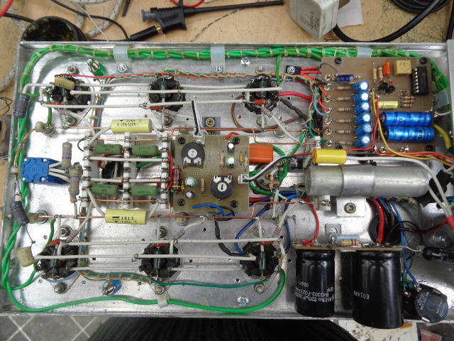

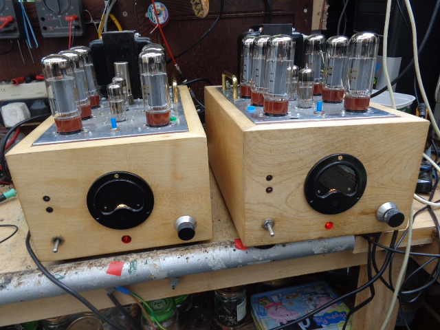

I've finally finished my first valve amp build, it's taken about two years. I built the amp once in one chassis, wasn't happy so started again.

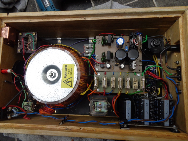

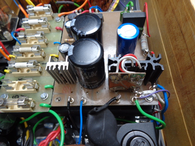

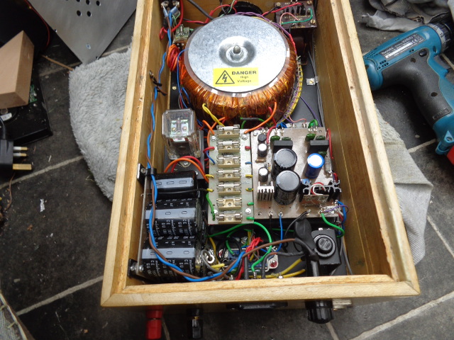

Each mono block has it's own PSU with a 625VA handwound/overwound toroid mains tfmr with 9 second soft start for the HT/B+. There is also two protection circuits so that that if Ik of each EL34 exceeds 100mA a thyristor engages a relay that cuts the neutral to the main tfmr as well as no speaker/load protection.
Specs - 0.01% @ 1w, 0.07% @ 10w, 0.21% @ 50w and 0.28% THD @ 112.5w this at 1khz. N/ripple = 20mV. F response 3dB @ 1dB @ 5hz, flat to 28khz, 3dB @ 33khz.

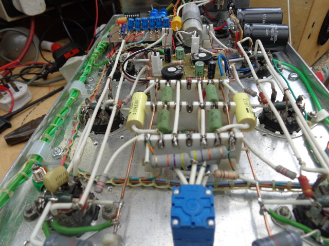

Valve line up 6AU6 triode strapped for the front end with CCS load, two ECC99/6H6N's as the LTP phase splitter with CCS in the tail.
OPT's are Hammond 1650TA, caps 105 deg mostly of reputable makes, Bourn pots, Vishay resistors so most components of good quality but not boutique.
Woodwork is sycamore, hand planed from a tree, took ages as my tools are very basic. Chassis handmade from 2mm ali sheet.
Lastly though the design of most of the amps is my own work I lifted quite a few ideas of Patrick Turner and also picked his brains via email, thanks Patrick. Anyone wishing to build high powered amps or any valve/tube amp should have a butchers at his site, an invaluable resource for tinkerers and artificers.
PSU - capacitor board, SS relay,chassis connect, etc.JPG160.3 KB · Views: 1,112

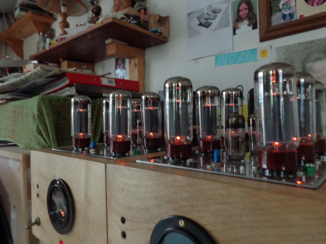

6.3v regulator, bias and soft start board and AC fuse board.JPG160.8 KB · Views: 464

Approp heater current for that 12 off EL34....I'm currently doing a parallel 3 using 6550 stereo 12 valves in all. I gave up the idea of DC heater for the output stages long ago.

Never was an RN artificer Rich, the name just popped into the old noggin one day. I wired the EL34's in two 18.9v windings, 3 EL34's in series, though it's hard to get bang on with a toroidal tfmr so actual voltage is 18.7v or similar.
AC htrs for the OP stage is fine especially if your OP stage is PP although I had to re-route my htr wiring, it did cause issue's how I had it before. Look forward to seeing your build.

On more oomph "With amps there's no such thing!" I agree in a way, apart from satisfying our inner kid with a box of matches and a stick of dynamite a bit more head room never hurt. These take 1.5v RMS to get the full whack out of them, my PC which is my main lazy music player only does about 1v RMS. With my Mission 720's which are about 85dB the volume controls are at about 12 o'clock for a bit more than average listening volume.
Also 120w isn't that mush more in terms of SPL than a 50w amp. They can do about 145w with a sinewave IP, but that's daft, you can hear the tone coming out of the OPT with a dummy load, snigger, where's the matches...

There lies the nub,..for real headroom, the pressure mounts. I used a 800-1kW mains transformer with my 250+250W using parallel p-p KT90's.
Identical stereo amps on the same chassis lends well with BTLoading, my case hey up to 500W. This is the sort of power a 4" voice coil starts working and what the frame of the house is made of..

power with music playing is substantially lower than 120 watts, this is because music has far lower energy content than a sine wave of the same amplitude used to arrive at that power rating....in reality a 120 watt amp amp derived using sine waves can be 40 watts using music....always remember this...
yes, most listening will happen in the 2 watt levels most of the time, getting to 40 watt on peaks of transients....

"power with music playing is substantially lower than 120 watts.... etc" exactly Tony, I remember popping a meter on the OP of an amp when I first started learning about audio electronics and being gobsmacked that average voltage was about 1.5v RMS, this with music being over comfortable listening levels. Even taking into account the difficulty of accurately measuring a complex waveform, it was a valuable lesson.
