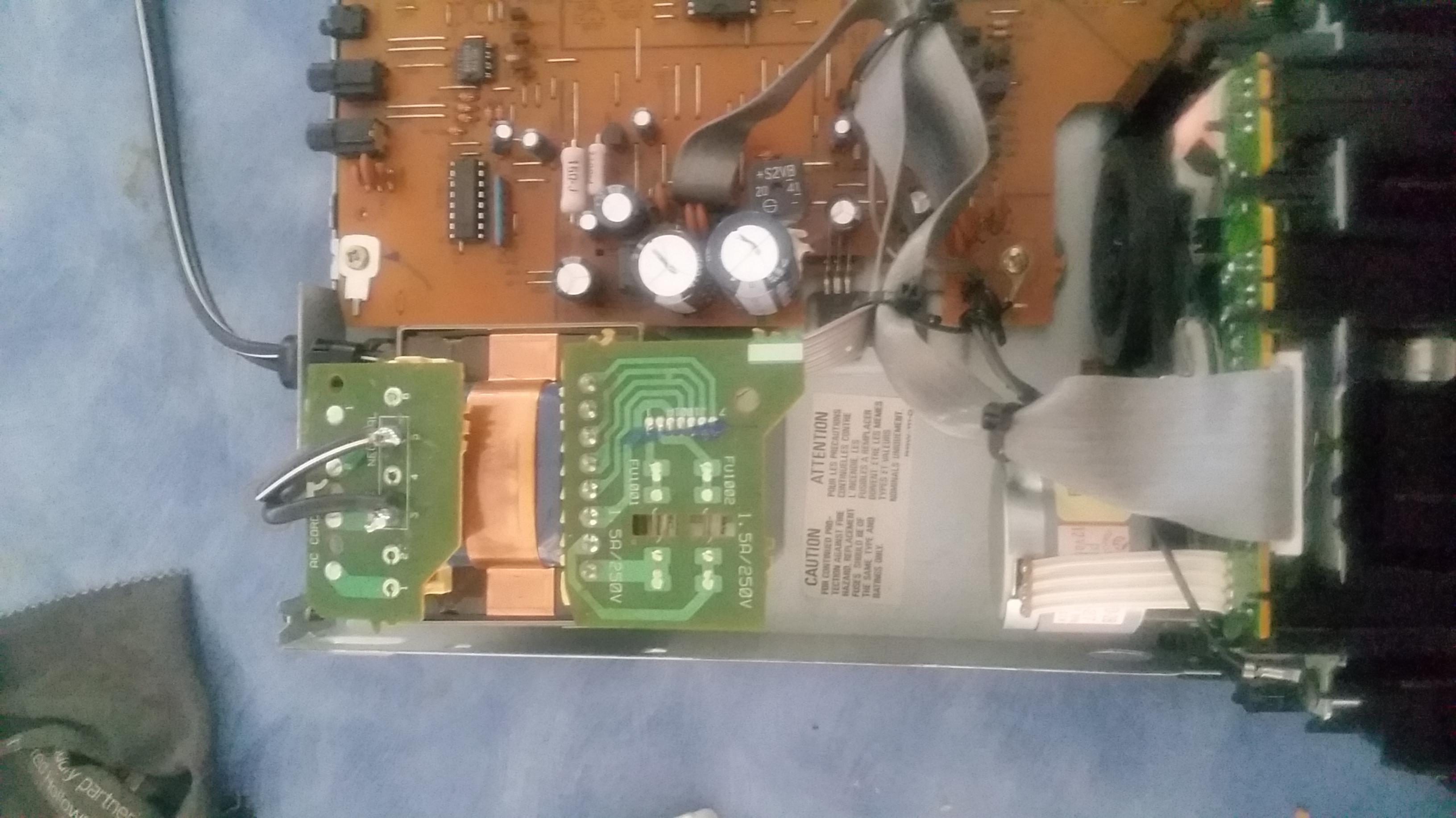

A pic.
added a pic of multiple tapped secondary on transformer.

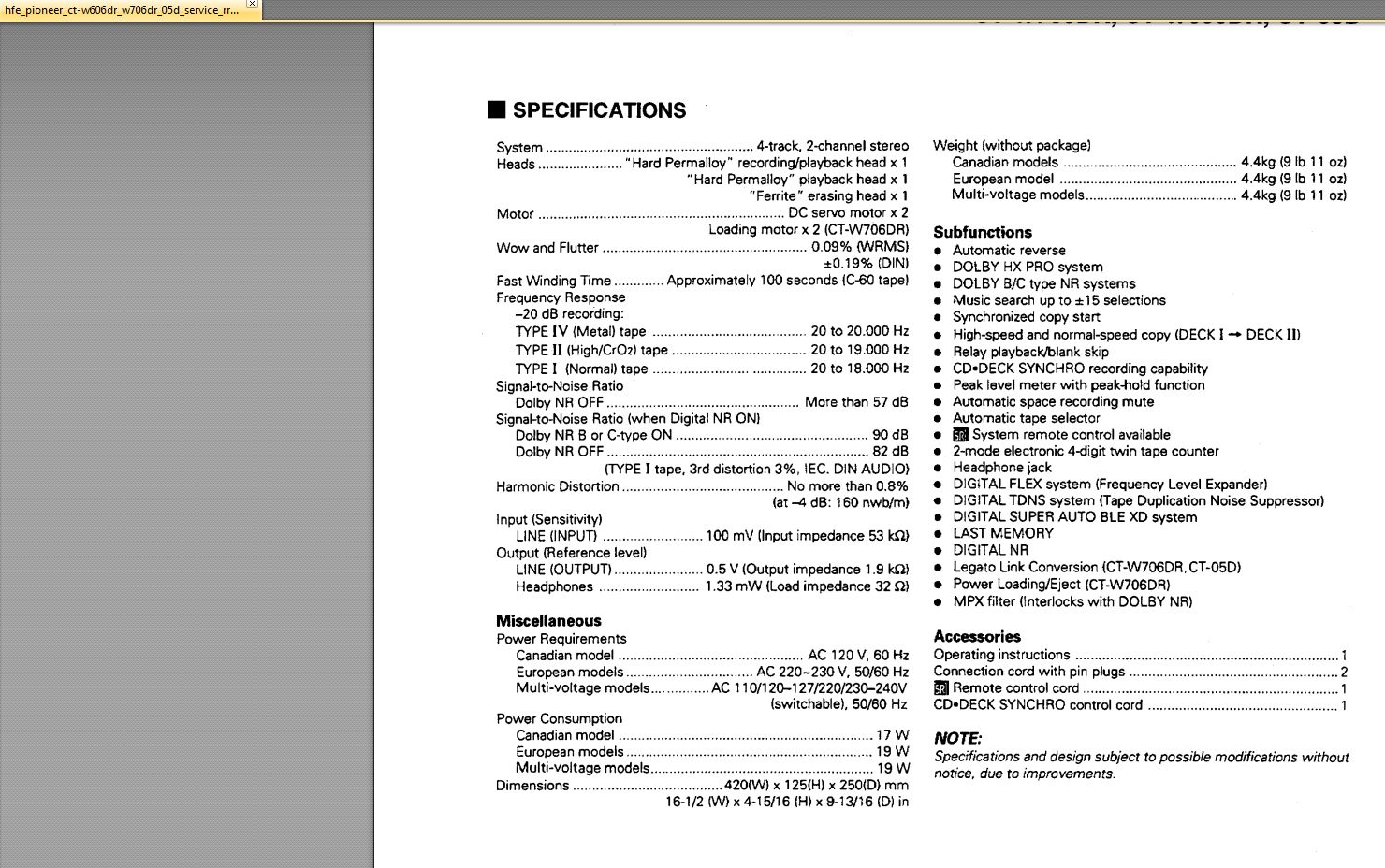

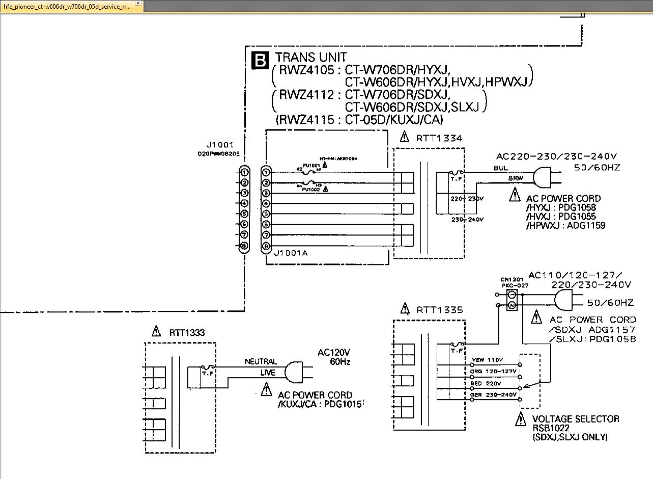

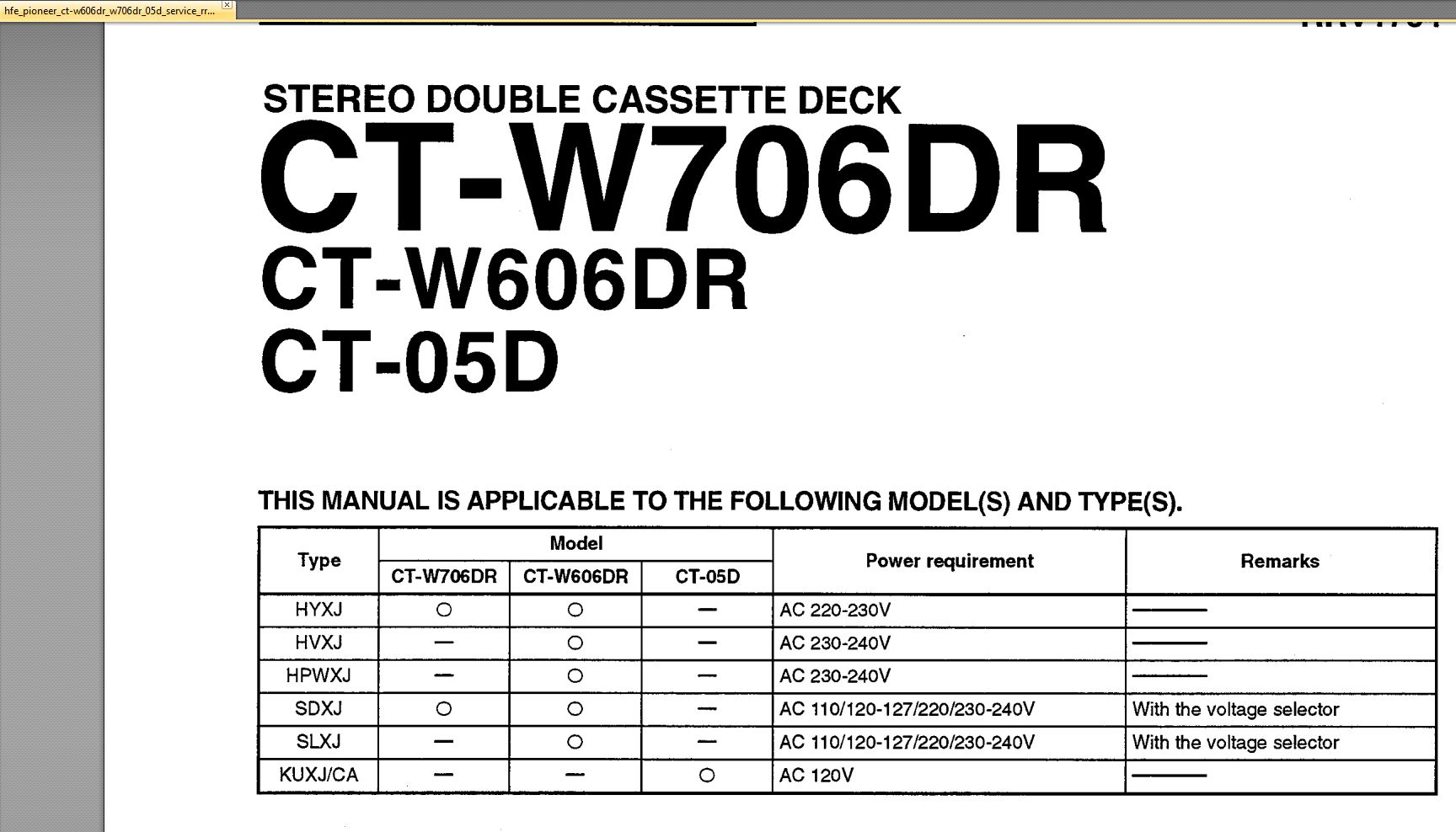

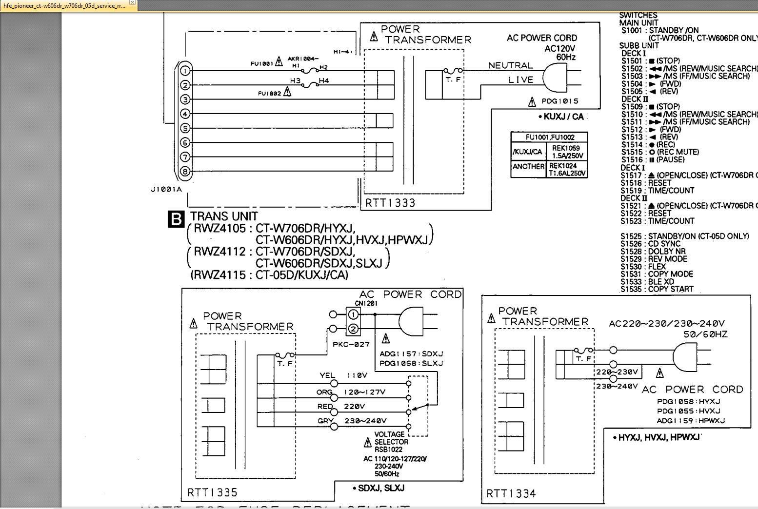

So these are from the 706.
which I'm willing to bet uses the same power supply.
So now we can all see they came in three versions.
120vac only.
220-240vac only.
or,
110-240vac multi tapped.
Pretty obvious now that if yours did not come with the multi voltage switch on the back panel.
Then your SOL.
You should've posted either the manual you paid for or at the least a screen shot (like these).

I dont know if your ref to 706 is different to the w703rs but all i know is that the manual tells me to change primary terminals. I dont seem to have the same numbers as it says and i havent managed to make sense of it.
I hope the picture helps you guys.

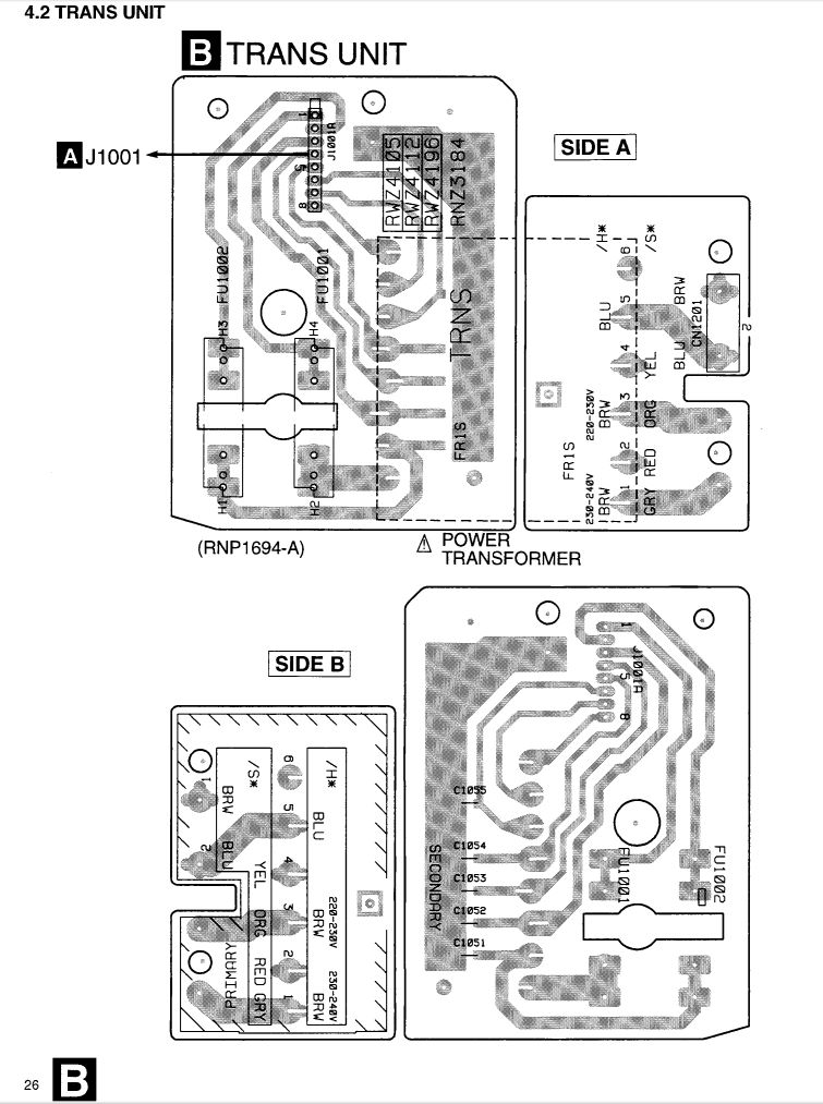

A couple of comments:
I suspect that the thermal fuse is between pins 5 and 6, and you have a single 120V winding between pins 3 and 6, so rewiring for 240V is not possible.
