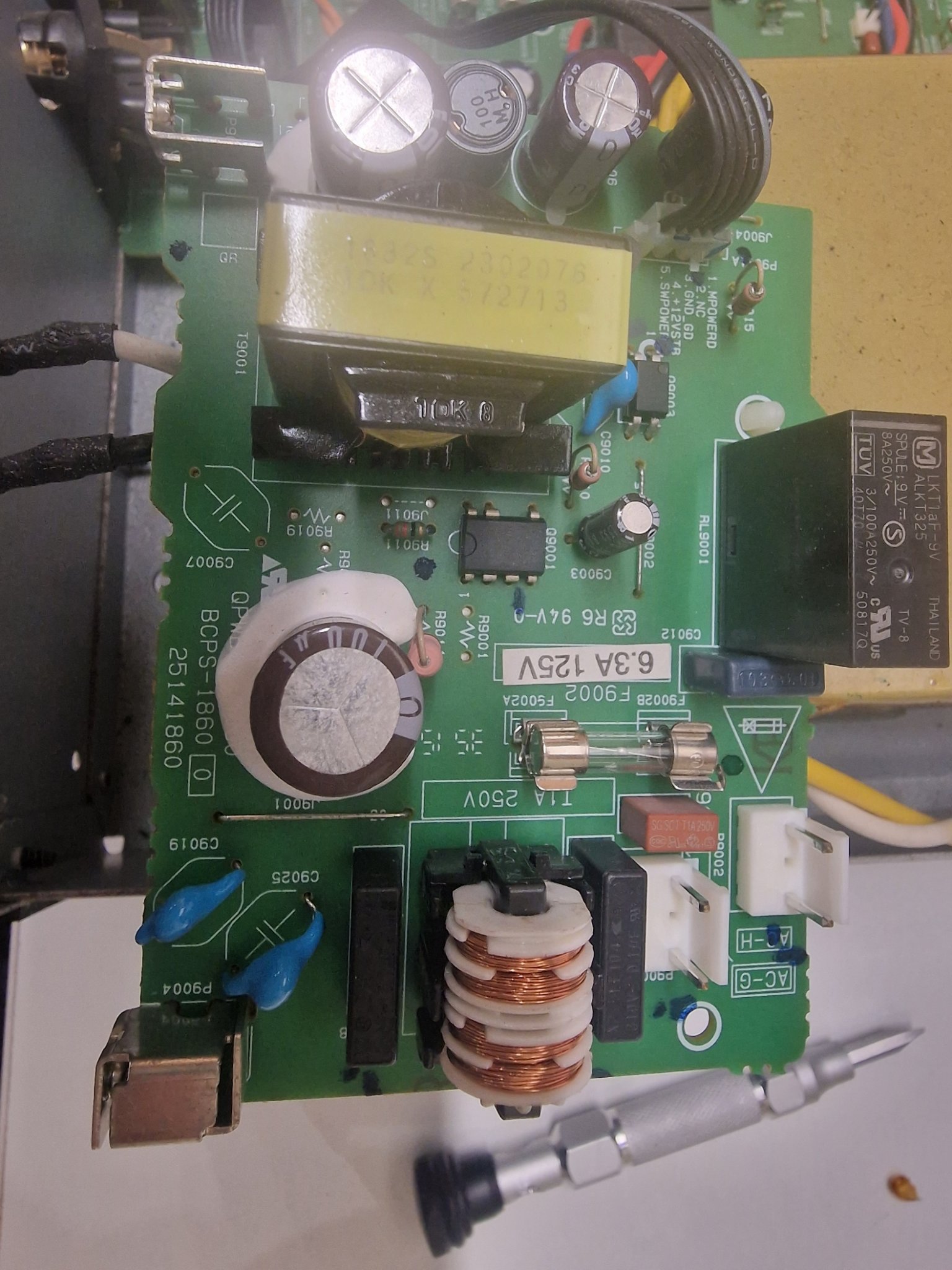

Given its age, SMPS is more likely, then a transformer for changing voltage would not really be affected by frequency, the SMPS will tolerate frequency changes on the primary side.
Some computer SMPS could be changed for voltage quite easily, neutral common, and one big cap for 110V, OR two for 220V operation.
I mean the big filters before the chopper transistors.

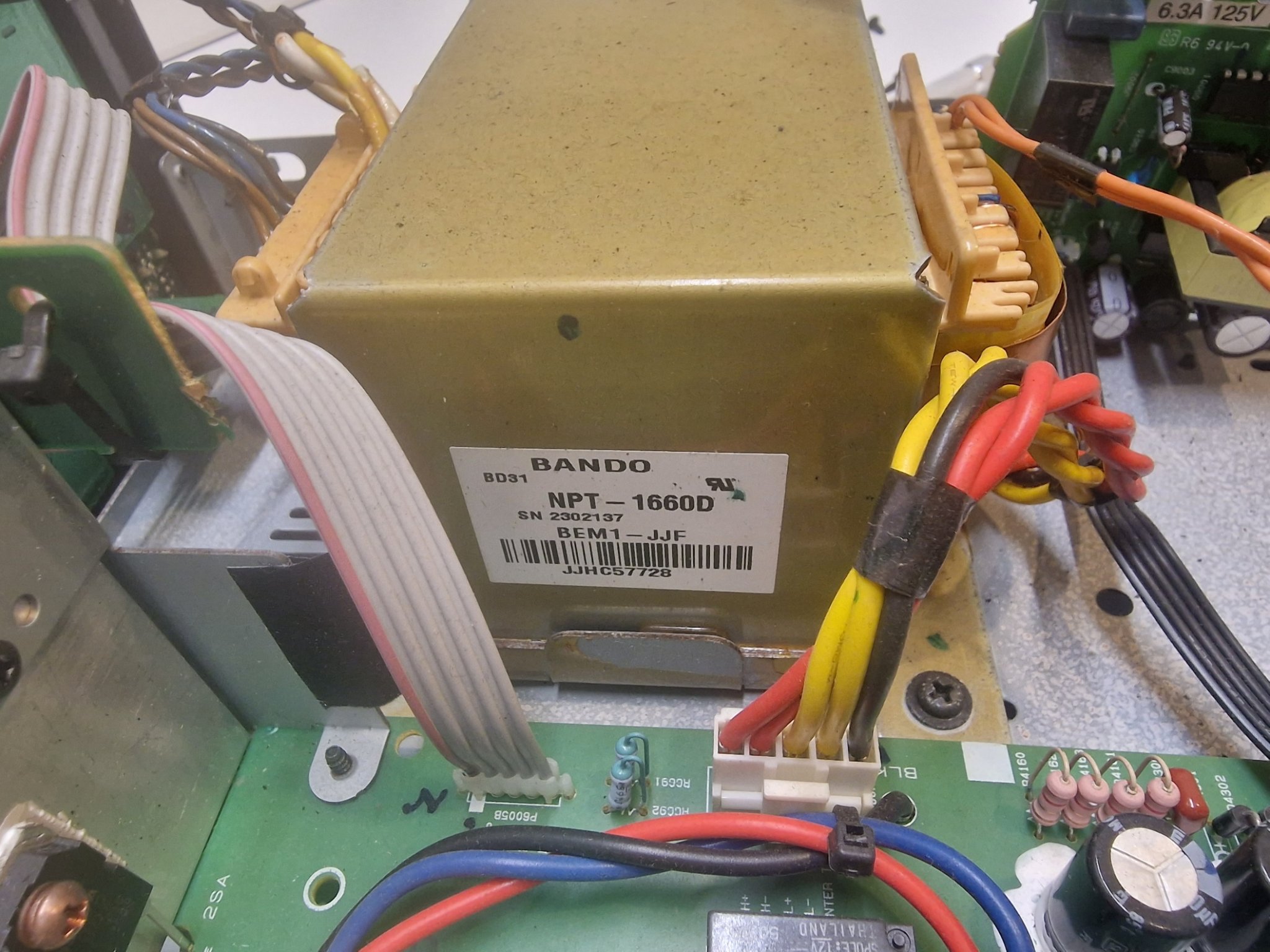

I am still stack on if that would be possible to easily convert unit to native 220V. Please see attached pictures, most of the PCB units are 250-310V but fuse is 125V. I was also not able to define the specification of transformer by it is part no. what do you think, by replacing fuse with 250V one may solve my issue?
