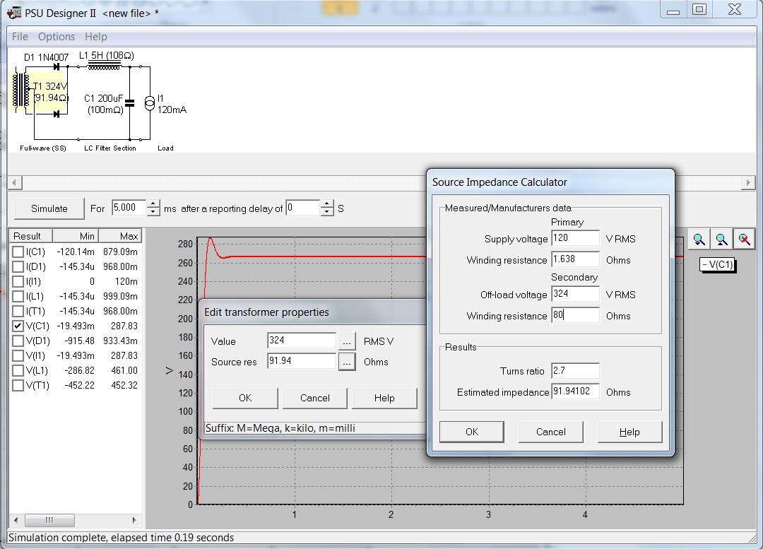

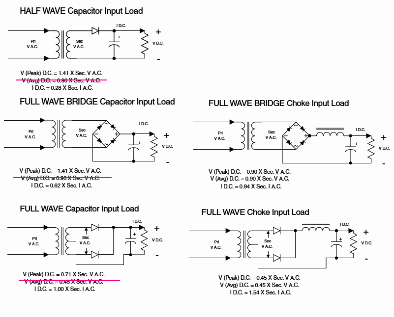

I had all but forgotten about the full wave choke input until reminded otherwise by Audiowize. My head all focused on bridge rectifiers and voltage increasing by a factor of 1.41. Since being reminded I have found links to the PSUD2 here on the forum, downloaded and run some tests.
I am not quite able to simulate my intended configuration, but I believe I should be quite close.
From parts I have at hand for my intended build I was thinking to have one choke and one capacitor per channel, each channel drawing a total of approximately 60mA once I have included the driver stage(s).
attached datasheet downloaded from Hammond webpage and my simulation for one channel.
Any clearing errors in my sim?
What are your recommended diodes for this setup? I was thinking UF4007 unless I am advised otherwise. I have a boxful of 100u capasitors available so no problems increasing capacitor by paralleling. What ripple is acceptable for a single ended 2A3 and is there an optimum capacitor value for my chokes?
Thanks in advance

You need to simulate under Load. And you need to use the little source impedance calculator on the mains transformer... Also, if the 100uF capacitors are recent production and reasonable quality, their DCR will be much lower than 2 ohms.
Full wave rectification with silicon using your choke input under constant 120mA load should yield around 265-270VDC. Check my example.

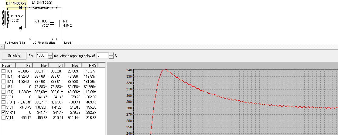

Also, don't forget that with silicon rectification, you get immediate full-on B+ voltage. However your 2a3 heaters will not yet be warm enough to conduct. It is not unreasonable to think 10 seconds for the 2a3 to start to fully conduct after heater turn-on.
This means that right at turn-on your circuit draws only a few mA's and the B+ will spike to a value much higher than in the above simulation. Somewhere around 350-400V is what you can expect it to spike to when using silicon rectification. This is not so good for many components, including your 2a3's...
I personally use television damper diodes to rectify since they start up slowly. They do result in an overall lower B+ than silicon, so I sourced my mains transformer accordingly.

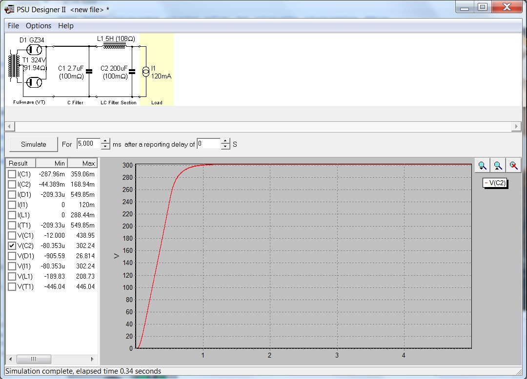

Anyhow, you will probably see that your intended B+ is less than you might have expected. So what to do?
Well, your mains transformer has a 5v 3A winding, so you could use the venerable GZ34 (5AR4) as a full wave rectifier. You will need to use a small cap on input to get the B+ up, but you could use a higher quality film in this position too. I like DC link capacitors, but motor-run capacitors are also highly regarded.
The GZ34 does not have quite as slow a start-up like TV damper diodes, but it will be much slower than silicon diodes.
Ian
