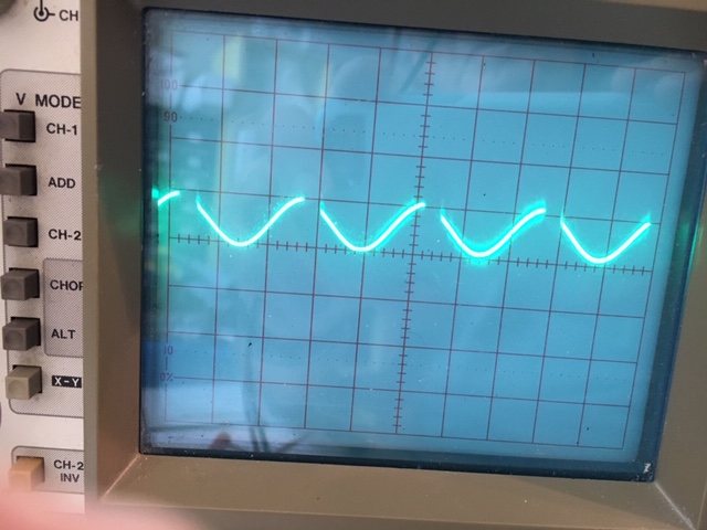

I am trying to find the source of the 120Hz buzz coming out of my speakers. At least I think it is 120. Anyhow I disconnected all input to the amp and connected the end of the speaker cable to one of the inputs to the scope. The other input to the scope has a 120Hz from a signal generator. Be aware that I am a total newbie to this and I don't really know what I am seeing on the scope from the amp. I expected a much cleaner picture.
So, am I going about this in the correct manner ?
If not, which is likely, please guide me.

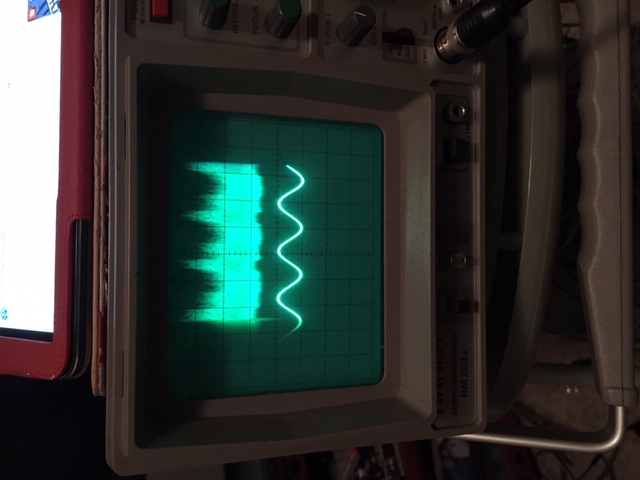

Thank you audio, but being the newbie that I am, I am not clear exactly how to do this. I have had it suggested to me before and it had me scratching my head. I have 2 posts dealing with the signal in.
They are:
1) SIG IN
And
2) SIG GND
Am I to run a jumper between these 2 or run a jumper from SIG IN and the chassis ?
Which piece of equipment is doing this ?
The picture shows a 1kHz test tone, except part of it is missing. If I fool around with the scope dials, I can see the missing segment of the curve about 2 inches above the rest of the curve.
Is this a problem with the scope or the signal generator.
Both devices were bought 2nd hand at swap meets.
Hi Hextejas,
I'll be a bit more specific in technique: I suggest acquiring a RCA phone plug and soldering a short between center pin and ground sleeve. That represents the best possible source--- 0 impedance, no noise, no ground loops.
I also suggest connecting a speaker to the amp. Then you'll be able to hear if the simple act of connecting your scope with its attendant safety ground introduces added hum. A last tip: your scope likely has a Line Trigger option that will ensure the scope sweep is synchronized to the power line.
Good luck!
One other thing is a ground loop because the scope will be grounded at the plug and at the scope probe. I was a bench tech for Marantz Aus many years ago and (did my apprenticeship there) and one of the old techs showed me to leave the probe ground off in some situations to prevent erroneous signals.
What BSST said about the input short and output stage load is correct. 120Hz is the 2nd harmonic of the mains.
Post 6 is that the output directly from the siggen? or the output from the amp.
Thanks Warr and I will try and get to this. I have been busy rewiring and relocating stuff. The sine curve that you see displayed is from a signal generator from an IPad.
After I relocated some wires and rewound them, it has gotten quieter so let me try the above suggestions.
Maybe you've already established whether the distorted sine wave is a problem in the scope or in the signal generator. If not, a couple of thoughts:
If the displayed waveform evolves as you manipulate scope range switch and/or position knob, it's likely a scope defect. If the shape remains unchanged as you change ranges, probably the IPad. Yet another idea for an independent test signal is to probe a 60 Hz signal within the amplifier's power supply and see if similar distortion presents.
I hope it's only the app. Good luck!
