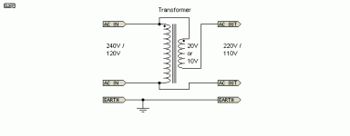

Dropping with a resistor does not give a stable drop. You need to use a 20 volt transformer of appropriate current rating to drop the line by 20 volts. It will not be as large as a 120 to 100 volt transformer.

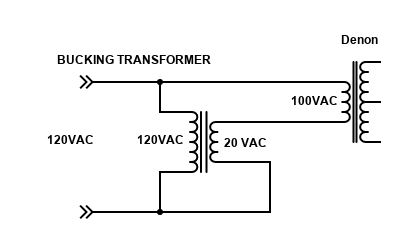

Hoping someone here posts a simple schematic before I start scribbling on a piece of paper.
Example of bucking voltage drop.
Reactions: K-amps and JMFahey

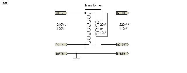

A VERY common problem in Brazil.
It has the largest amount of Japanese descendants (Nisei) in the World, and customarily Nisei kids travel to Japan for 1 year after finishing high school,so around 18-19 y.o. , to work at Toyota - Nissan - Sony - Yamaha, etc.
MANY bring back their rocker youth dream:"a Marshall!!!!" 😉 , which is almost impossi9ble to buy in Brazil (high Tariff barriers) and easy in Japan, just a couple Months salary.
BIG problem is they bring the 100V version, complicated because Brazil is slowly switching its nominal 110V mains to hot 127VAC .... amp head damage is widespread and the normal solution is a bucking transformer.
In that case, they use a 24VAC secondary one, easy to find over the counter, since they have to nominally drop 27V , go figure.
Same arrangement as shown above.

Juan,
Good idea, but it looks like only a 100 volt input winding. So a buck transformer is the best way. I would not try to replace a turntable transformer as isolation and shielding requirements are quite stringent.
However I would measure the actual AC line voltage as it really is above 120 volts in many U.S. places and then use probably a common 24 volt transformer to buck it. Schematic seems to me to be able to tolerate a slightly low voltage. However I personally would use an 18 volt transformer and add a few turns. However that seems a bit beyond most.
