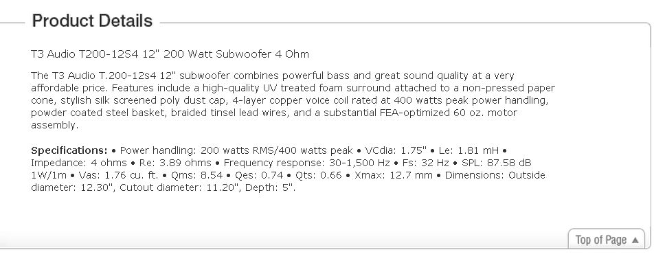

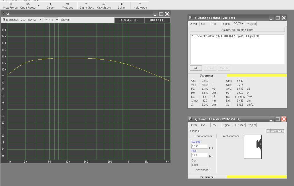

Did you model the parameters on the PE description or that ones on the box.Aside from the good ole' Daytons maybe 2 or4 of these would fit the bill,
T3 Audio T200-12S4 12" 200 Watt Subwoofer 4 Ohm 269-086
Or even 8 of them for $280 !!!
High power handling and a great Xmax at 12.7mm.
They model very nicely in Winlsd !!
FWIW
jer 🙂
Read the 3rd review down.
For some reason PE won't let me see some of the reviews even though there is four of them.🙁
I used the ones they have spec'd in the Ad.
jer 🙂
P.S. Oooops,I may not have modeled that one yet as I don't see it in my drivers list.....Sorry!!
I do like the specs though.
I will model it shortly and if there are some different parameters please post them as I can't get to the reviews.
Thanks !!

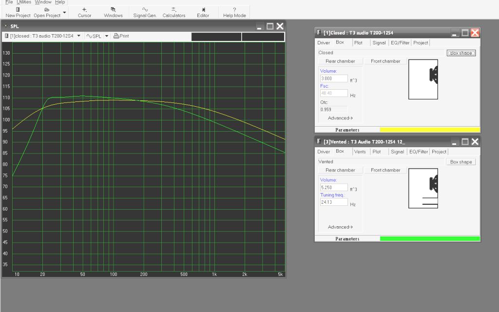

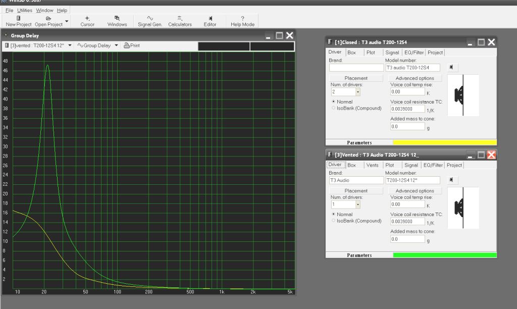

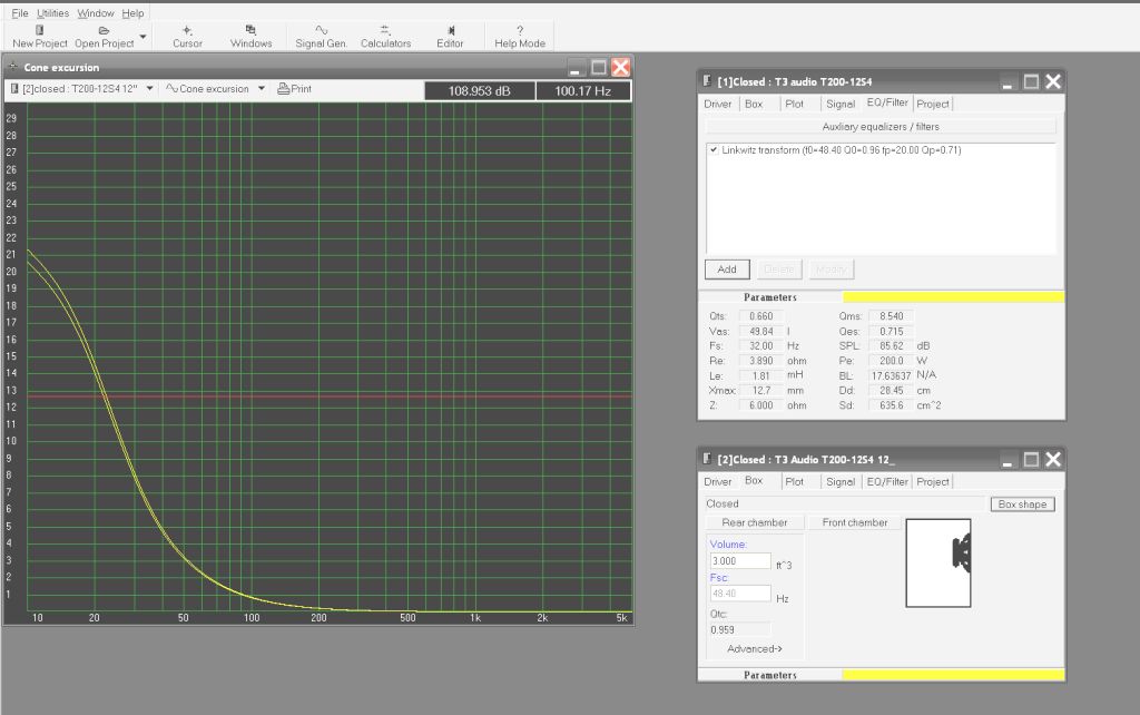

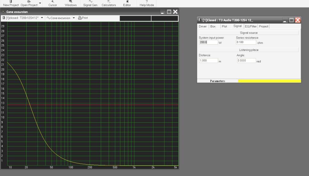

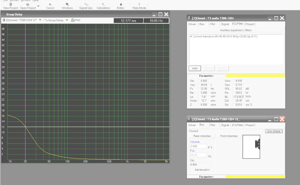

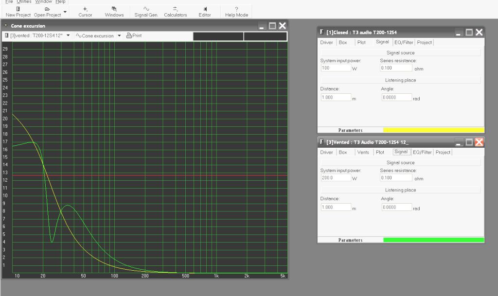

Correction I did model it as I thought I did I just used a different name for it.
Here it is with two in a sealed 3 cubic foot enclosure at 100 watts with a Linkwitz Transform Filter on it.(yellow line)
You can get similar results with one in a ported enclosure at 200 watts without the filter in a 5.25 cubic foot tuned to 24.13Hz with less excursion. (green line)
But with a higher group delay at the low end.
In a small room with the room gain you probably won't need the filter or at least not very much of it.
jer 🙂

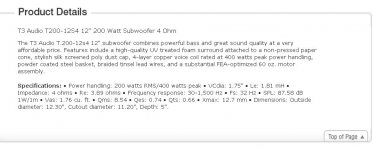

Apparently, this is what is on the box...
FR 25-250, Fs- 32Hz, Qts- .79 Vas- 70lt. Spl 86.5 db VC diameter 1.5"
They don't give a Qes....

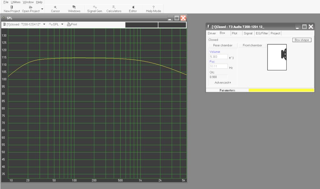

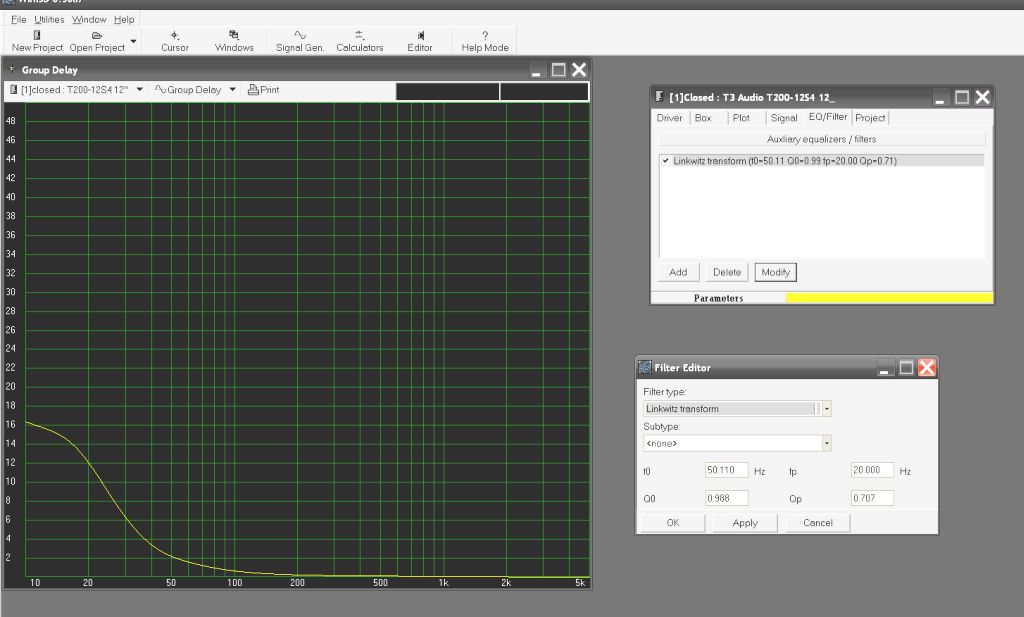

Anyhow I did three more sims to show if you want extreme on a budget it can be had with this driver.
Here is 4 drivers in a 5.3 cubic foot sealed enclosure at 200watts and again with a Linkwitz Transform filter.
That is only 50watts per driver so there is no chance of blowing these out by their spec's.
Two of these cabinets will put you at 121db with room to spare and nearly flat to 25Hz.
You never stated how high of an SPL you are shooting for and no single 12" driver can get that loud that low as it takes a lot of displacement to do so.
Especially at 30Hz and even more just to get to 20Hz or without having a very large enclosure and driver !!!
I am not trying to sell you any particular driver as that is your choice.
I am just showing you what could be done and still have quality and performance within the $300 budget that you have stated.
FWIW !!!
enjoy !!
jer 🙂
