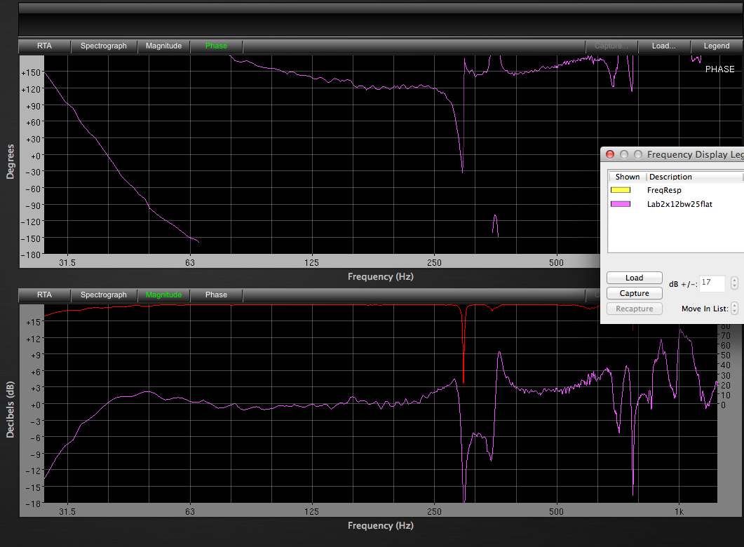

The Eminence Lab 12 is a good value, and does quite well in the 35 to 300 Hz range.
It has almost double the Xmax (6 dB more output potential) and costs less than the Beyma12B100R you listed.
The screen capture below is an outdoor half space 2 meter measurement of a 5.9 cubic foot Lab 2x12 cabinet with a 36 Hz Fb, no damping material at all as it is normally crossed over at 100 Hz. A BW24 low pass filter was engaged, but it does little to the LF response.
The peak and dip around 315 Hz is a port resonance which could be reduced or eliminated with some dampening material.
The response would be the same with a single 12 in half the cabinet size.
Depending on the crossover used, the port resonance may not be a problem crossing at 300 Hz, since it is mostly a dip in the crossover range.
Art
