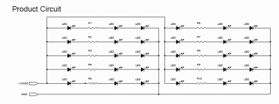

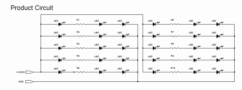

Just checked.
http://optekinc.com/datasheets/ovq12s30b7.pdf
I had imagined some FET constant current circuit or equivalent, but I'm quite disappointed, they're just strings of 3 Leds in series with a plain resistor, as low tech as can be.
So you don't need a regulated supply at all, even less a very inefficient and expensive linear one.
I'll start using Led strips to add personalized light to my machines work area (PCB drill, punchers, transformer winding, etc.) and I'll just use a 12V AC transformer, bridge and 4700x16 filter cap to get raw 15/16V and add the proper resistor so the strip gets 12V , not because it's *that* critical but to avoid unnecessary overheating if too high, weak light if too low.
But I guess that staying within +/- 0.5V around 12V will be fine.
Much easier than a 30A regulated supply.
Of course, a standard or modded PC SMPS will work fine within its rating.
