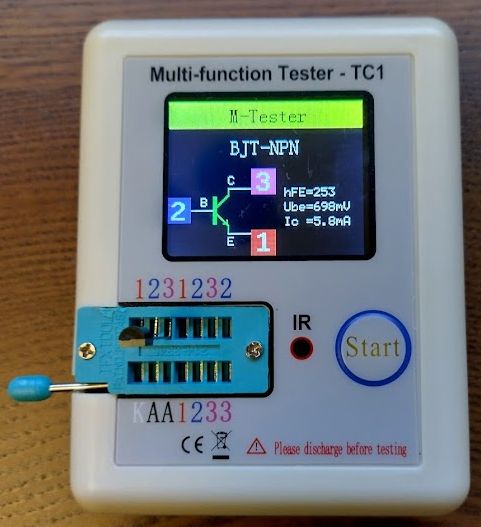

2) Using an NPN transistor or a MOSFET. I happen to have a small electronics kit that came with TO-92 (?) packaged NPN transistors that are labeled as "PN2222". AI says they're good. Print on the actual component says "2N 2222A -1726". The guide goes like this:
This result conflicts with what the AI was telling for legs. With the flat side of the transistor facing me (down in the pic), the legs should be from left to right: EBC, right? It's difficult to see in the pic, but that's how they go into the testers numbered slots. Anyway I see the letters NPN, so it's correct type?

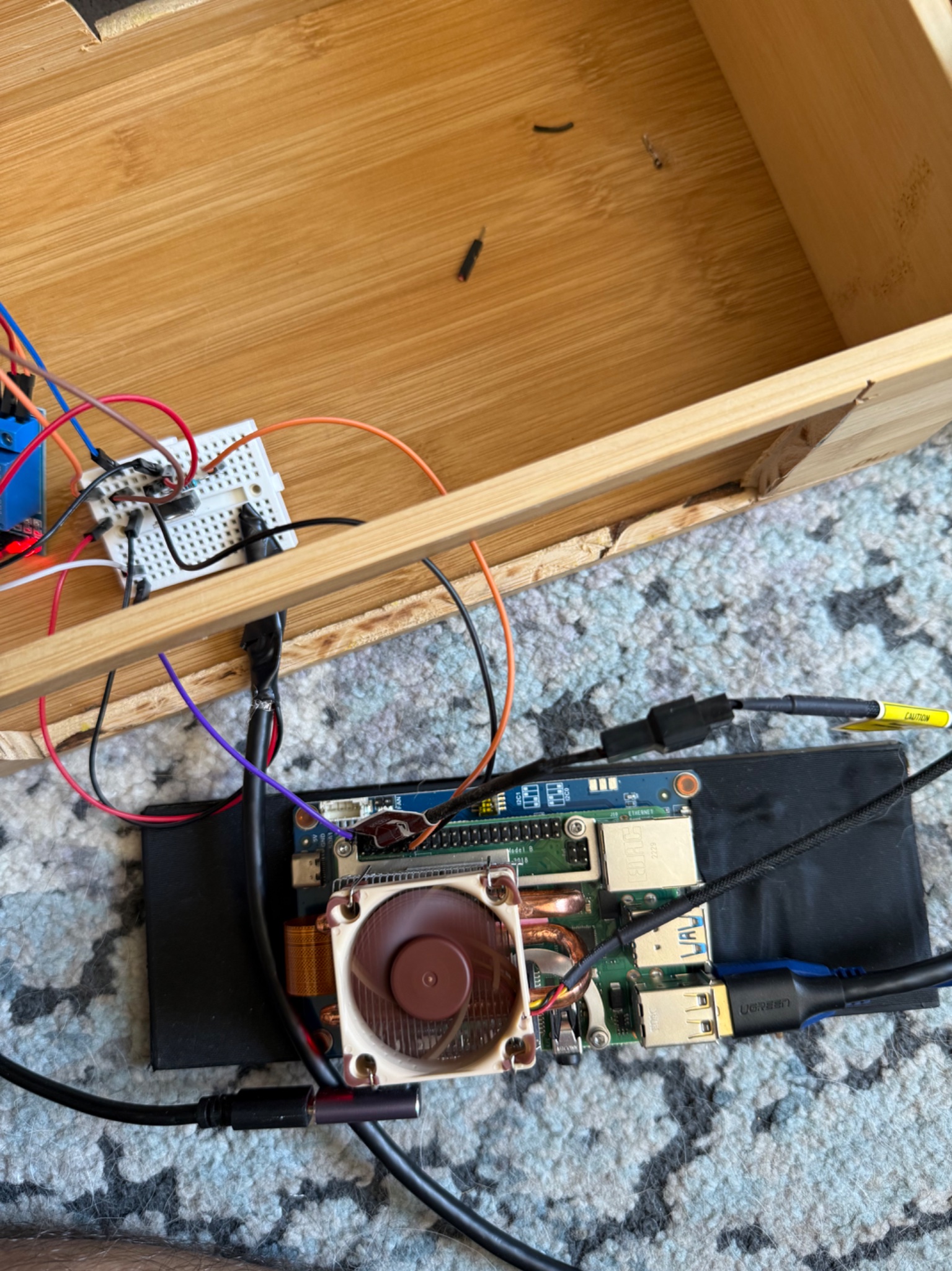

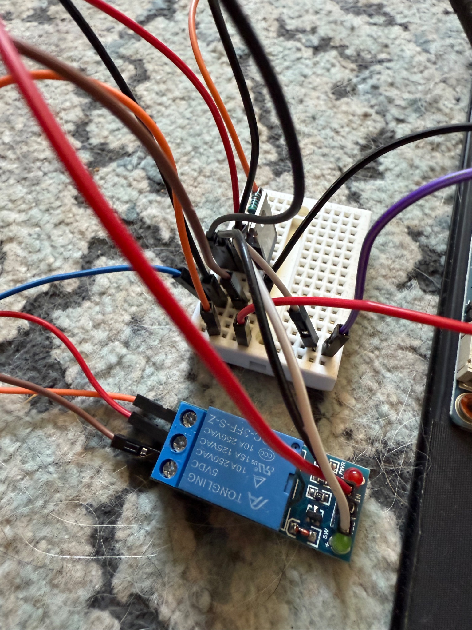

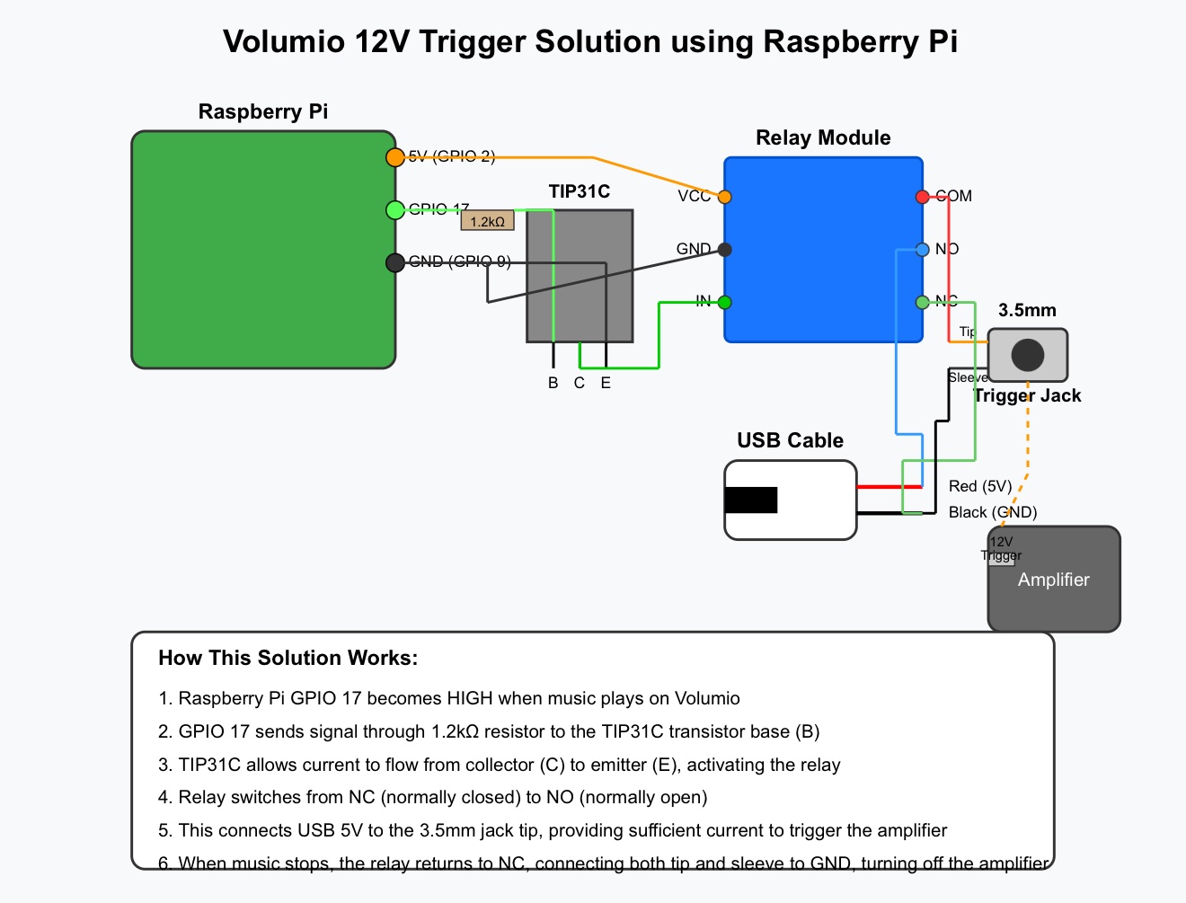

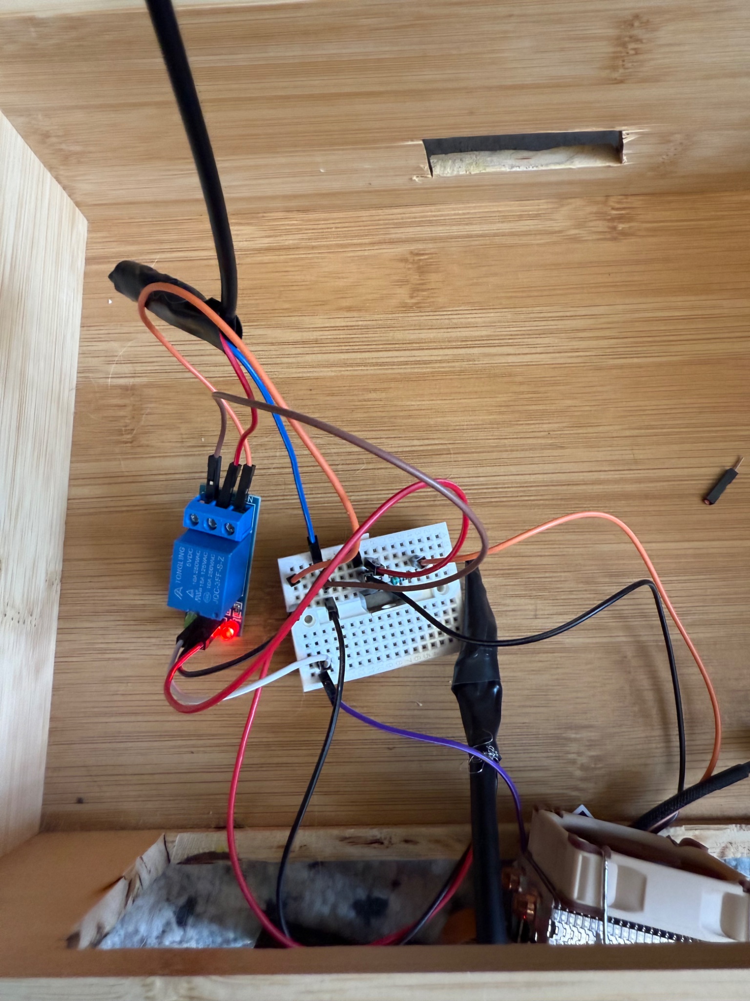

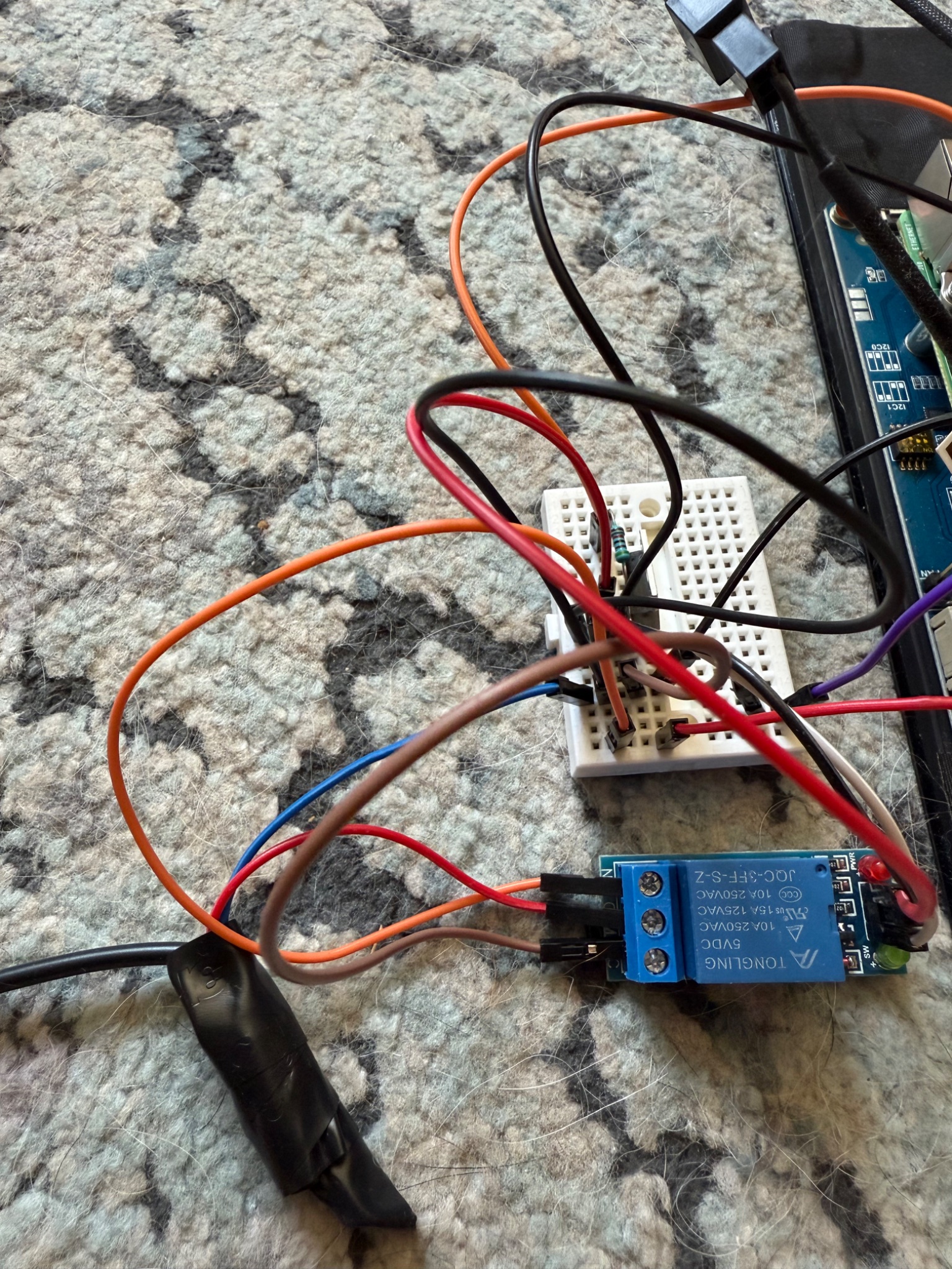

Hello everyone! I’m new to this forum, but I struggled with exactly the same issue and I finally solved it, using kind of both solutions presented here (USB cable to power the 12v trigger port combined with a relay). Here is the solution I posted on another forum from the OS manufacturer for my network streamer. I’m not a native english speaker, so I asked an AI to polish my explanation:
This circuit allows a Raspberry Pi running Volumio to automatically turn on an amplifier when music starts playing and turn it off when music stops, using the amplifier's 12V trigger input.
### Components Used
1. Raspberry Pi running Volumio OS
2. TIP31C NPN power transistor
3. 1.2kΩ resistor
4. 5V relay module
5. USB cable (cut open to access power wires)
6. 3.5mm mono jack cable (to connect to amplifier's 12V trigger input)
### Connections Explained
#### Raspberry Pi to Transistor/Relay Circuit
- GPIO 17 → 1.2kΩ resistor → TIP31C Base (B)
- 5V pin (GPIO 2) → Relay module VCC
- GND pin (GPIO 9) → Relay module GND and TIP31C Emitter (E)
- TIP31C Collector (C) → Relay module IN
#### USB Cable to Relay Contacts
- COM terminal on relay → 3.5mm jack TIP (one wire)
- NO terminal on relay → USB 5V (RED wire)
- NC terminal on relay → USB GND (BLACK wire)
- 3.5mm jack SLEEVE (other wire) → USB GND (BLACK wire)
### How It Works
1. When Music Starts Playing:
- Volumio sets GPIO 17 HIGH
- This activates the TIP31C transistor
- The transistor completes the circuit for the relay coil
- The relay switches from NC to NO
- This connects the 3.5mm jack TIP to 5V (USB red wire)
- The 5V potential between TIP and SLEEVE triggers the amplifier
2. When Music Stops:
- Volumio sets GPIO 17 LOW
- The TIP31C transistor stops conducting
- The relay returns to NC position
- This connects the 3.5mm jack TIP to GND
- Both TIP and SLEEVE are now at GND (0V difference)
- The amplifier detects this and turns off
