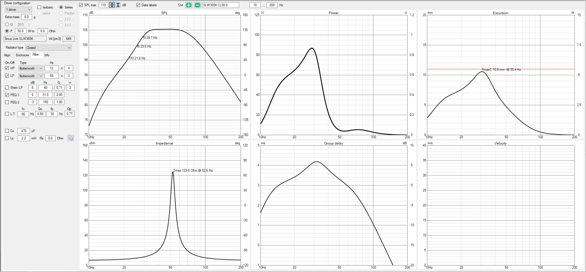

I plugged the above set of Thiele–Small parameters into VituixCAD's enclosure modeller. Then I selected a 50-litre closed-box enclosure.I have a Sinus Live 12 inch subwoofer, an SLW365K, and a hypex DS 4.0 plate amp and I’m trying to put together a sub for hi-fi, basically a 2.1 to go with some monitors I built.

Looking through the (short) Hypex DS4.0 plate amplifier users manual, I was able to determine that it provides a 3rd-order 18dB/octave low-pass filter, which I assume is a Butterworth topology. There is also a 4th-order 24dB/octave high-pass filter set to 12Hz, which I also assumed is a Butterworth topology.
The DS4.0 also has a "Bassboost" EQ capability, where the frequency can be set between 20Hz and 50Hz, and the boost level can range from 0dB to +6dB. For the purpose of the VituixCAD model, I assumed that this EQ can be modelled as a parametric EQ with a Q=2.0, and the frequency and amplitude can be dialled in by the user.
An example configuration is shown below. The low-pass filter has been chosen to have an acoustic −3dB point of 80Hz. The low-frequency response is −3dB at 28.7Hz, which seems a quite good result. Here the plate amplifier is set to provide a nominal input of 50W re 8 ohms, and a peak driver excursion of about 11mm is reached at that power level.

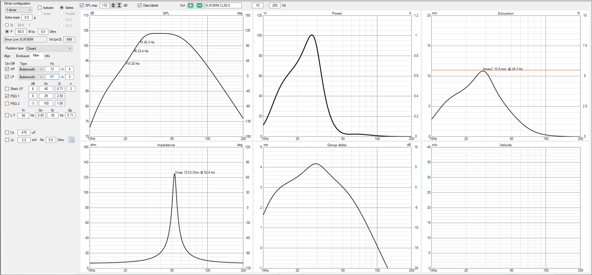

Below is a slightly different configuration, where I have aimed for the response to be −6dB at 80Hz. This allowed me to slightly reduce the frequency of the Bassboost EQ from 31.5Hz to 29Hz, which has also lowered the −3dB low-frequency cut-off to 26.3Hz. There is a small drop in overall output as a result of these changes.
