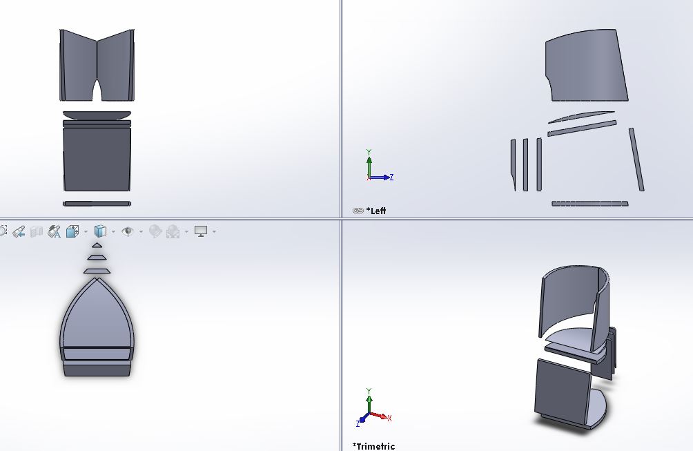

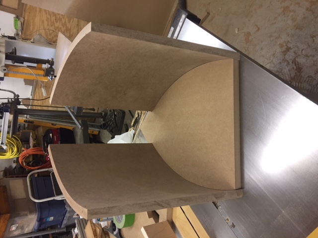

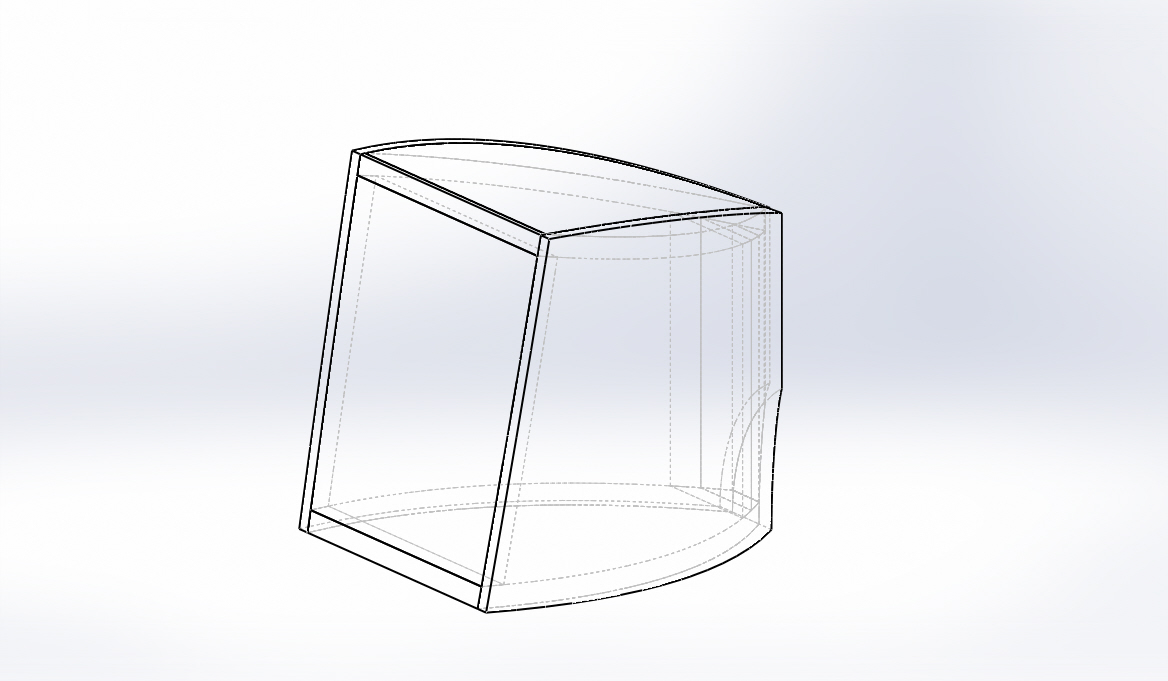

I just finished construction of two 12" sealed subs with a bit of a funky shape, due to the shape I cannot get an exact internal dimension of the finished project. My design should have yielded a 1.4cu ft box without accounting for the driver, internal bracing, and on the fly construction changes.
WinISD says I should have a 1.375cuft box.
Driver is Dayton Audio RSS315HF-4.
Amp is a Behringer NU1000dsp
I have them crossed over at 40hz and used subtractive EQ to net a flat response from 20-40hz. Thus was done via REW using a Dayton Audio calibrated mic. I have not performed rigorous testing, yet.
I have been listening to them for the past week and very pleased; even my wife noticed the change as a positive. Usually she thinks I'm nuts.
I am really wondering if I need to use polyfill in these boxes.
- When I first loaded them I put in 1lb (loose) in each cabinet (Which really filled them up).
- Last night I opened them up again to caulk all the interior seams, this time I only put in 10oz of polyfill per cabinet, which visually seems a bit more reasonable.
All my listening has been with 1lb in each, tonight will be with 10oz each.
The real questions are:
- how do I know if I even need it?
- would some result in REW (I'm a novice) indicate I do or do not it?
- since WinISD suggest a 1.375cuft cabinet and my cabinets are within a few percent of that size, should I need it?
I am not going to share photos of the speakers until they are completed, right now they are still in rough shape and not veneered. I have attached a couple photos to give you an idea what I am working with.

Great driver. I run mine in a sealed cab about twice that size and once equalized to correct the levels of the over damped alignment, they give the best bass I've ever heard. I would stuff that box completely to increase effective cab size. You will give up a spec of max spl, but the tight bass is worth it. Although really that small change in alignment may be barely audible so we're kind of splitting hairs probably.

1, in a subwoofers, I believe that is the sole purpose. In a cabinet operating at higher frequencies, the fill absorbs standing waves. But at sub frequencies, there are no standing waves because the wavelengths are so long compared to the cabinet dimensions.
2. No, I don't think it's required if volume is already right. I'm sure someone else will chime in if I'm mistaken on that.
My point was that I believe that the bass quality is better in a larger enclosure for this driver, so optimal according to what the model says, doesn't give you the full story as far as bass quality.

I came up with dozens of cabinet designs but nothing that I, as a woodworker, could be proud of. I wanted to build something I could be proud to show off, not just a box.
The cabinet shape was inspired by the boat tail Austin cars. Cabinet shape is the rear of the car while the 10* angle of the face is akin to the raked grill.
