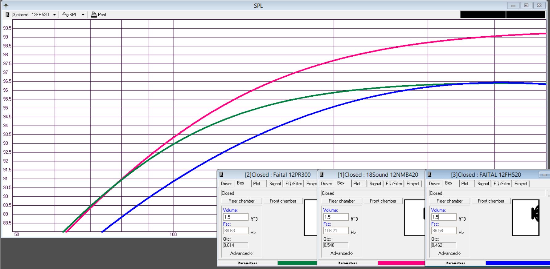

Qtc is the total Q of the speaker in an enclosure including all system resistances. A Qtc between 0.6 - 0.7 is considered desirable.
A Qtc of .707 generally produces the flattest frequency response with approximately a 12dB/octave rolloff which can smoothly combine with common 12dB/octave crossover circuits. A higher Qtc can sound more dynamic and generate higher bass SPL, but less cone control generates more overshoot / undershoot distortion. A lower Qtc can sound more accurate but generates less bass SPL with lower cone displacement for a dry sound.

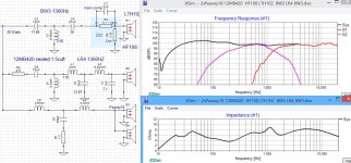

In 1.5 cuft sealed volume: 12PR300 has Qtc=0.61; 12NMB420=0.54; 12FH520=0.46; Most designers would reduce the rear volume to create a Qtc ~ 0.6.
The 12PR300 can drop in with a 200Hz baffle step crossover.
The 12NMB420 would favor a slightly smaller volume, with a 200Hz baffle step crossover after some attenuation.
The 12FH520 would need a smaller volume, with more a complex crossover circuit(shape) for a 200Hz baffle step goal.

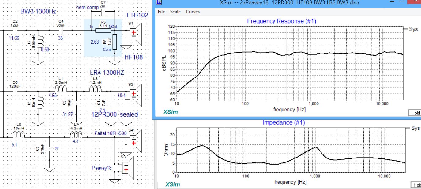

Example 1300Hz crossover for HF108 with LTH102 attached. (24" wide cabinet used in sim)

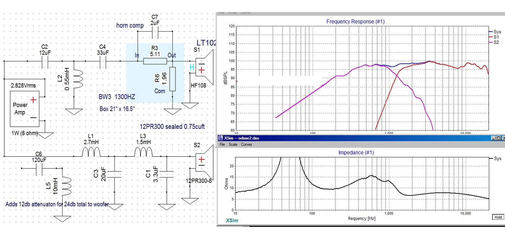

i noticed today that the 4 ohm version of 12PR300 had 10g higher MMS than the 8 ohm so i ordered the 8 instead today .
i can easily mount a removable coverplate over the innerwall and then im down on 1 cuft and a Qtc of 0.70 so i can listen and compare ..

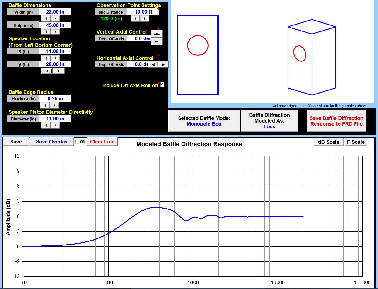

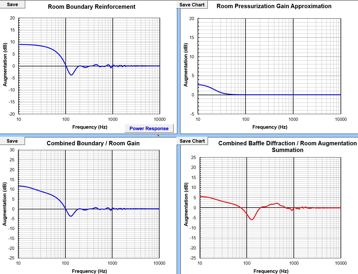

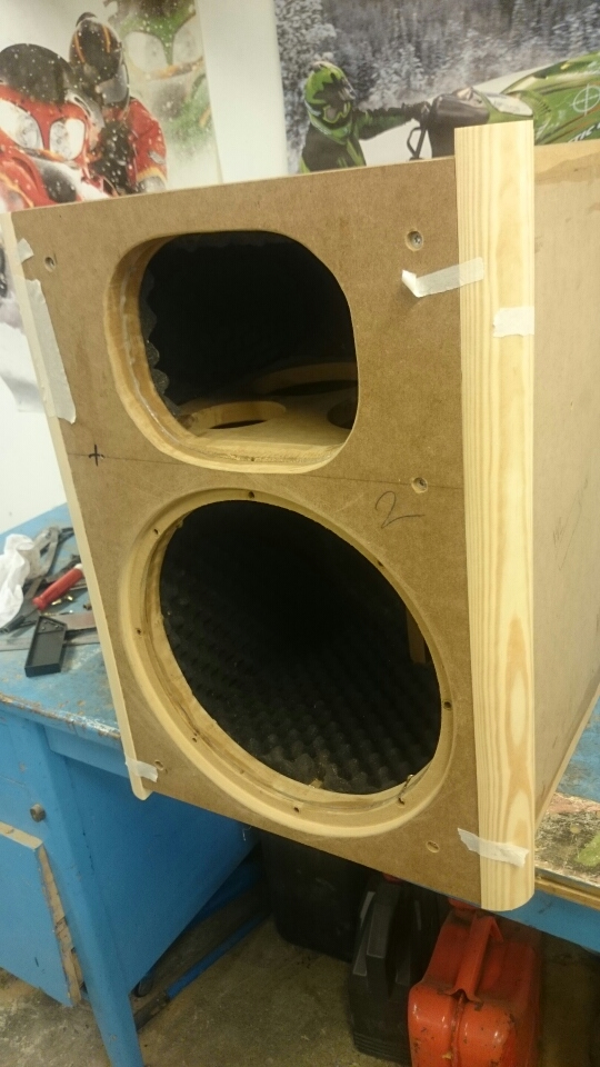

A few simple simulations of the baffle shape and room placement will give a feel for the "under 200Hz" effects. It is common to design the baffle and crossovers together to provide some control options for baffle step compensation and in-room vs. near-wall placement.
Baffle Edge Diffraction Simulator
By Jeff Bagby Version 1.20
the cabinets are 16.5" w x 21" h with 33 mm radius on the sides ,
