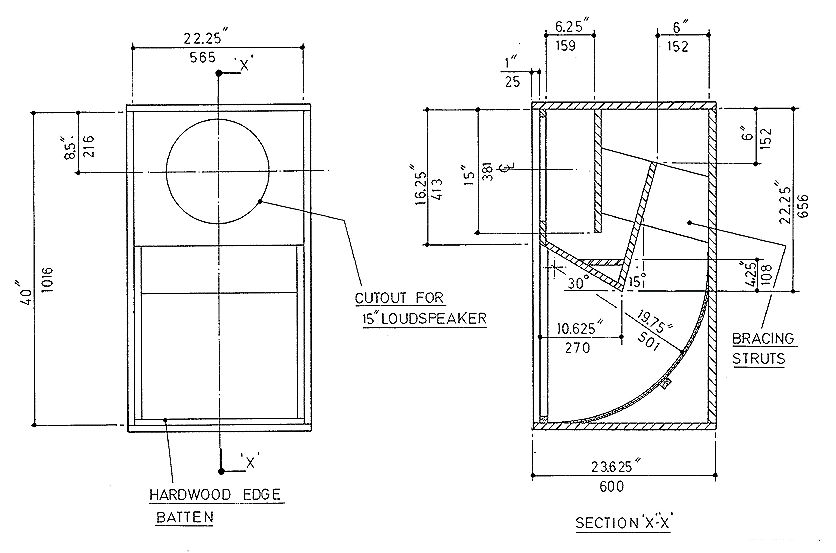

Hi !
I know there's been some talking about this but I
cannot seem to find any workable conclusions...
So my question is;
Can a J-bin / Scoop as used in PA, be made with a 12" driver ?
Off coarse it can, but will it work ?
Now I'm posting this in the Fullrange-forum, as I intend to make
a hifi-sorta scoop using the ol' Philips AD12202.
A terrific fullrange 12" although I'm a little worried of the high-ish
total Q (being somewhere in the range of 1.2 I guess)
My thoughts are as follows;
If I were to scale down the original J-bin, I'd alter the hornlength,
pushing the lower horn cut off frequency up.
But isn't it smarter to just narrow the design,
so keeping the hornlength the same ?
And if this is a way to go, how much would it be narrower ?
Maybe some of you backloaded-horn-masters can help me with
this please ? 😕

hi GM,
That's usefull information!
So I get to learn something on a sundaynight 🙂
But is a Qts of 1.2 any good for hornloading ?
what be your cabinet of choice for these 12" Philips drivers ?
Empee
Greets!
Well, it would depend on the rest of the driver specs and what the performance goals are, but as a general rule a ~0.707 Qts is the upper limit.
If the Qts is this high, then either OB or a max flat impedance TL, but the latter requires specs to calculate it.
GM

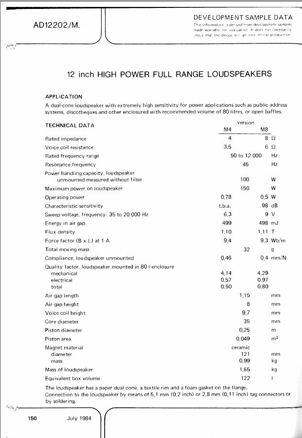

finally !
I got all specs' !
Qts is 0,8, wich is a wee bit too high for hornloading...
Would a BVR (yet another son of Chang) be a good way to go ?
Empee

When I click it, it opens full size/easily read in a new browser window.
Anyway, you're right, this driver is best suited for either OB or max flat impedance TL, so will probably sound too under-damped ('boomy') in a BVR.

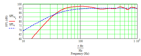

Empee said:
how would a max flat imp TL look like ?
what size am I looking at ?
thanks for your help!
Greets!
You're welcome!
Well, after looking at the specs I'm not sure how much help I can be due to the way they spec'd Qes, Qms, Qts since I don't know how to convert them to free air measurements.
For sure if I use the 80 L (presumed) sealed box measured specs, the TL will be fairly large at ~10.514 ft^3, but I assume the free air specs will be less, though I don't have a clue how much less, so FWIW (all dims i.d.):
L = 66.5"
CSA = ~324"^2 (recommend 22.875" W x 14.125" D)
zdriver = 26.56"
port = CSA at bottom
stuffing density = 0.6 lbs/ft^3 simmed
