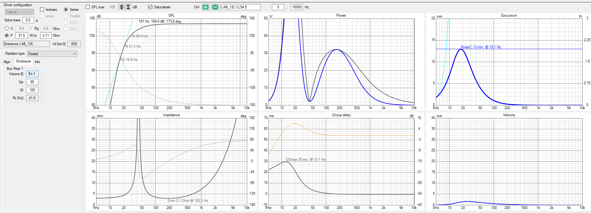

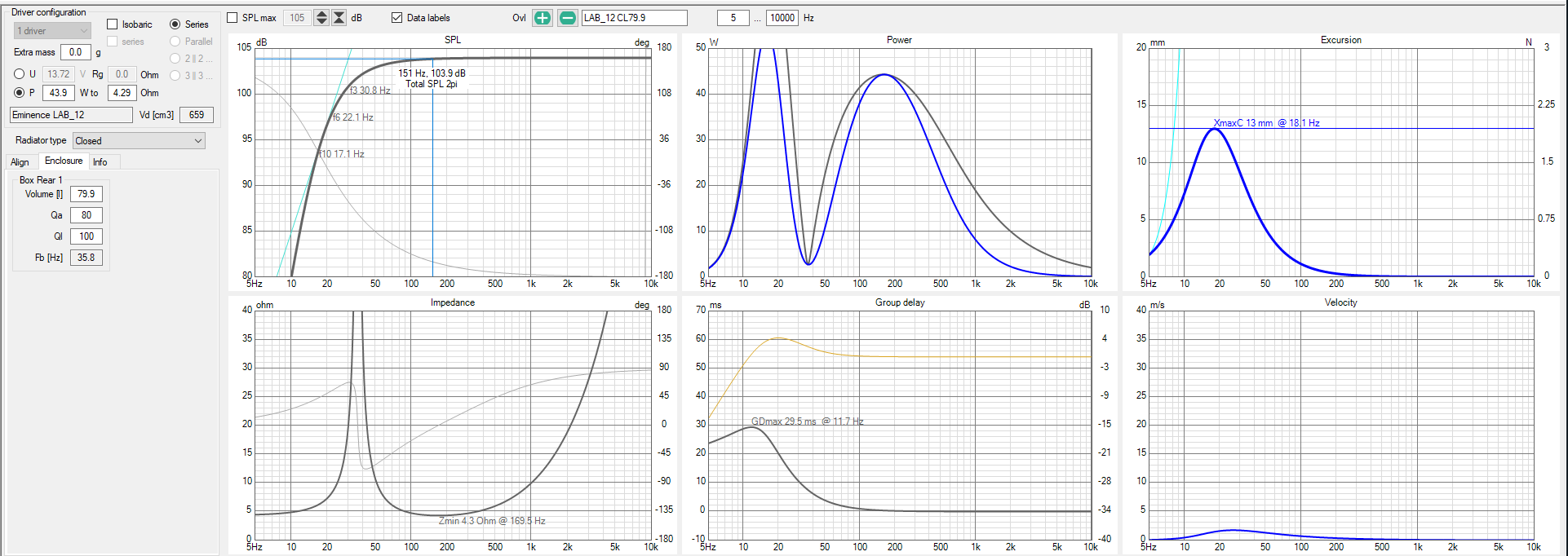

GM, it still is if one looks around. The 12C has lower Mms (136 vs 146 g) , lower BL (13.36 vs 15), lower Re (3.11 vs 4.29) and lower Qms (11.7 vs 13.32). Bl^2/Re is still higher on the "C" (57.39 vs 52.45). Still, I would not know out of this if one would sound better than the other.
As the discussion above using a LT starting from a Qtc=0.6, the internal volume for the "C" would be 54L vs 80 for the non "C".
Here are the sims for both with the LT and showing the point in which I would run our of Xmax. I am using a HP @20hz.
