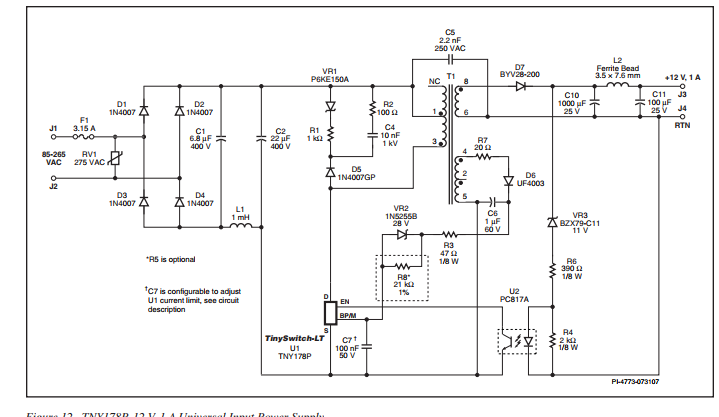

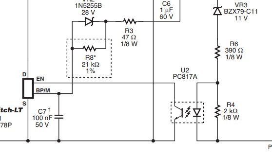

that is a chopper type pwm circuit,
output voltage controled by feedback from an opto isolator,
so my guess is lowering the value of the opto diode shunt resistor will increase output voltage, perhaps at 20k ten turn bourns trimpot can be used here to vary the voltage,
go slow.....stay safe.....

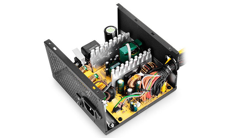

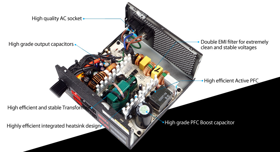

quick question, what is the brand and make of atx psu you are using?
can you post the label of that psu so we can get more info?
It's a Deepcool DA700. I can't find the same model even on their website... I can't see which mosfets is uses (it's a tight squeeze with 4 devices on one sink, and 5 on the other facing inwards. And there are 3 4 pin DIP chips which I can't read the writing (it's tiny).
