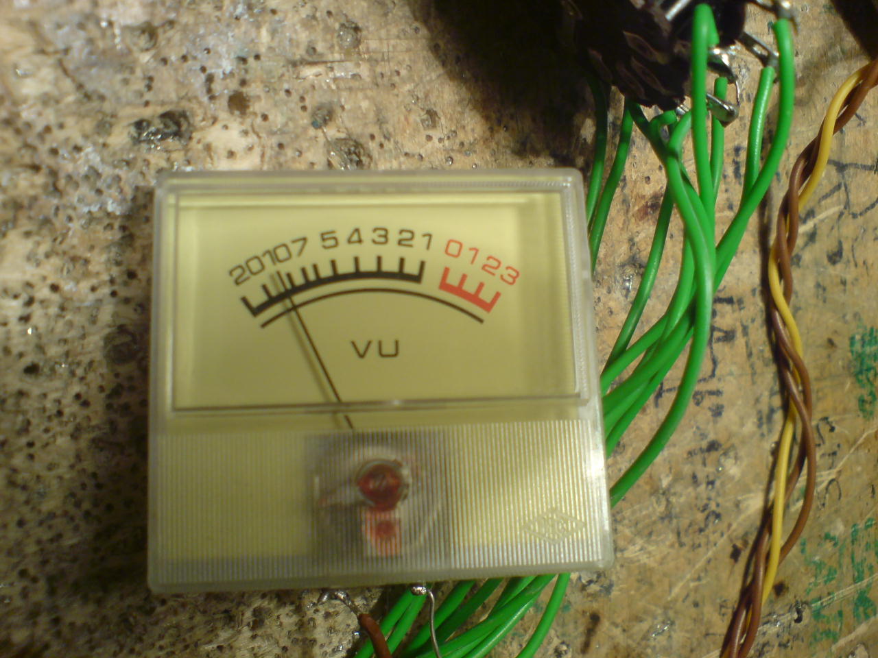

I hope that you see that links with oep transformers....those are good enough in comparison to mains transformer....Because I tried I won't recommend you to go with mains transformer because it will give you dark ,,muddy,, sound. About the ratio. Original unit has 1:1 ratio but slight increase of gain by help of transformer is very useful ,,on the road,, so something like 1:1.5 will be almost ideal. Of course 1:2 is o.k. too. But this step up is some sort of tweak. If you want original 1176 than simple go with 1:1, 600:600 transformer. There is everything prepared for oep on that site which I posted link....and those boards has one big advantage. There is corrected ground loop which was present on gyraf's boards and which cause hummmm.
You asked for some other compressor. I clone ureiLA4a opto and I's nice. More smooth sounding somehow less sharp,aggressive. And it is little easier to use because it has threshold knob...If you need any info about it I can tell you a lot of things......but there is again output transformer🙂
This VU shows gr on prototype....
