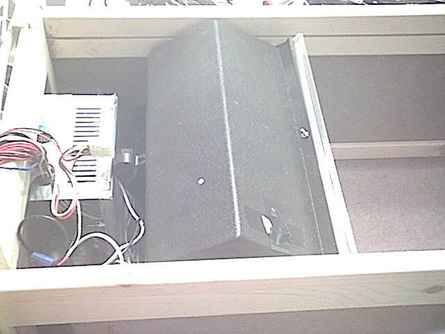

i have posted
pics before from the result with 2 LOA's in one enclosure with simple aluminum foil glued against photoboard that was shaped as a cone...
I was trying to explain (2 years ago) that the results where truly very good.
no one took my route when some of the guys failed...
but that was then, this is now, the fxl bulb will give even more light than the LOA and as I can see this result does not need any real reflector , maybe a crude rear shield but that's all.
The front lens will be the most crucial thing to think about but as usual I want to come up with ideas that have not been milked out!!!!!
J-P
here is oneof the pics I saved from 2 years ago , IKEA enclosure and 2 LOA's

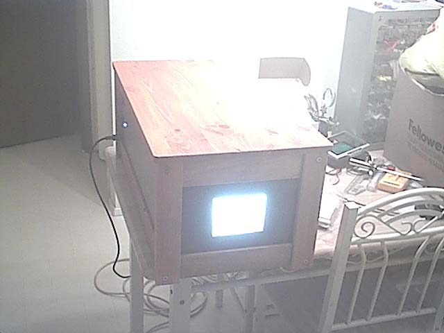

and maybe a less clear
picture , the result o a first power up , the light coming out of the enclosure was so overpowering that, when I took a picture, the room looked dark and the brightness coming out of the projector lens was overpowering the other lights in the room
J-P
