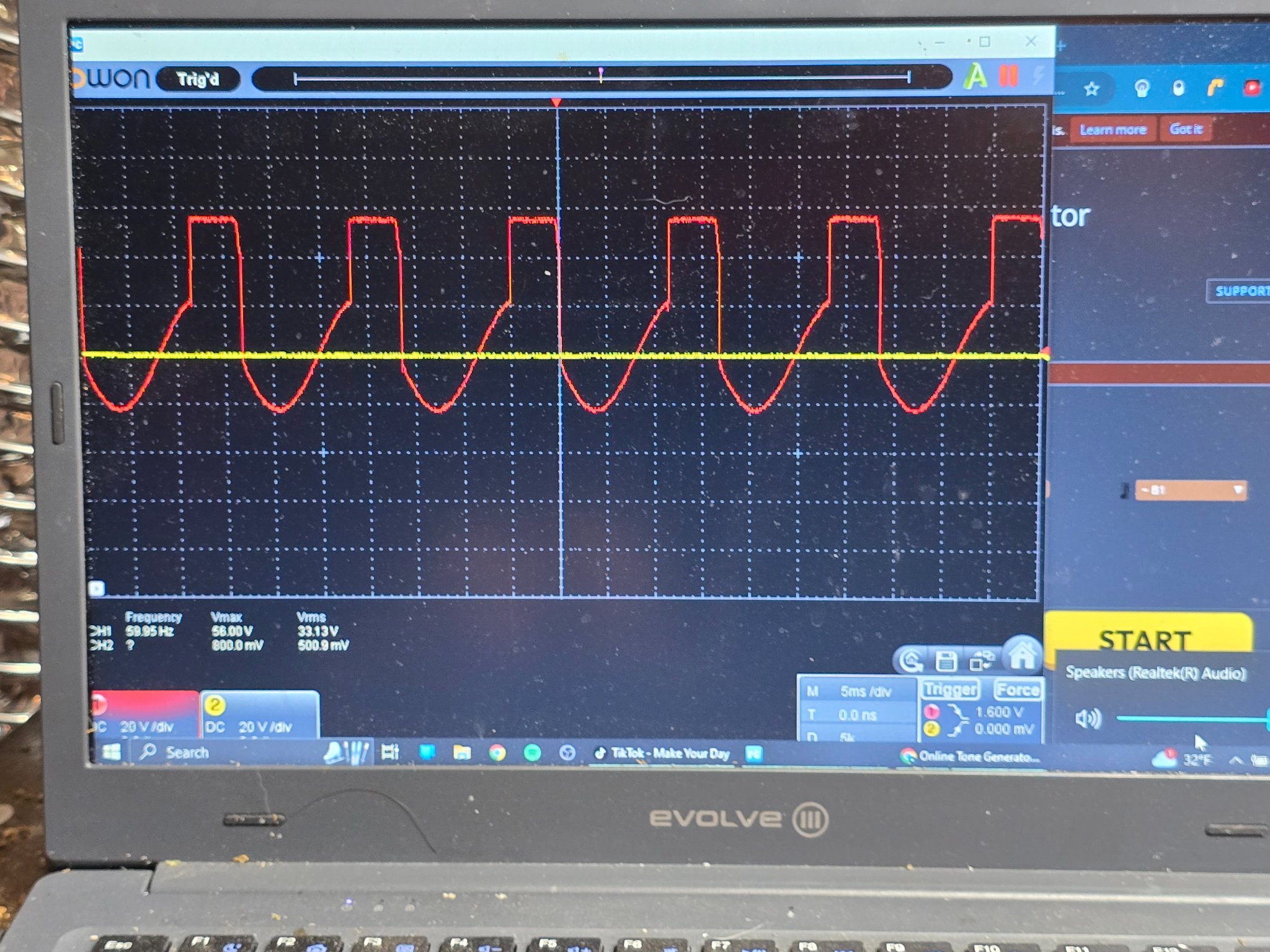

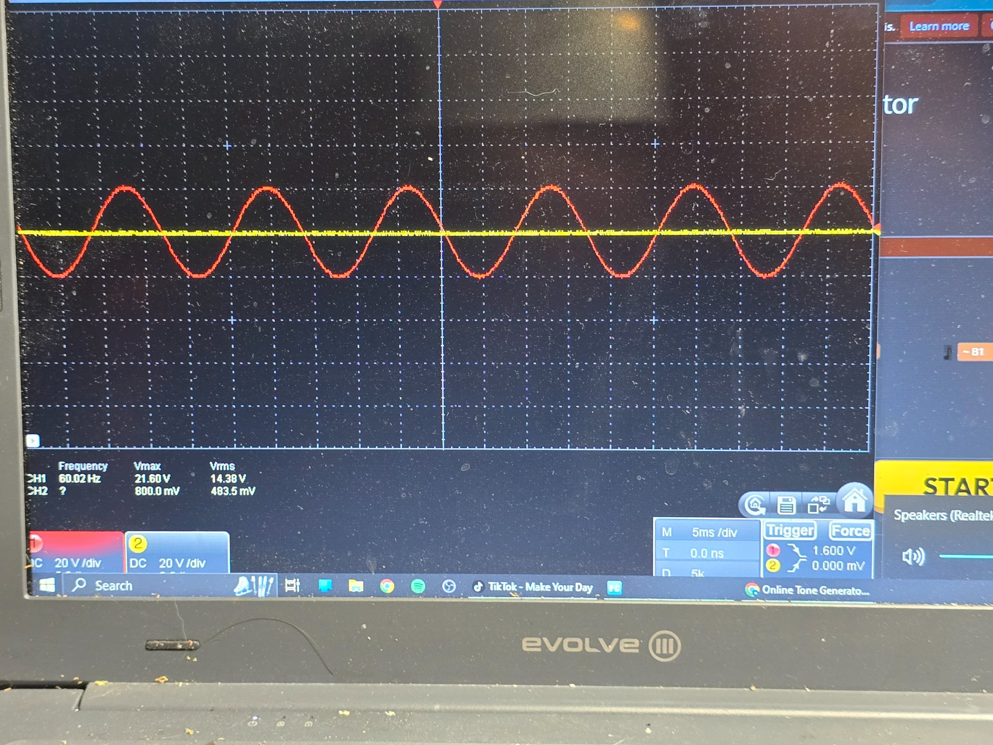

1100A2 distortion issue
Yes

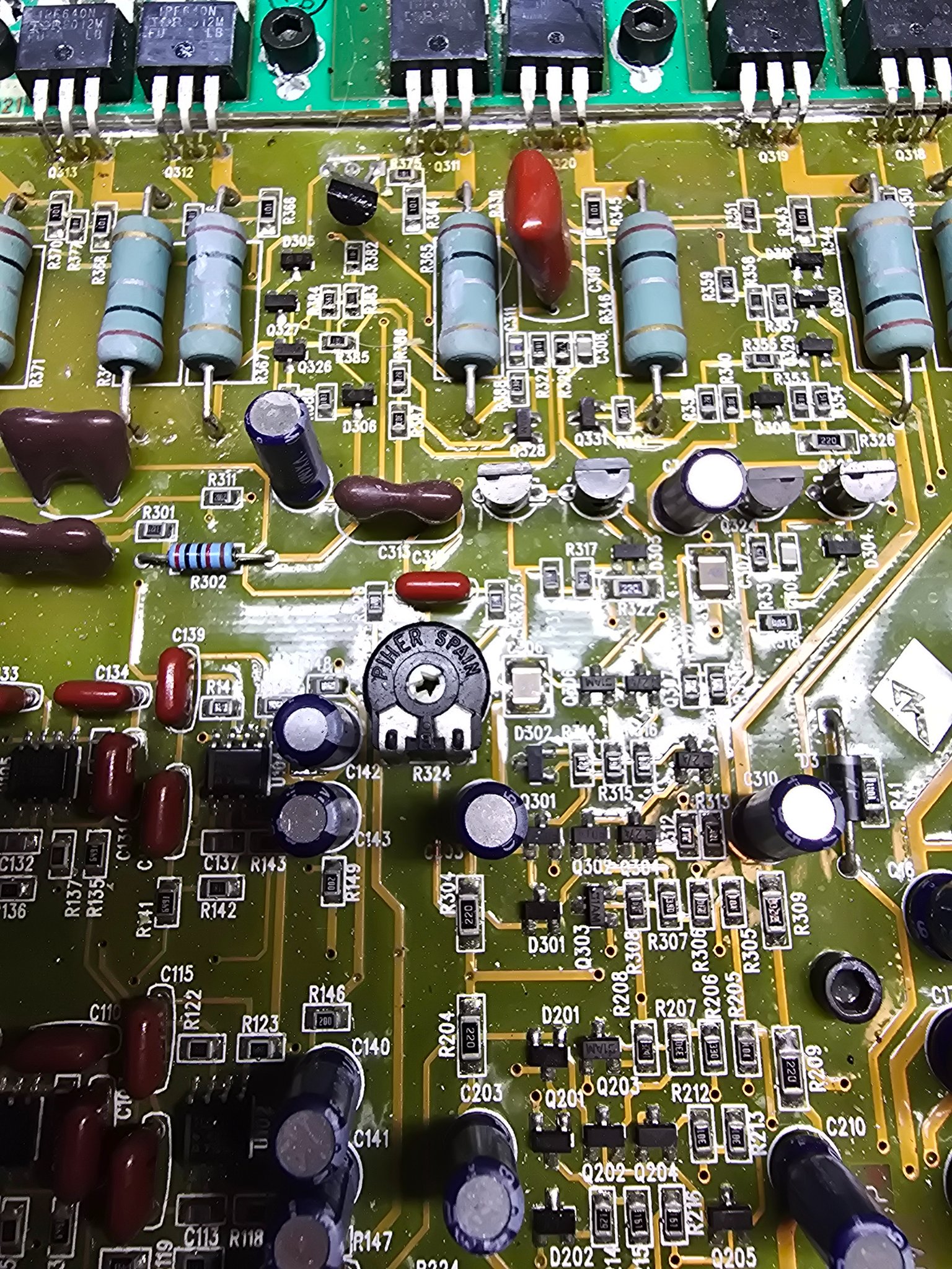

I have 100 clicks on my vol adjustment. The difference between the 1st and the 2nd pic is 1 click.
The resistors is it. Honestly it could've been doing it before and I just didn't notice.
Pretty sure they are .1 ohms

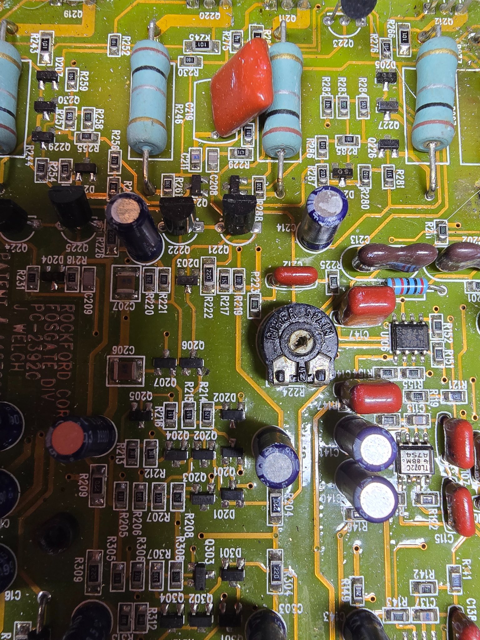

Is the voltage measured directly across all of the following, essentially the same?
R206, 207 and 208
compared to
R306, 307 and 308?
When the output is distorted, do you have clean audio on the capacitors, C201 and C304? I know I asked previously but the distortion was significantly different, then.
To clarify, the only thing you did between the time that you had the original type of distortion to the time you started having the second type of distortion was change the 0.1 ohm resistors. Is that correct?
Did you confirm that you have all of the voltages listed on the diagram are present and if not exactly what's given on the diagram (they're never exact) that they are very near what's present on the other channel.
