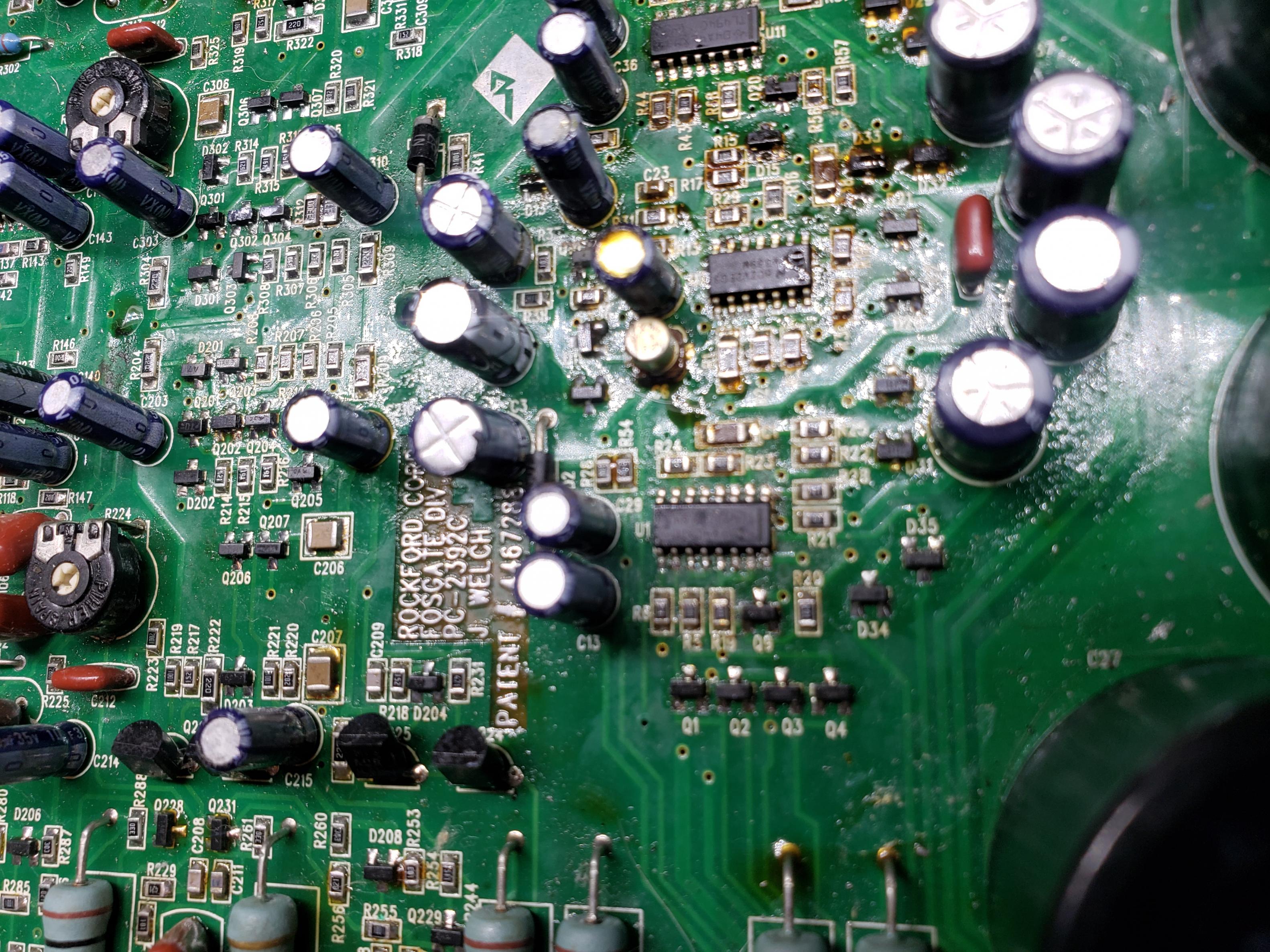

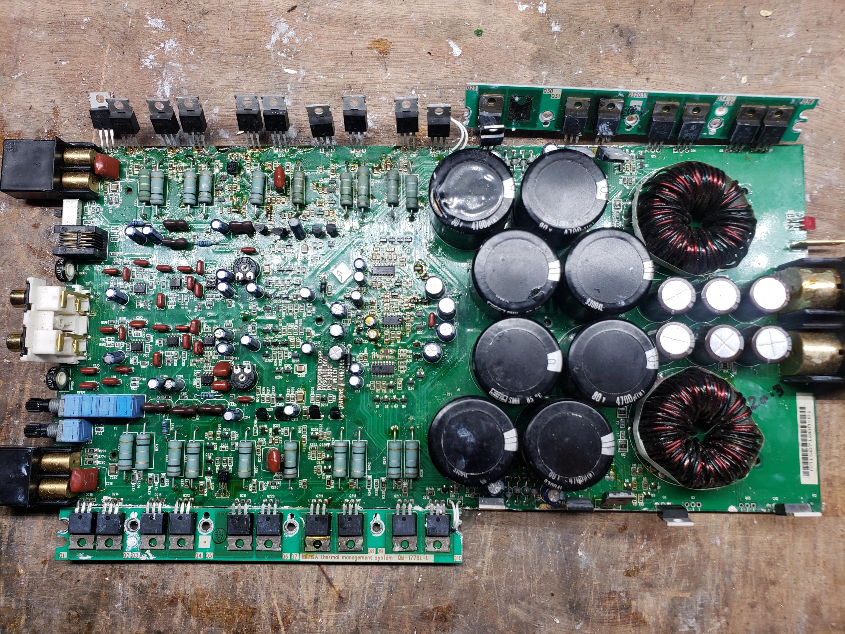

The regulation doesn't deem to be working on the higher voltage supply.
To disable the over-current protection, lift Dx05 and Dx07 for each channel.
Check the signal marked L_core and R_core.
Does the distortion remain in all crossover modes?
